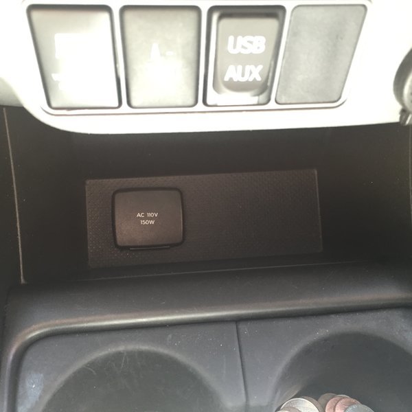

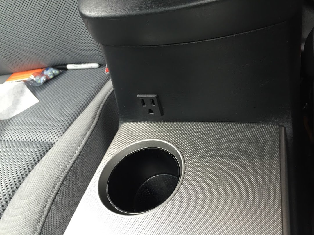

  4. Jul 4, 2016 at 2:25 PM
    #464
    justchil
    justchil Well-Known Member
    Nov 11, 2013
    #116339
    238
    Andy
    WV
    13 AC TRD OR
    I meant to put it on the opposite side of the cup holder but it works great.

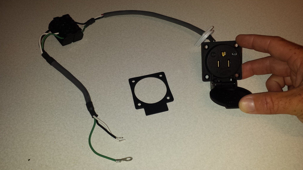

    Where did you get the pigtail / plug for this socket?
  15. Aug 13, 2016 at 4:02 PM
    #475
    pruchai
    pruchai KAMA3
    May 8, 2014
    #129398
    1,788
    Igor
    San Diego, CA
    '14 TRD TX Baja
    Not enough...
    As far as i remember it got this one.
    http://oemfordparts.jackyjones.com/oe-ford/3u2z14s411jbb
    Honestly, it will be much cheaper not to use one at all. you can just get those flat connector things and then put some hot glue or epoxy to keep them from ever coming off

    Well this seems perfect for this mod with closing lid and all. Took it out of a new gate operator. If i get another i will post it here.
