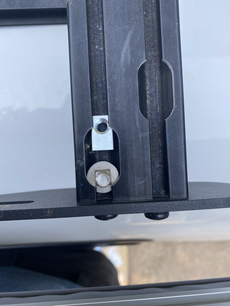

  7. Oct 4, 2021 at 2:15 PM
    #47
    Ranger 1/75
    Ranger 1/75 Active Member
    Jul 24, 2017
    #224907
    43
    Sierra Nevadas
    2017 White Tacoma TRD Offroad
    I ordered the t nuts from the ebay link in this listing (M6x1.0 Roll-In T-Nut w/Ball Spring). They are slightly wider than the opening of the slot, which is a little less than 5/16". The t nuts are about 3/8th" wide, where as the bolts that came with my prinsu hardware are about 9/16" wide. Was I sent the wrong size, or is this what you guys got? I feel a lot less confident about ratchet strapping stuff down to my roof rack using these, than I do with the original hardware. I'm no engineer, but I can tell by looking, that these t nuts will take less force rip through the slot than something that had more overlap. Do they make a wider t nut for the aluminum extrusion Prinsu uses? Do you guys trust these 3/8" wide t nuts?
