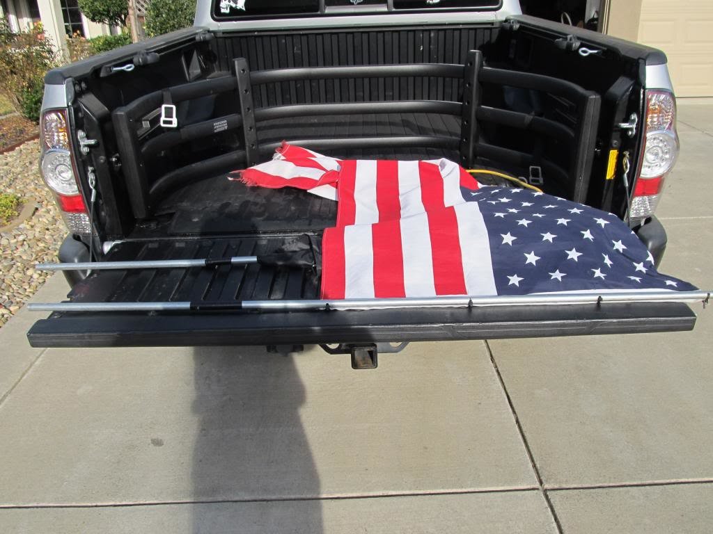

    To start off I went to Home Cheapo and got myself 10' of 1/4" galvanized pipe and cut it in half to make my poles

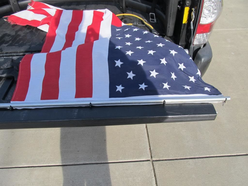

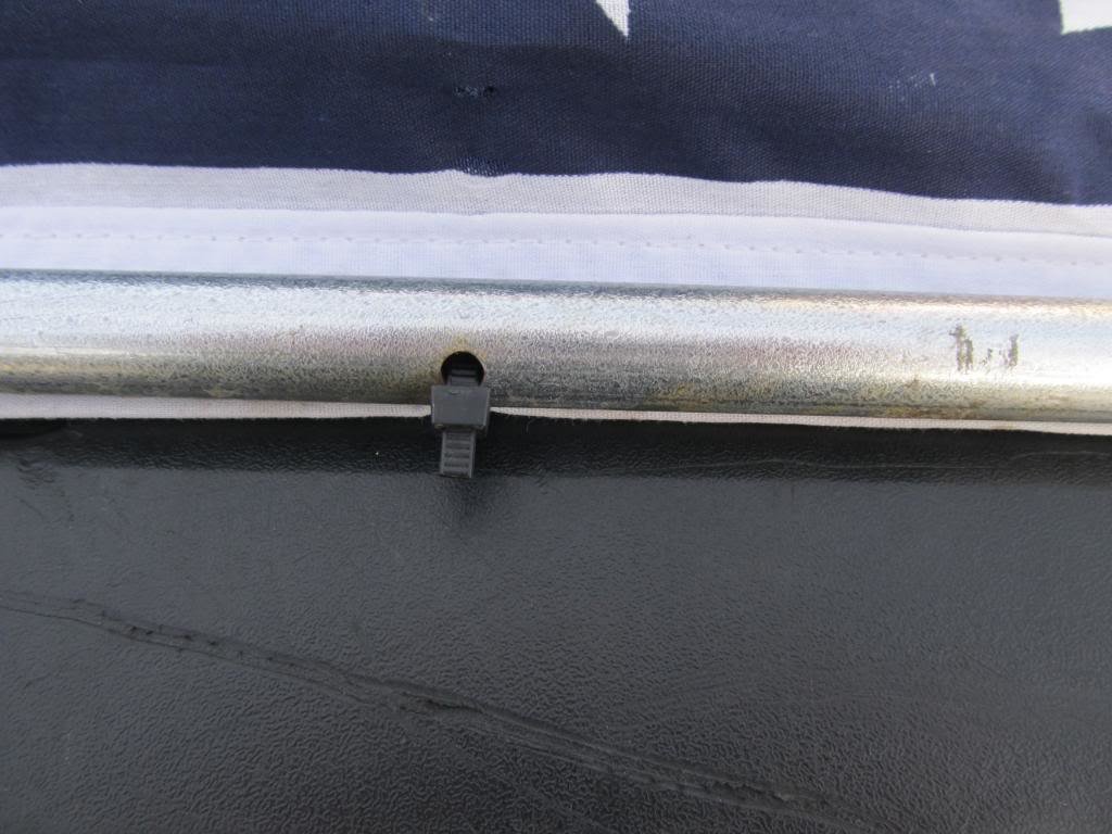

    The next step I did was to drill 4 holes in each pipe and zip-tie my flags to the poles

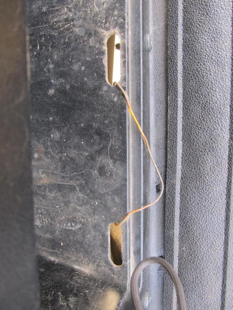

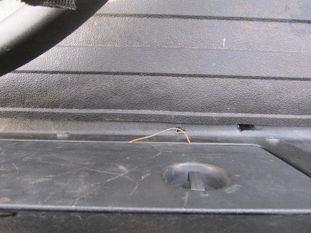

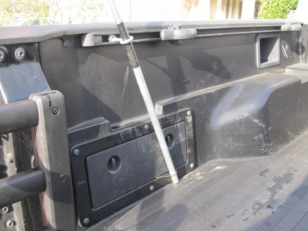

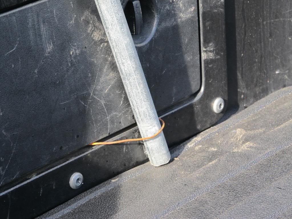

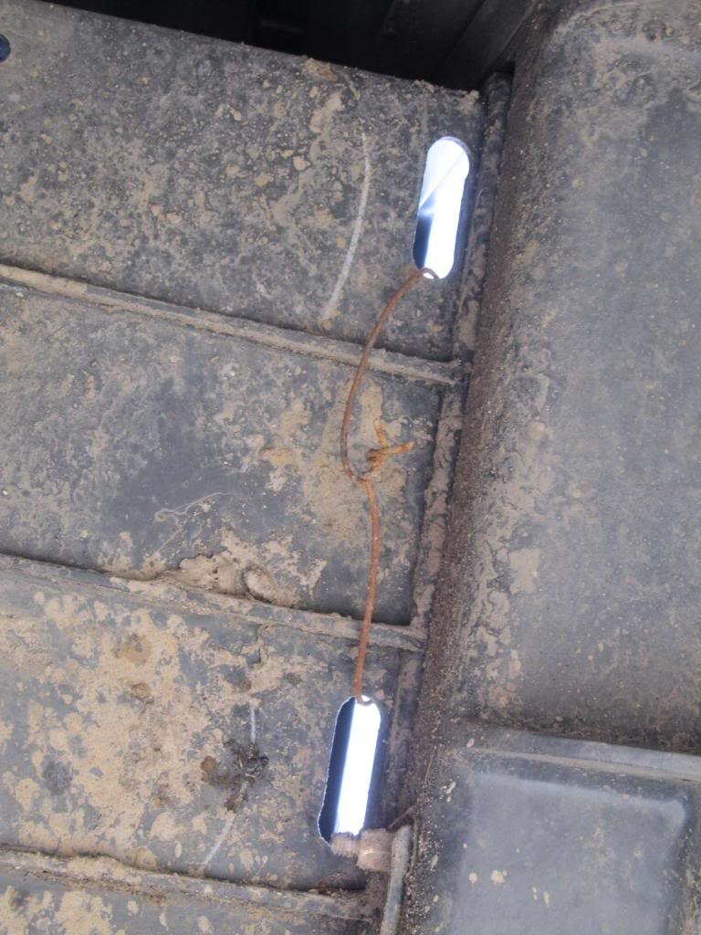

    Then I used some metal wire which I had laying around the garage and made a loop through the holes for the little storage bins at the rear of the truck (I don't use them anyway) and then put the cover back into the slot [​IMG]
    underneath the truck [​IMG]
    with the cover back on [​IMG]

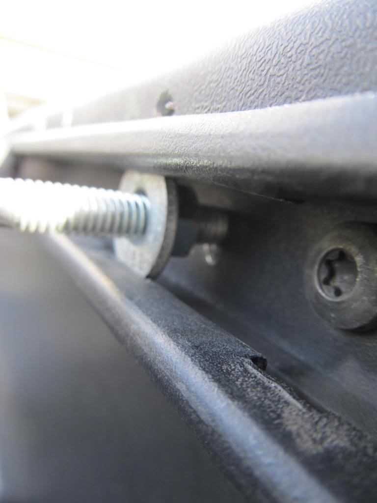

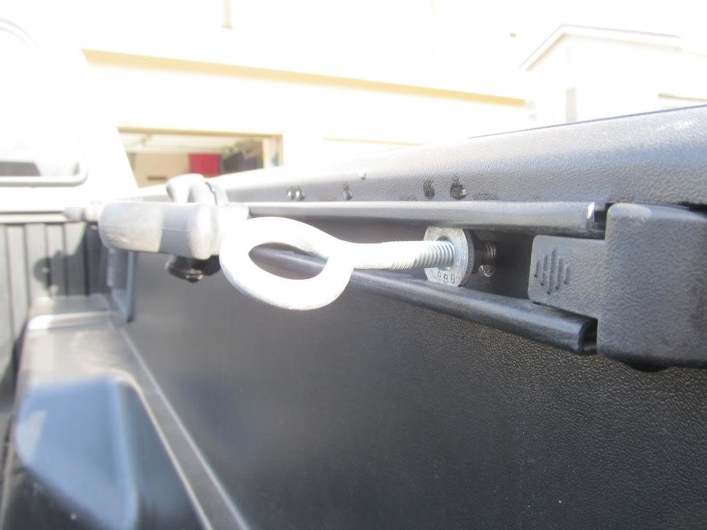

    I then bought some 1/2" eyelets and some nuts and washers. I inserted these into the bed rails like this[​IMG]
    and shoved a flathead between the nut and bedrail to tighten them down

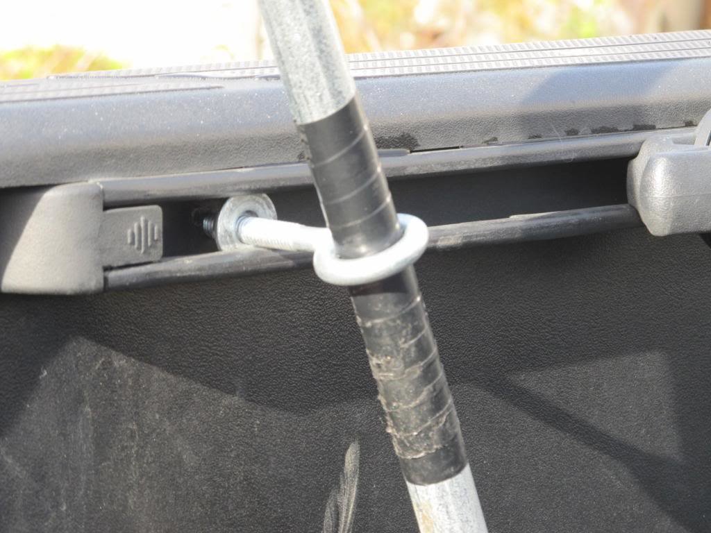

    then just put in the flags and away you go :D
    [​IMG] [​IMG] [​IMG] the tape in on the pole to stop the rattling because it was driving me crazy

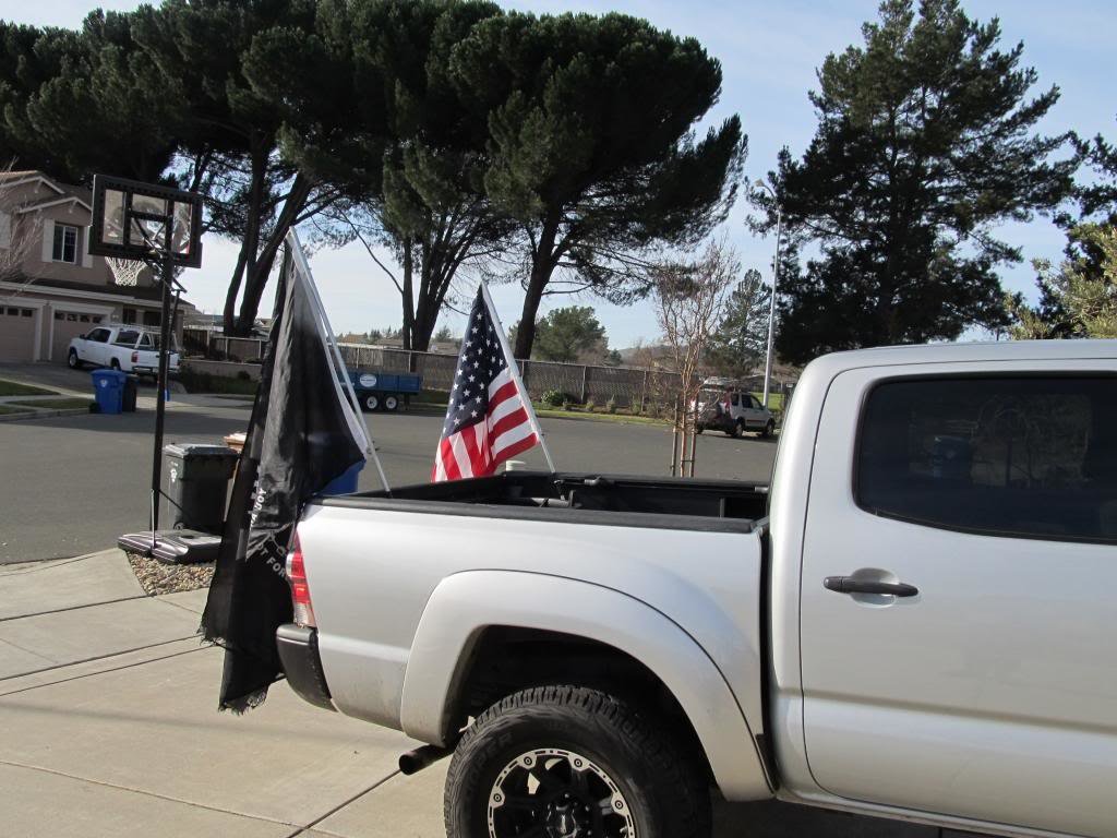

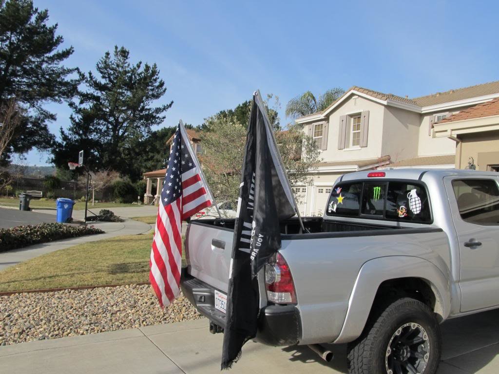

    and a heads up, these mounts hold great at freeway speeds however your flags will end up looking like this (pic) so I would not recommend using them for extended periods of time on the freeway.
