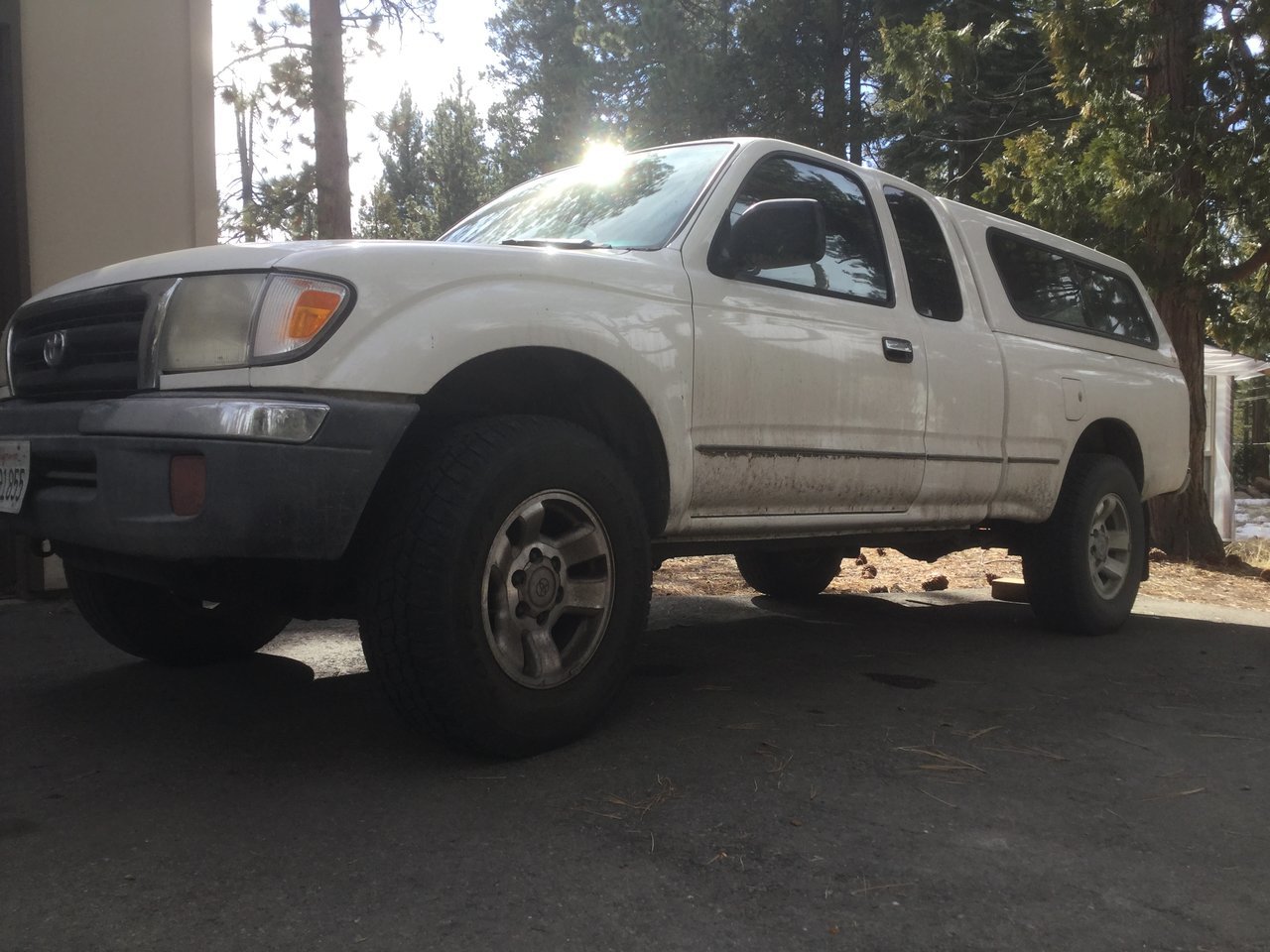

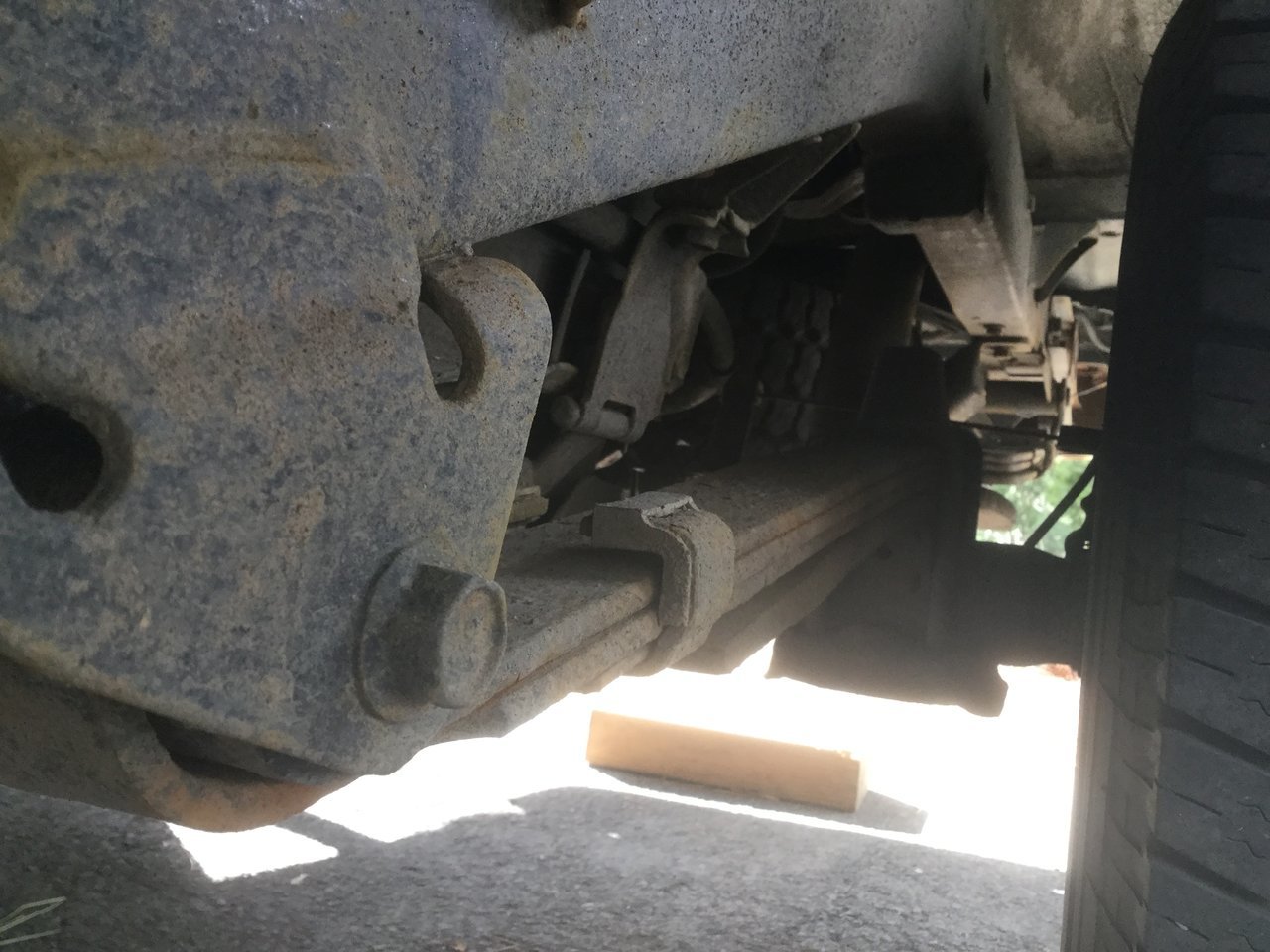

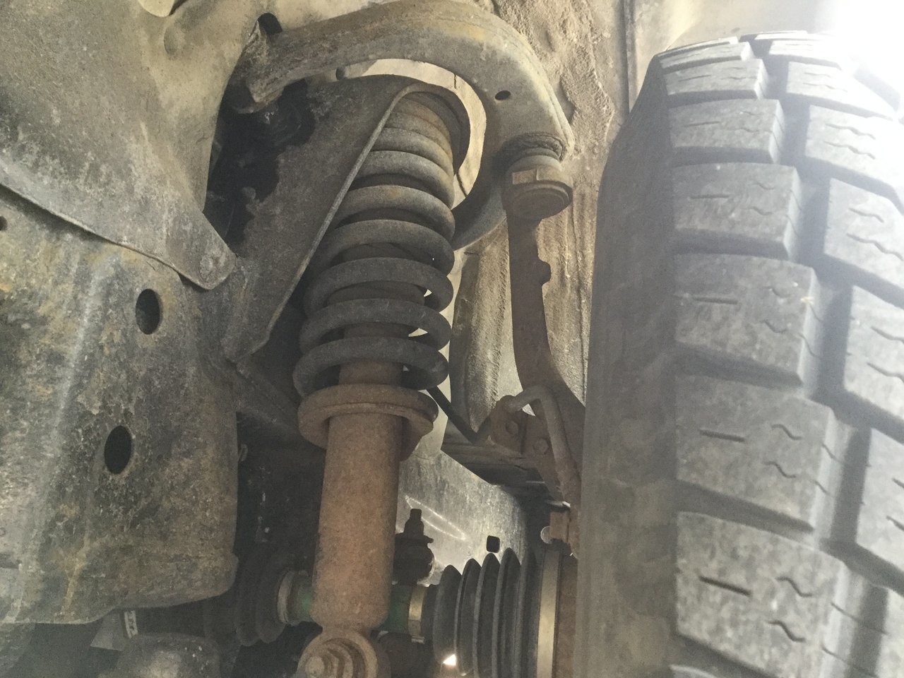

    EB79B4DB-6D6F-4C1E-B270-3CA2338B025C.jpg 929B0C9A-75F4-4B26-A39F-0419964CA900.jpg Hey guys I need your advice, I am closer to save enough money to buy parts and tools needed to upgrade my worn stock suspension on my 1st gen, that suffers of a severe parkinson...
    I will get Bilsteins and ome leafs.
    ...will try to take off the small leaf (that is on top of the overload),
    ... get a 2 degree wedge or shim under the new leaf pack to later space the center bearing to sit lower,
    ...match the rear bilsteins to the leafsprings high to the 3rd notch (1.75 one)
    ...replace pins Ubolts and bushings (any brands and specs advice are welcome here)
    ...fix new raking by installing front bilsteins on the second notch (0.85 one)
    All suggestions will be considered, mostly the ones that will save me time and headache$$$
    as you can see, the ride now is so bad,that the bed is getting out of center the shell is hard to sit in place (leaks)
    I want to do this myself, because in the process i want to be able to reach places with POR15, that normally are impossible!
    thanks in advance
