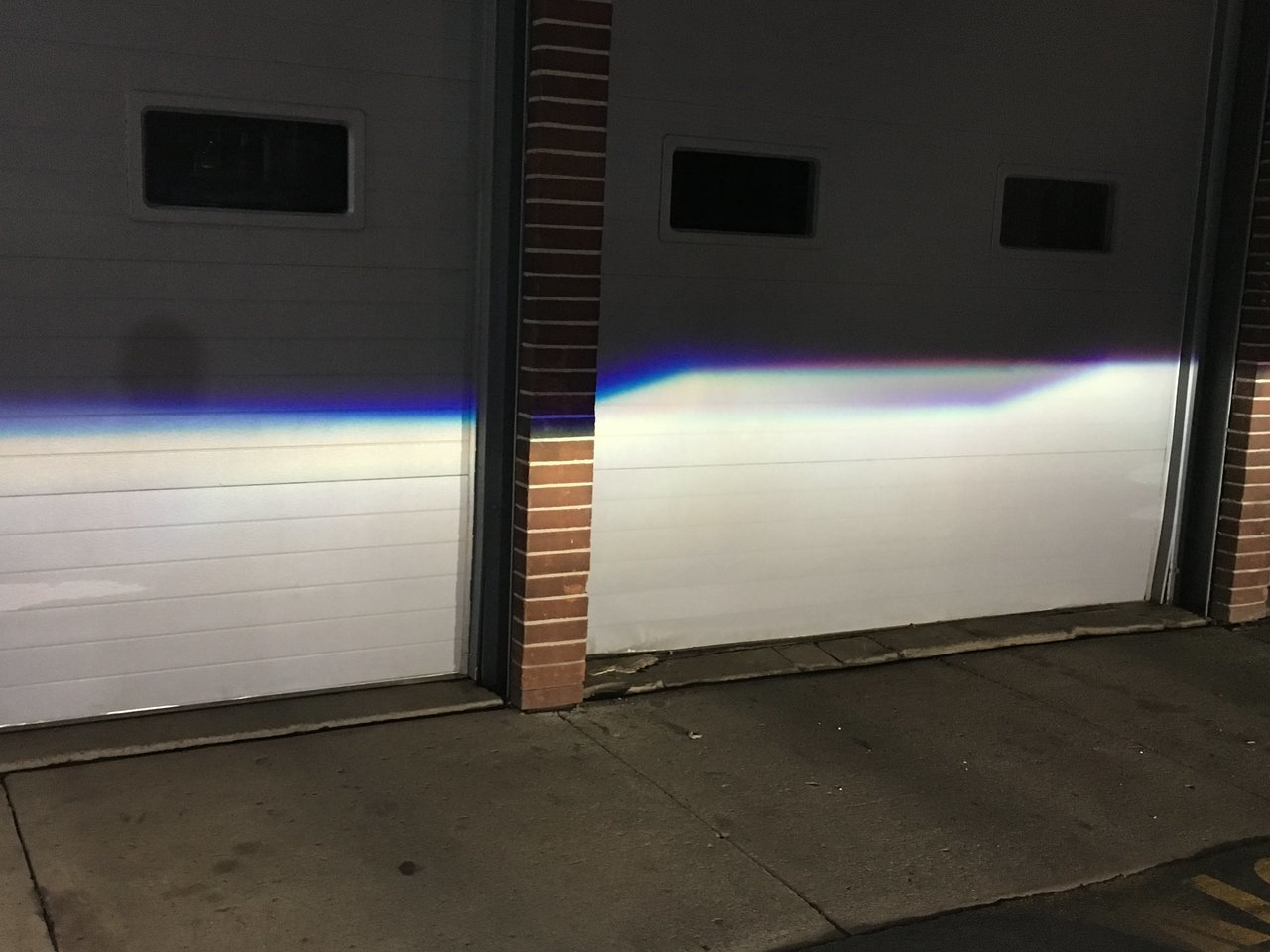

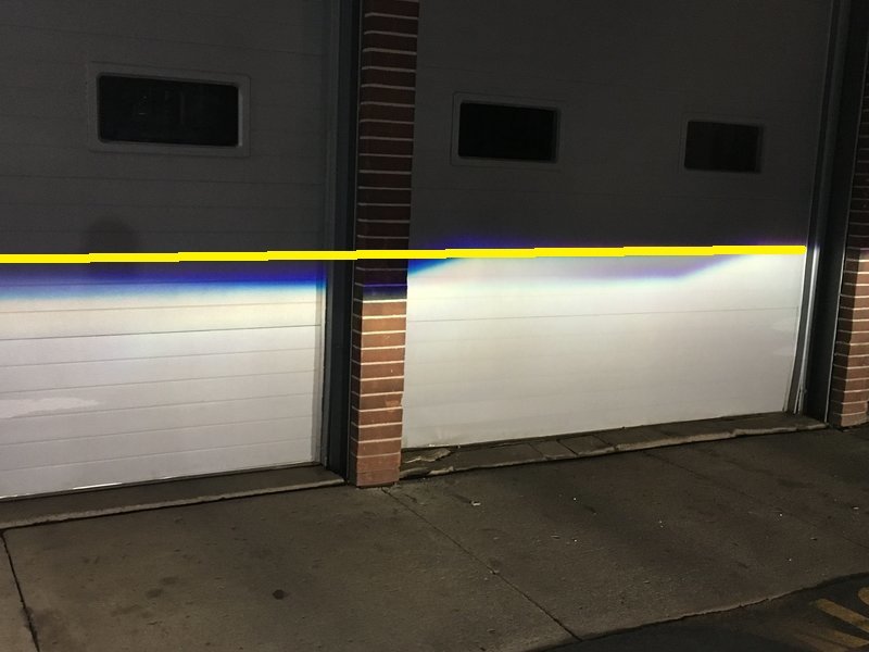

    Is that just one headlight then? Because the right is a full slat higher than the left.

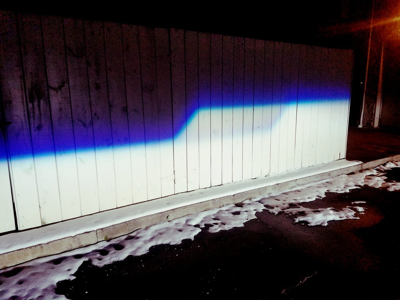

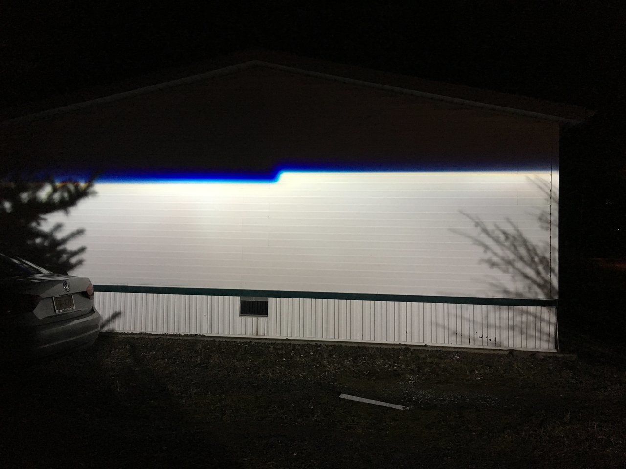

    A projector cutoff produces a slant in the beam pattern which is designed to allow light to project further in your lane but not in the oncoming traffic lane.
    This is one single projector.
    This is how it is supposed to look when you properly aim two projectors.

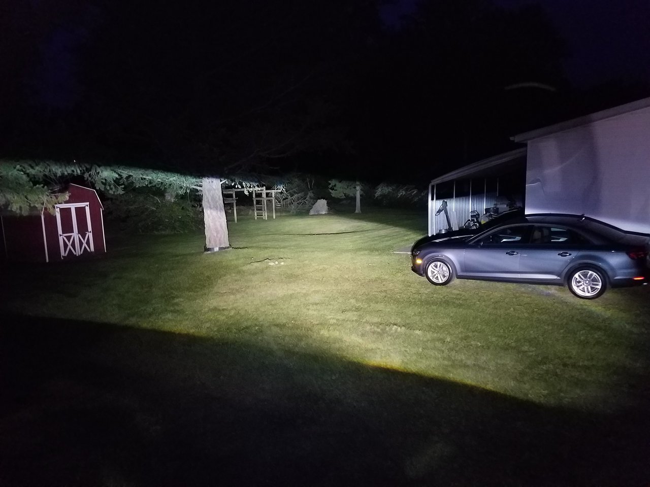

    The ones I posted a picture of are from my HID projector retrofits which have a much sharper cutoff line with no light let out above the cutoff and much higher output. They don't look the same as the factory halogens.
