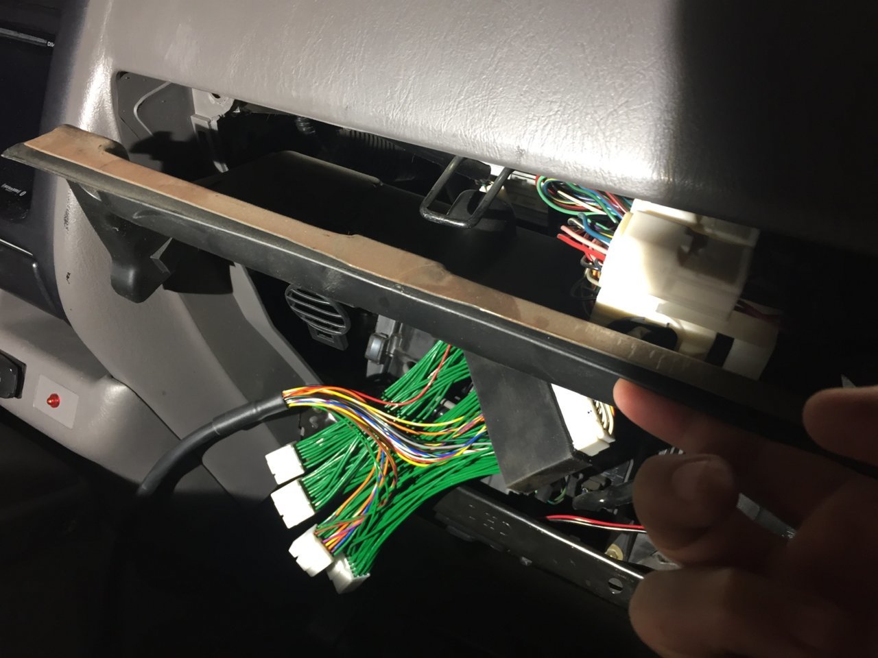

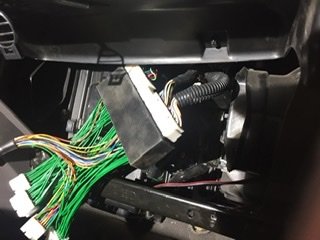

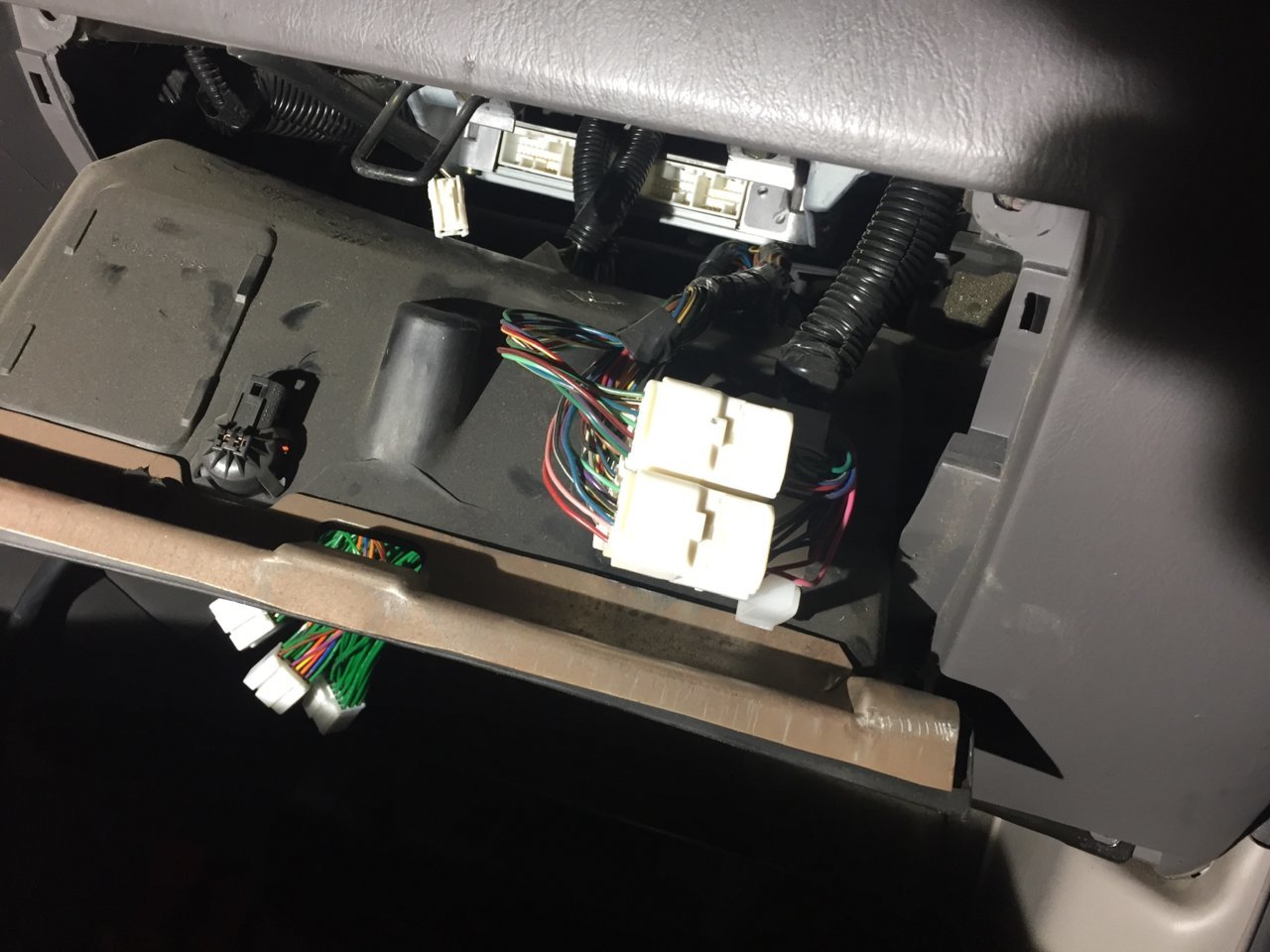

    98B55A78-B891-494E-B295-49B91C6A3864.jpg 79C7C1EA-9D0C-4590-83BE-05C7CC625DEF.jpg DCB643AD-24BC-4E14-B4FB-AE81F1283338.jpg The most common place to install the FIC is in the glove box
    if you use the boom sling harness it is bulky and has about 6” leads. I spent about two hours trying to find a way to push the harness back behind the glovebox shroud and was unsuccessful. Therefore I had to remove the tube that goes from one side of the area behind the glove box to the passenger side vent and placed the Boom sling harness there. Therefore I had to remove the tube that goes from one side of the area behind the glove box to the passenger side vent and placed the boom sling harness there. Once you get behind the glove box you’ll see what I’m talking about. The biggest problem is that the stock wires off the truck are too short
    This is why I highly suggest buying the extension from Boomslang
