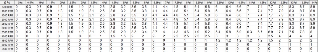

    If you’re not getting any ping I’ll send you the base map. That will just add some safety net and will be plenty good. It’s what SplitSec and URD ship with.

    I’ll just have to send a screen shot. You should be able to fill in min and max and auto-populate the map. Easy.

    if you're not pinging you don't need to have more than this. this is just for safety.

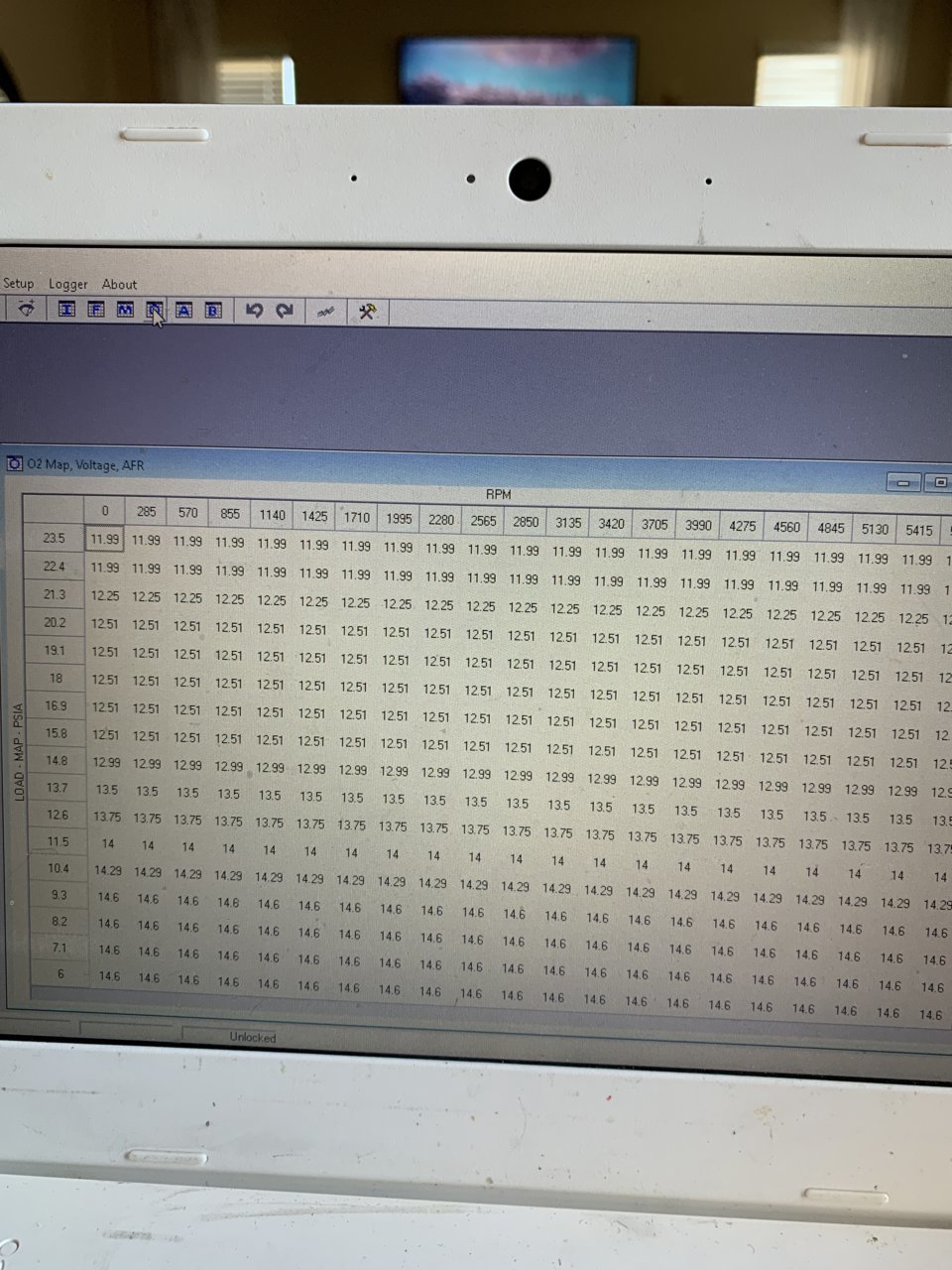

    Looks like the FIC and ECU were confused about who was in control. I changed my AFR and fuel trims so the FIC didn’t s in control %100 of the time be changing my non-boost to 14.6 with .8 fuel trim and it worked!

    You won’t notice any difference. Technically pulling timing looses power. But you’re pulling so little it won’t matter.
    You don’t have to pull any timing at all. Like I said. It’s more for safety of the motor. If you’re confident you’re not getting ping then it’s up to you.
