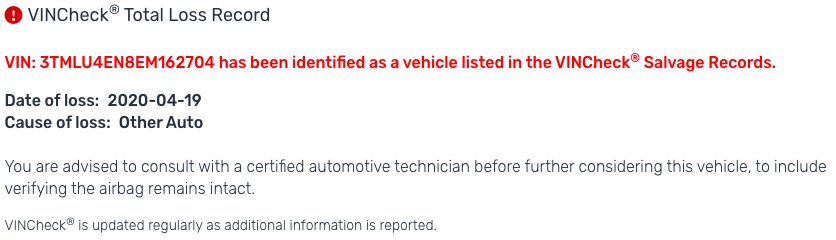

    Nevermind about this truck… The used car salesperson lied about the title being clean.
