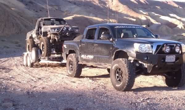

    as already mentioned the Dakar springs will work great as plenty of people have them and report great results in running them.
    another good alternative to consider is the All Pro Heavy Duty Expedition springs. i currently have those spings installed on my taco and i can say is they ride great in all situations, loaded or unloaded. i ofton tow my rockcrawler with my taco and having these springs made my taco pretty much level when towing. when i had my old springs (All Pro 3" lift Standard Springs) i was sagging like a low rider and the ride sucked bad.
    here's a recent pic of my rockcrawler loaded up to my taco with the expedition springs..

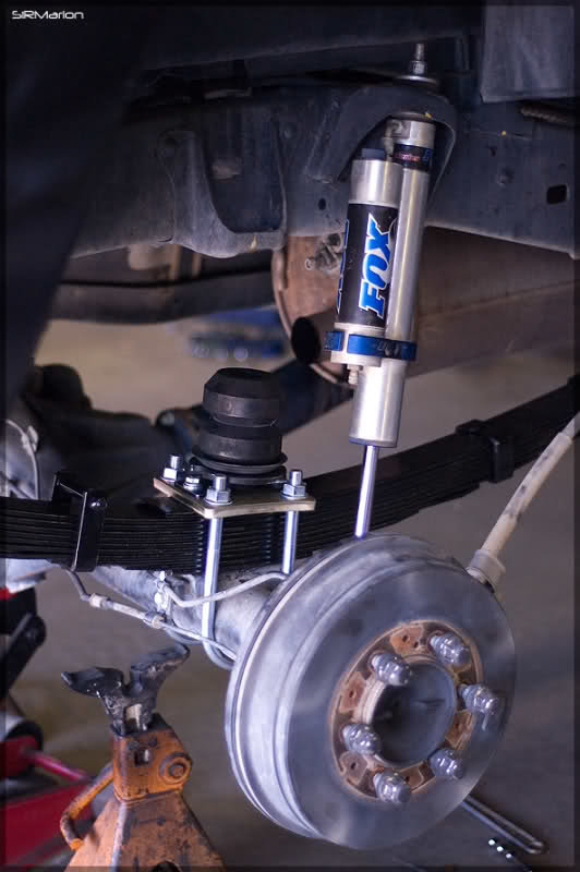

    i would like to aslo add. you should look into an aftermarket bumstop such as Timbrens. they are superb when having heavy loads. takes the harshness out of the big bumps. i have em and they will make a great combo with whatever aftermarket leaf springs you choose..
    here they are when i first installed on my taco a few years ago. and to this day still looking good with no tears, scuffs, or any other signs of wear and tear..
