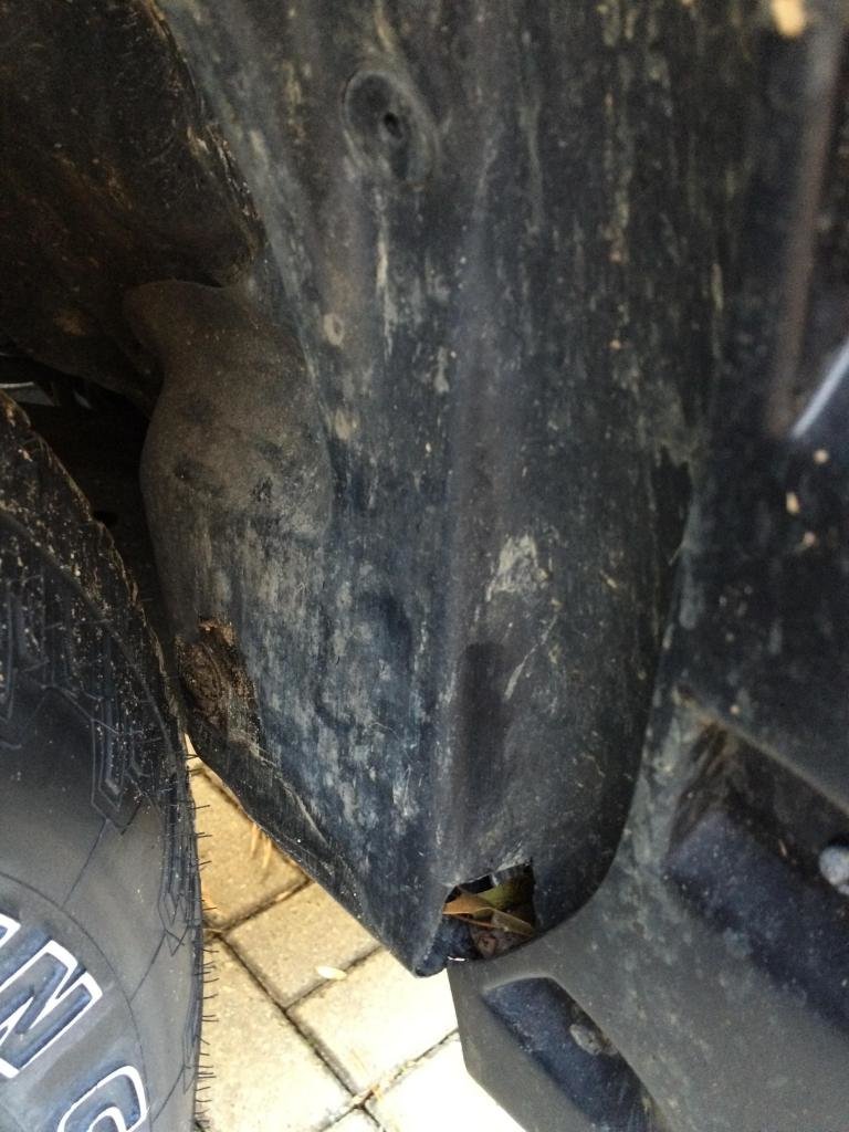

    So the black box is at the back of the wheel well and is covered by plastic so it just looks like random plastic that juts out:

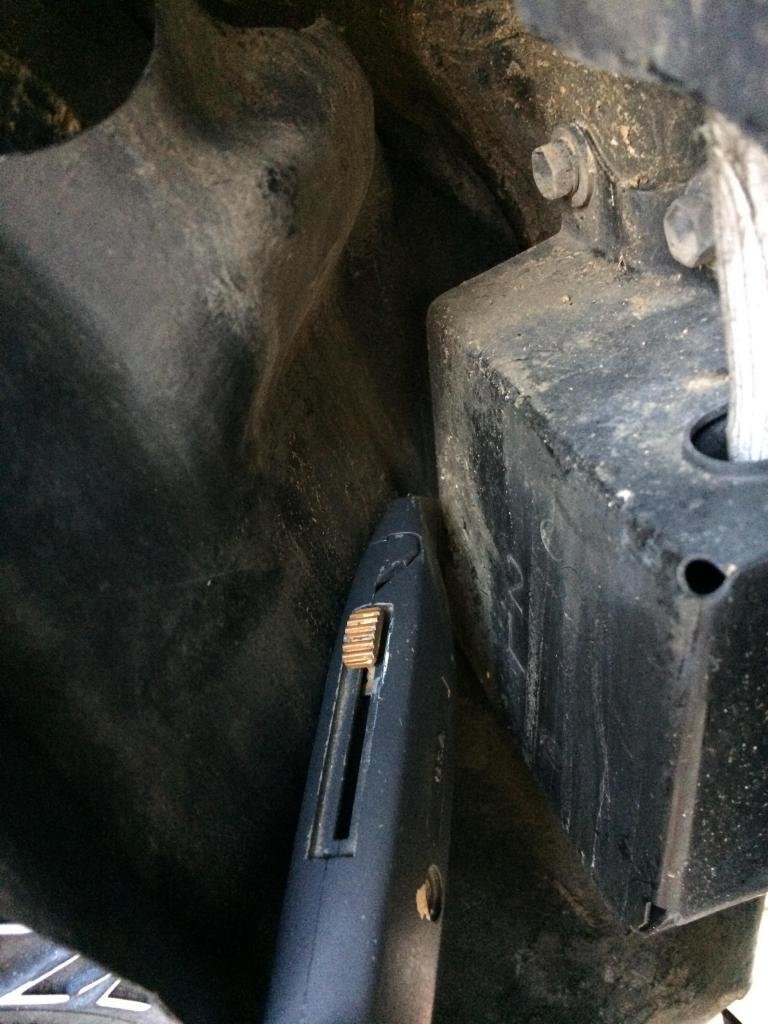

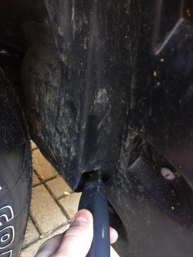

    What you wanna do is cut that plastic off with a sharp knife or scissors (I used a box cutter) all the way around like so:

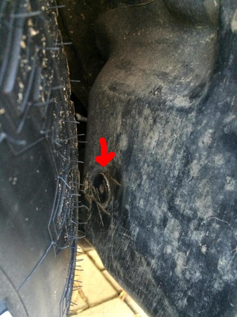

    You will notice the plastic is being held on by a button looking piece shown in the image below:

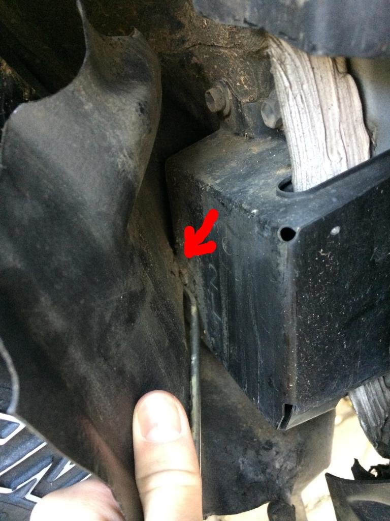

    To remove this you can simply cut it off by pulling back the plastic and cutting it from the inside like so:

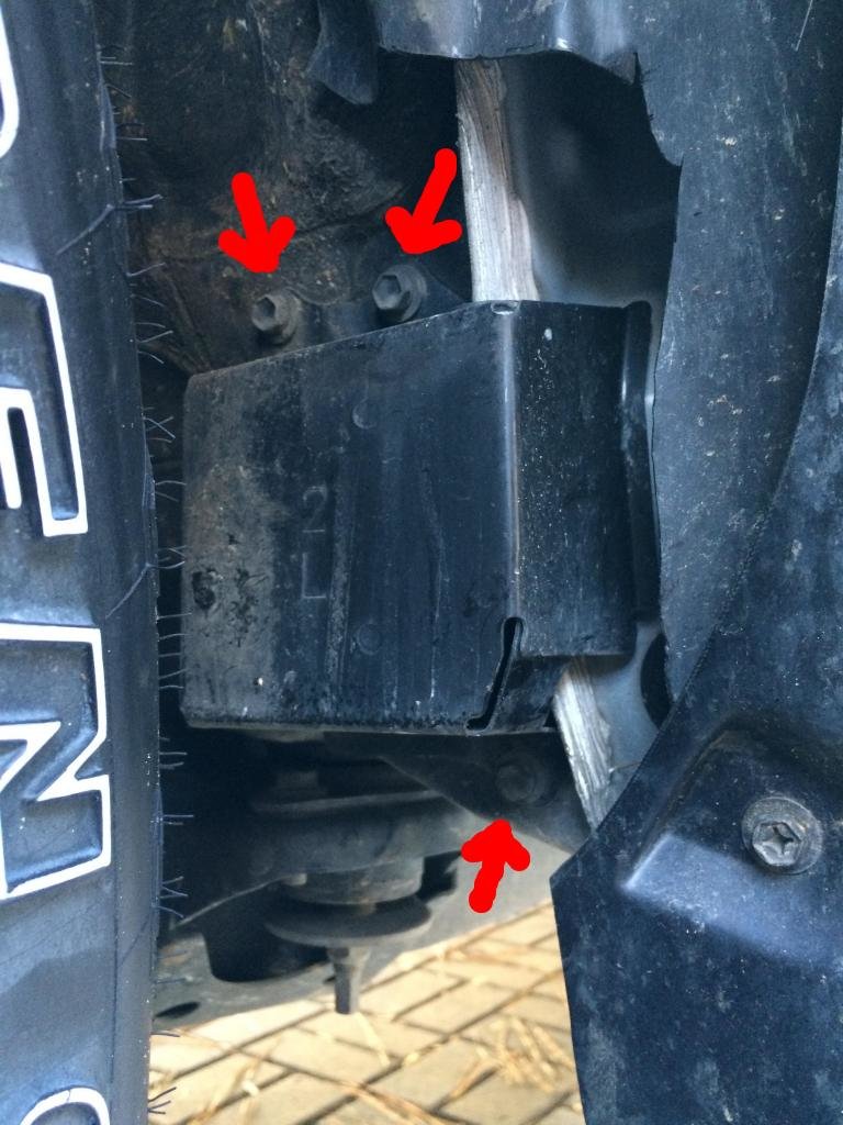

    Now that the plastic is all gone you just have to take off the three bolts shown below with a 10mm socket wrench.
    After you do that to both sides, you're good to go!
