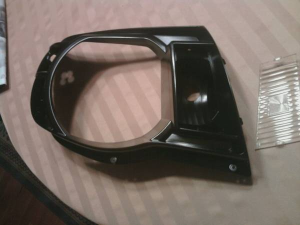

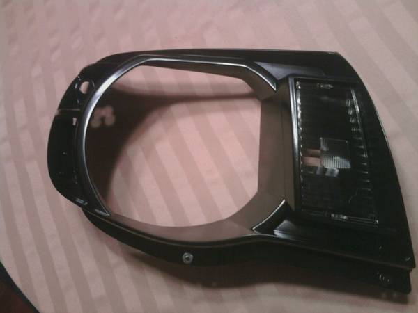

    im in the process of doing this but should i keep the turn signal reflector or no? cant really tell in the pics but in person they look really different and im not sure which one i like
    edit: this mod was actually really easy SO FAR, im hoping the sealing part is just as easy

    Any masking is optional. I didn't mask anything off when I painted mind (I did mine white).

    Mine is slightly duller than stock and it would be a little more so with black I'd imagine. The good thing is the bulb is yellow so you can definitely see the turn signal. I sort of did mine by accident and thought about it after the fact :eek: It would be safer if it was taped off, but functionally it is still effective even if you paint right over the turn signal reflectors.

    I wish I had done a little more homework and found a clear reflector for the sides on mine! The tinted one will look great with the black bezel. I know what you mean about the smell, I started mine when my girlfriend went out for a few hours and when she came back "What the hell is that smell and why did you turn our kitchen into a garage! Is that your headlights in the oven?!?! What the hell are you doing??" The reaction was pretty comical to say the least :D

    i left mine in, just preferred the "all black look" vs having an orange bulb showing but its totally up to you

    I put my reflectors and turn signal lenses back in.
