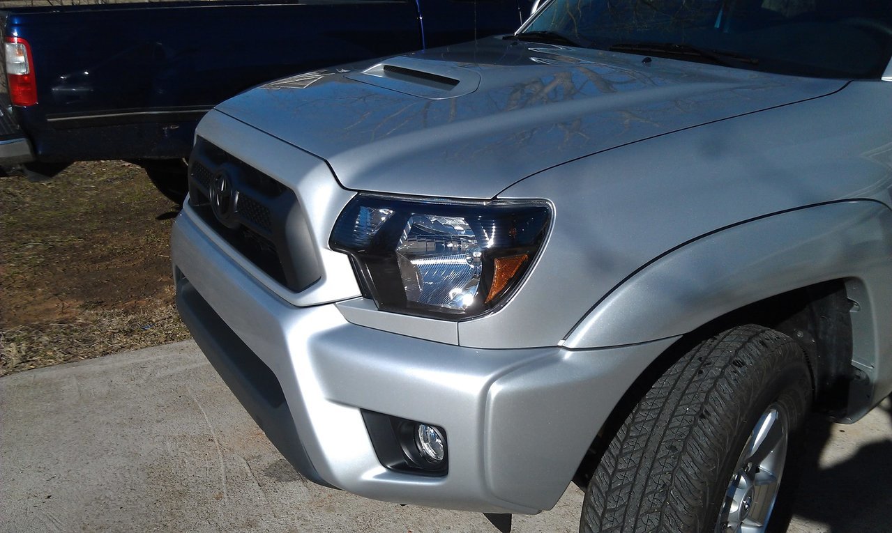

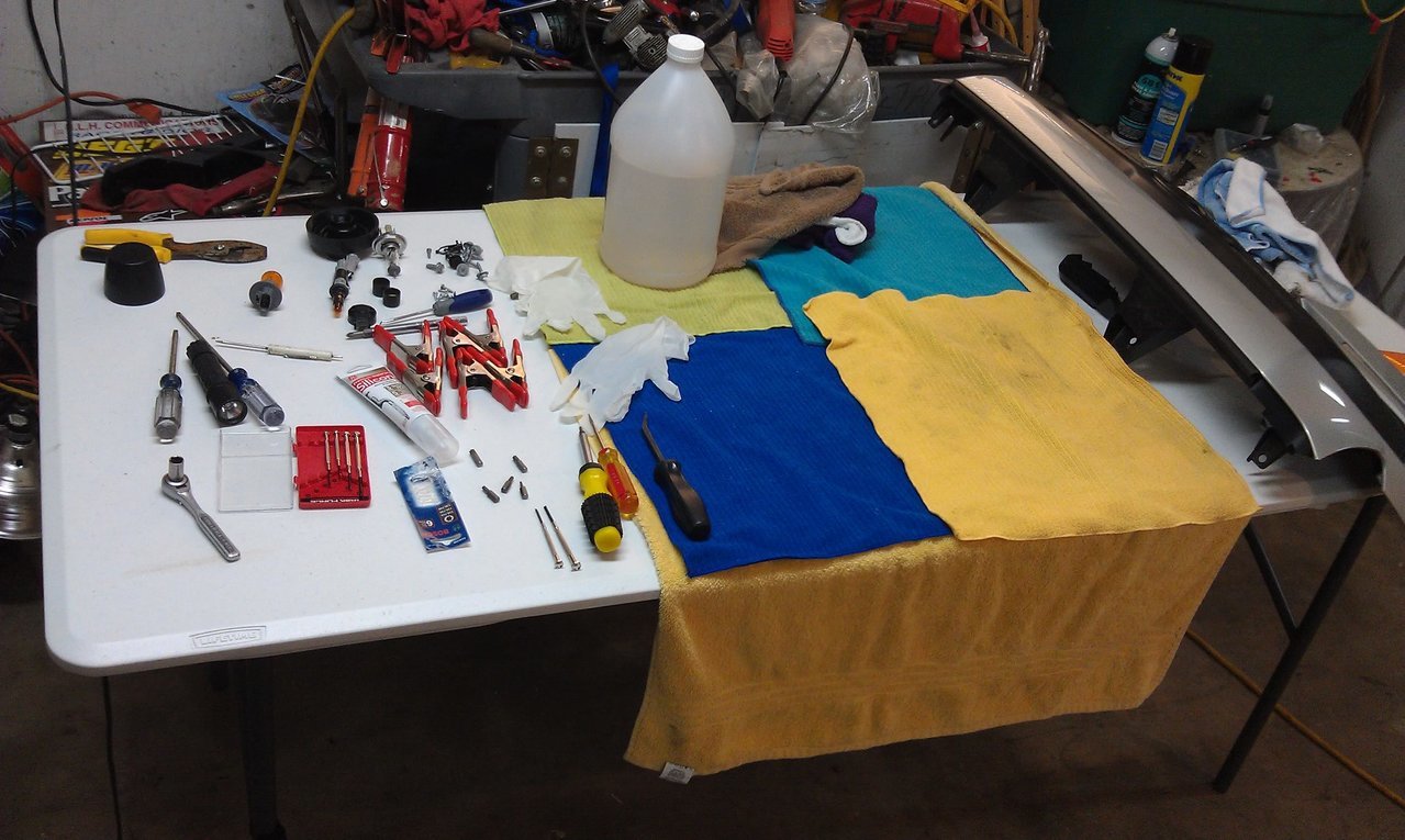

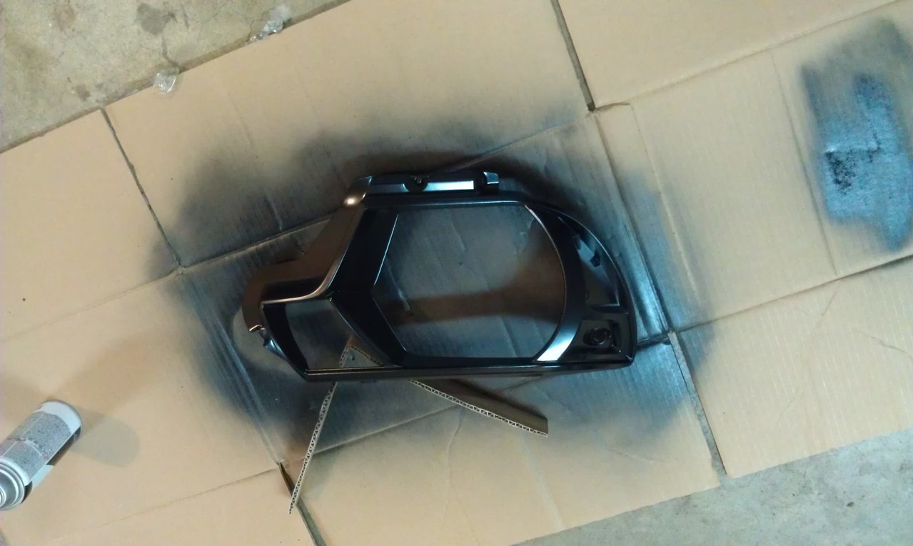

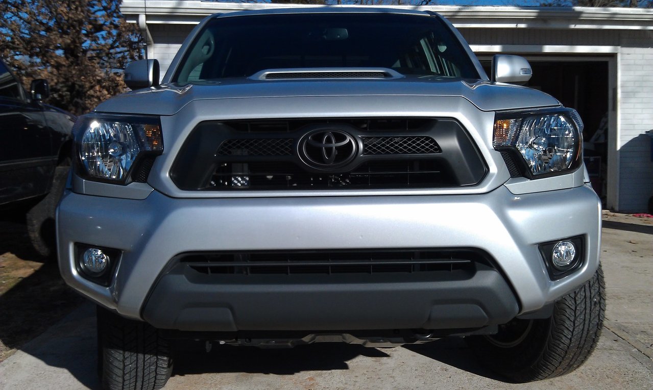

    I printed out your directions Tuesday and that night when i went home i did it.
    i started around 530pm and finished around 11pm. the hardest part was actually putting my headlight in the oven!!!
    instead of using Black spray paint, i had some Night Shades taillight tint and it gave it a nice dark color with a metallic red shine. looks very good in the light.
    This is before I polished it.
    Before
    Rubbing compound
    After Polishing
    Dismounting front clip
    Painted Bezel
    Right after i put it all back together
    Truck the next morning in the sun
    All in all it was very very easy with these directions.
