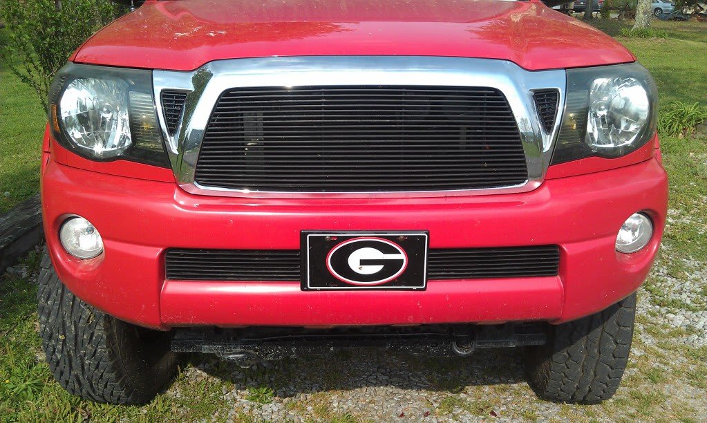

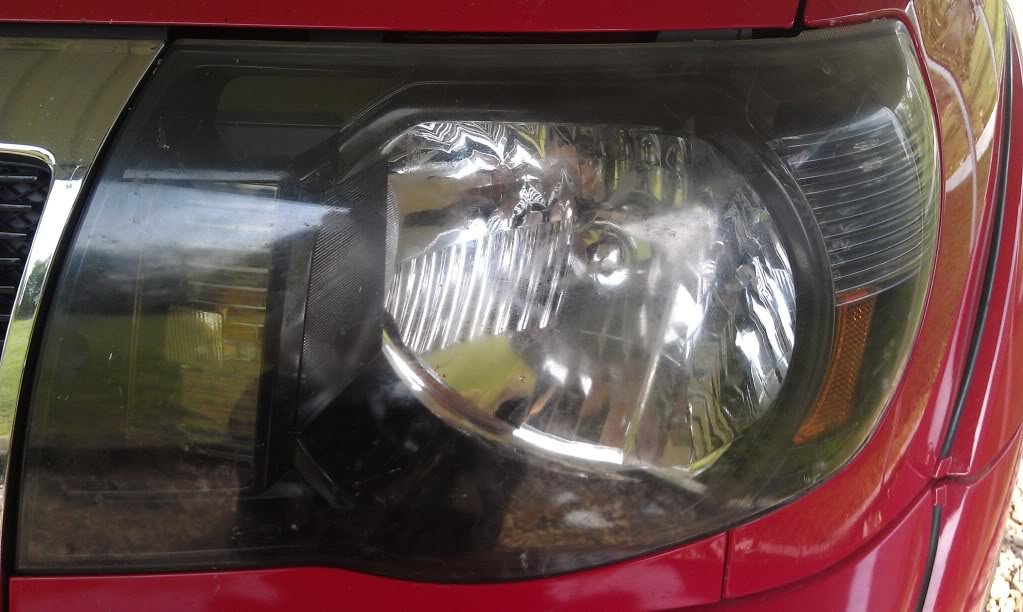

    Got both of them painted now waiting for them to dry...
    :popcorn:

    Now time color match the grille. I hate that chrome.

    ^^Looks kickass!!! Color matched grille surround will look WAYYY good!

    so disappointed... i've done on other vehicles in the past and i will say that the 12 lights are the easiest, however i guess i was a little finger happy on the spray can last night and got runs.... any suggestions other then sanding them down?
  16. May 7, 2012 at 7:29 AM
    #276
    Pugga
    Jun 18, 2010
    #39131
    38,719
    Massachusetts
    '19 Ford F-250 6.7 SCrew
    F-250 Land Yacht Mod
    If you threw them in the over right after you painted, the runs might have smoothed out. If it's dry now, you might be screwed with the exception of sanding.
