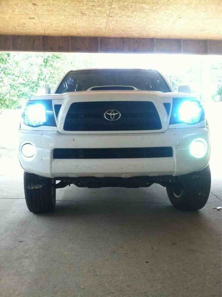

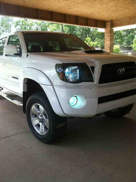

    Thanks for the write up! Did mine today and I think it turned out pretty good.. Took about 2-3 hours from start to finish

    Thanks! The write up helped out a lot! I could do most parts but I got to some parts and I'd have to look back here.. I'm tryin to do the black on white theme.. Tint shop tomorrow and hopefully black wheels next week
