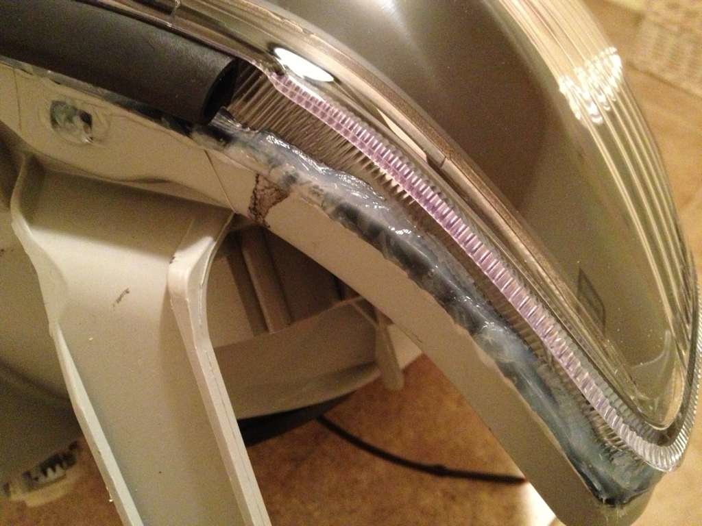

    Well crap I broke one of clips that holds the metal bracket to clamp the headlight in. Hoping super glue will fix this.

    JB Weld. Super glue won't hold up to the vibration on the road.

    Agreed, superglue has like zero shear force. JB Weld will work better.

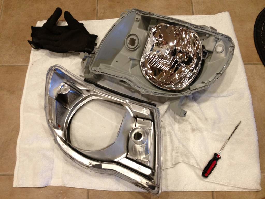

    Well, although I didn't use this thread to black out my bezel (bought the already blacked out Depo), I did use the techniques to install projectors. Overall, the process went as described. I would have to say I was most worried about getting the housings apart, when it came down to it, it was harder getting them back together, especially with the Window Weld seal.
    300 deg for 10 min (oven off) was perfect for me.
    I also sealed the outside of the seam with GE Silicone II clear sealant, to hopefully keep these moisture free.

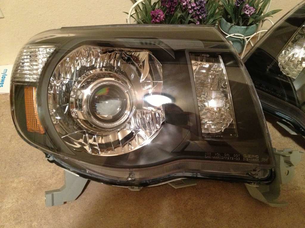

    Well I did it. I pre baked too before putting them bacm together. Only issue I had was I broke a small part of the inside bowl. But I had my fiance and her dad both come out and look and they didn't see anything. So it will go for a while until I order new ones
