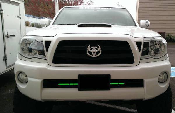

    My buddy KIRK did my Black n White HLM!

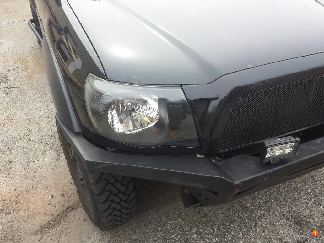

    Here's mine. Just finished yesterday.

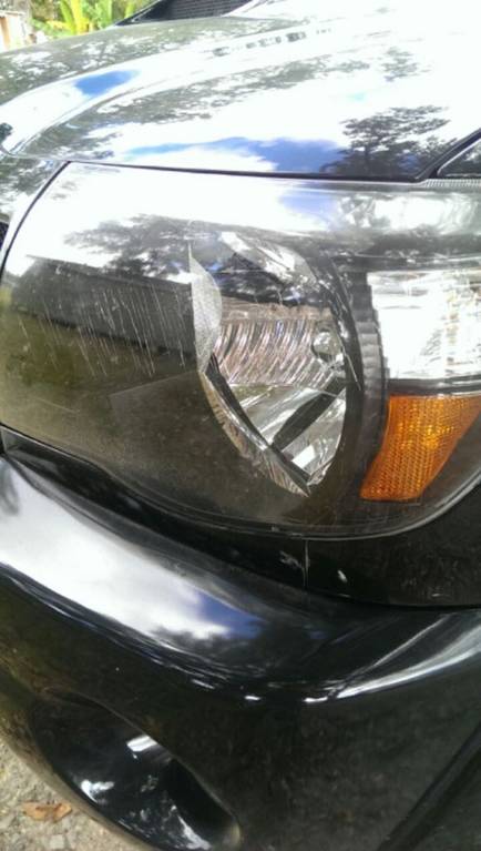

    how long did everyone wait to put the lens back on and reseal it?
    i think i may have put my headlight back together too soon....it was all good for about two month and then the lens started cracking badly across the middle.
    could it be because i put them back together while the paint was still drying?
    i put them back together when they were dry to the touch (about an hour or two later).
    i didnt let them cure in the sun or anything and i probably should have. im thinking the fumes from the paint still drying was trapped in and then slowly weakened the lens. the cracks are on the inside of the lenses.
