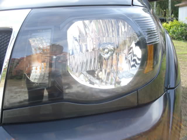

    Well thanks to Viet2100, Krazie SJ, and 671taco; you guys made this project go nice and easy. Here is my finished product from todays project. Sorry bout the pic quality though, just used my iphone camera......

    sweet nice job:thumbsup:
