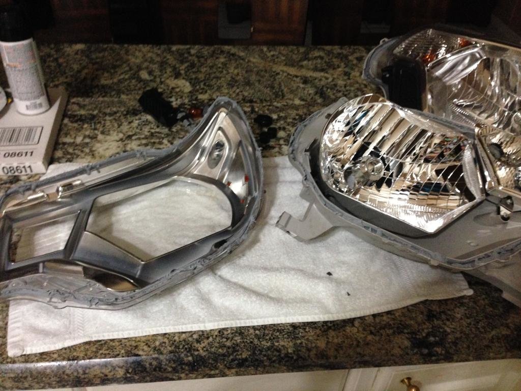

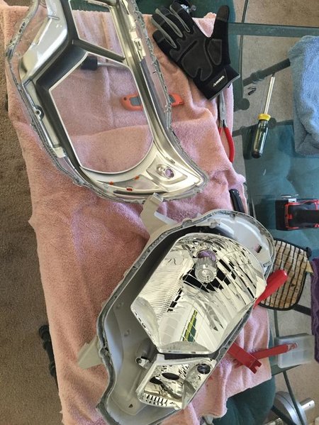

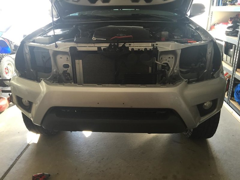

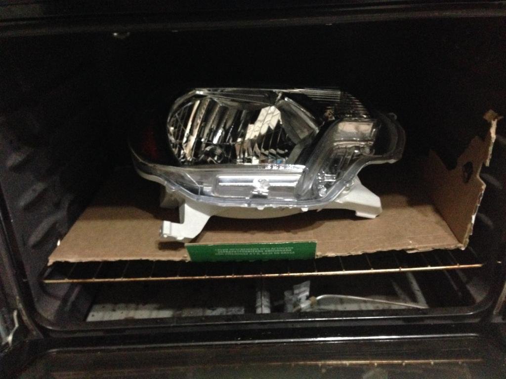

    Well, it took 9 hours for my 2012 but I did it and it looks bad-ass! Like other posters have said, it sounds more difficult than it is. The work was pretty straightforward and Viet's instructions were clear and accurate. I was feeling adventurous and decided to do both lights at once. If I were to do it again it would likely take 3 hours less to complete.
    1. Remove grille 90min This was the hardest, most frustrating part. It turned out to be simple but all of the videos did a poor job of explaining how the bottom clips detach. (Basically you remove the 2 top bolts and 2 plastic pins; remove the trim plates under the headlights then grab the inside and outside corner of the grill with both hands and pull slowly and evenly... but with a lot of strength. POP. Done. It turns out that you don't need to mess with the clips at all. Though it seems like you're pulling too hard, you're not. Wasted a ton of time as I didn't want to break anything.)
    2. Remove headlights. 30min. Again kind of a pain on the 2012 as there is one bolt in the fender well and you have to twist the lights out just right.
    3. Separate lights and bezel. 30min. A bit nerve racking as I was not sure about the oven but it was surprisingly easy. Viet's times and temps are spot-on. Instead of a screwdriver I used polycarb door panel removal tools which work perfectly and won't scratch the plastic. I simply pried one side enough to get my fingers in there then pulled it apart with a bit of strength.
    4. Paint. 4-hours. Sanded the bezel slightly with 1000 grit then applied 1 light and 4 medium coats of Krylon satin black. I also sprayed the Toyota grill badge and bolted on a black TRD badge next to it.
    5. Reassemble Lights. 90min. I did mine a little different. Instead of removing all of the old material I left it and added a 1/8th bead 3M window sealant. I reattached the bezel and put both separated halves in the oven at once. This preburned the paint and softened the adhesive in one step. Make sure to reattach the orange reflector! I forgot on the first one so it cost me some time. D'OH!
    6. Reassemble truck. 60min. Had a bit of trouble getting the bulbs back in correctly but it went pretty smooth.
    I gotta say that, though I'm glad it's completed, I feel quite accomplished at the moment. I'll post pics tomorrow as it's time for Dr. Jameson.
