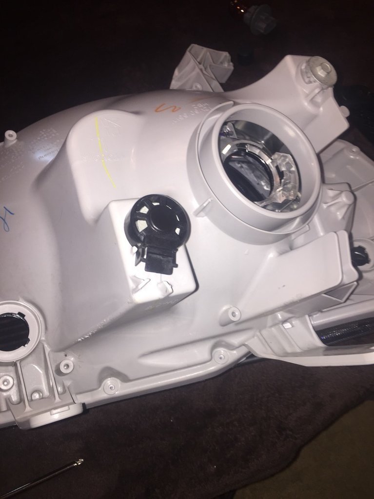

    Ok I dove in... Getting these 12+ lights out was a pain!!!
    Finally got them and I'm stripping the housing.
    What is this black vent thing? And more importantly, how do I remove it???
    Scratch that... I just pulled up and they came off. But do I need to remove the metal dial underneath it?

  17. Jun 27, 2015 at 10:34 AM

    Do I need to remove the weather stripping at the top of the housing?

    The bkack plastic tab cover things can be remived with a pair of pliers. Go easy. The weather stripping rubber can stay on.
    Good luck. Its easier than you think!
