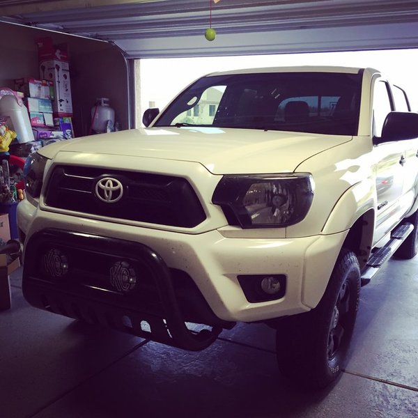

    Just got my headlights done. Easier than expected!
