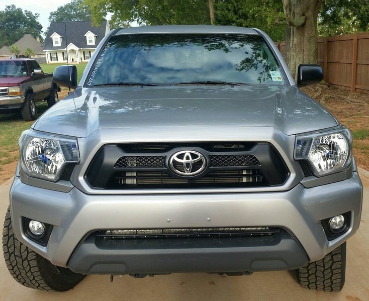

    They are not black but here are some lights i did for a guy.

    I like the grey! it looks like the oem smoked ones. i didn't want to go completely black, tried the black chrome paint bit since it was translucent I had a hell of s time getting even coverage so i ended up doing so many coats it ended up black.

    what color did you go with?... those look great.

    Looks like silver streak mica 1e7 or the newer silver sky metallic (?) I think it is

    It's the darker silver. I can't remember the code. I believe it's for 14 and up.
