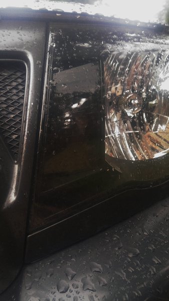

    Followed this guide and got good results. Thanks! tmp_6957-20160824_200638_HDR-011433604684.jpg tmp_6957-20160824_200655_HDR-01761087648.jpg tmp_6957-20160824_200622_HDR-01-01-133208672.jpg

    Just wanted to add my 2¢
    Things I did differently
    1. I pried the housing open with my hands. The plastic bent a bit more than I liked with the screwdriver.
    2. I did both lights at the same time. I put one in at a time, opened it and placed the next one. While I waited I started to scrape the old sealant while it was still hot.
    3. A screwdriver works fine to remove the old sealant. Just keep it clean by sticking the left overs on to a ball of just removed sealant.
    4. Keep your hands clean. The oil from your fingertips will mess with the paint.
    5. Right before painting I used t.s.p. To clean the all the parts to be painted.
    6. I wrapped my left arm with plastic and held the parts from the back while painting the whole time.
    7. Clean the inside of the clear plastic cover with a lens cleaning cloth to grab all the dust right before re-installing. I forgot to and now have a couple of my dogs hairs inside
    8. Most of your time will be spent on cleaning out the old sealant. What I did was pre heat to 300 turn off and place piece inside for 5 min. Remove one piece from the oven and place the next one inside. As soon as you feel the sealant start to harden just swap them (one in oven one to work on) this way your not really waiting for anything
