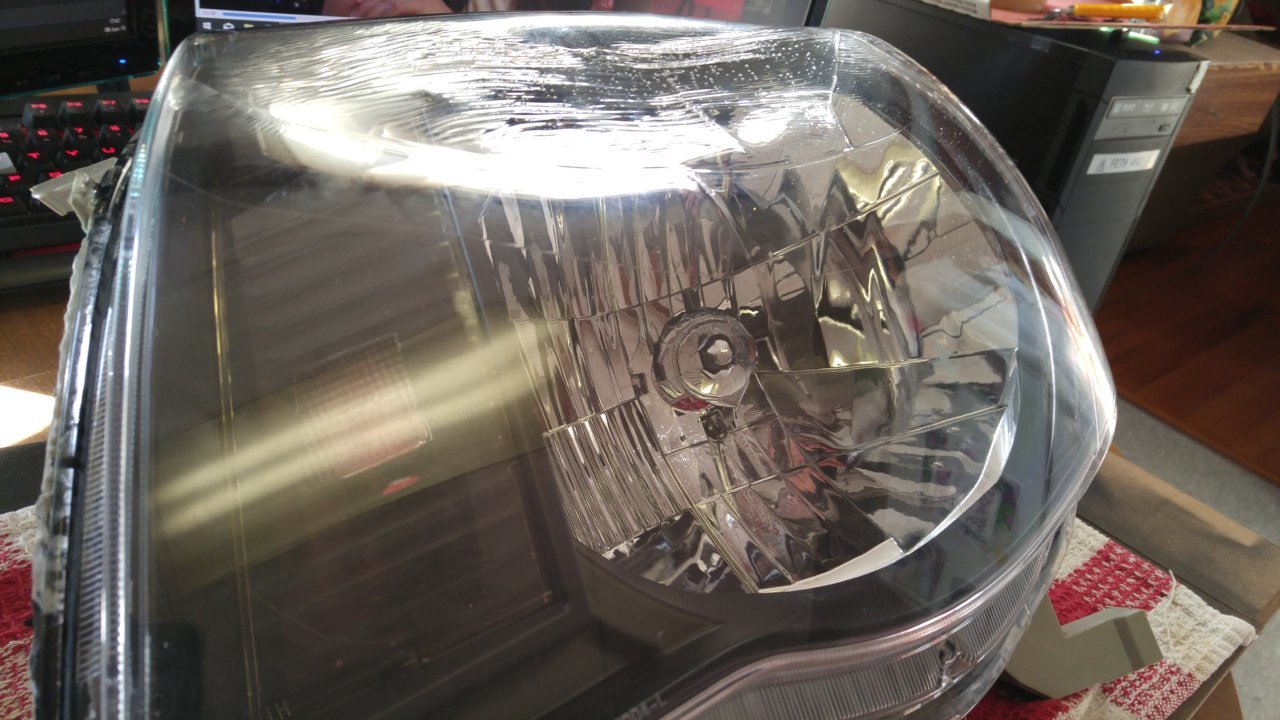

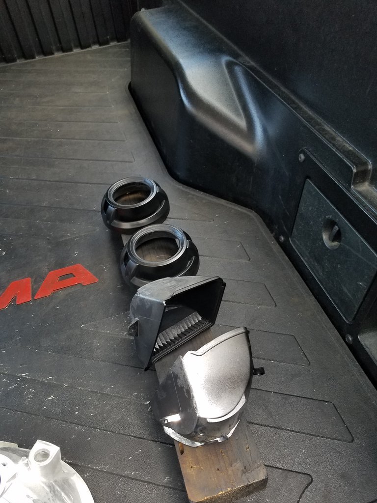

    Here goes something...using fusion spray paint

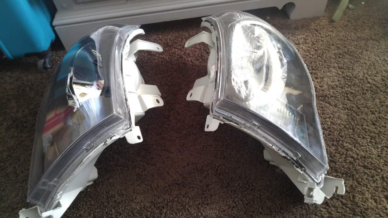

    Here's a BHLM fail for everyone to watch out for.
    Followed the steps but believe I failed to let the heat dissipate between the second last and last bake.
    If anyone has any suggestions I'm open to them. I think my options are
    1. Remove the oem lens after a good polish and swap it out.
    2. Attempt to heat and meld the lens back (won't be perfect and definitely will be some light distortion)
    3. By a new lens and try again (junk yard, ebay, Amazon etc...)
  4. Jun 10, 2018 at 4:21 PM
    #744
    Matmo215
    Matmo215 Well-Known Member
    Sep 15, 2016
    #197333
    7,645
    Matthew
    Waco, TX
    2015 Sport DCSB
    Probably best buying some Depos and sealing them with silicon, mine work great. Light output is the same as stock IMO. Plus, they're already blacked out
  5. Jun 10, 2018 at 10:51 PM
    #745
    NickofTime
    NickofTime Well-Known Member
    Jun 17, 2015
    #157617
    186
    Nick
    Anchorage, Ak
    2006 White Tacoma DCSB TRD
    I just throw money at my truck
    You don’t put the lens into the oven for any reason. The last few bakes should just be to let the paint cure and then just a short bake to heat up the new adhesive. Once you put the lens back on the housing, there’s no more oven use.

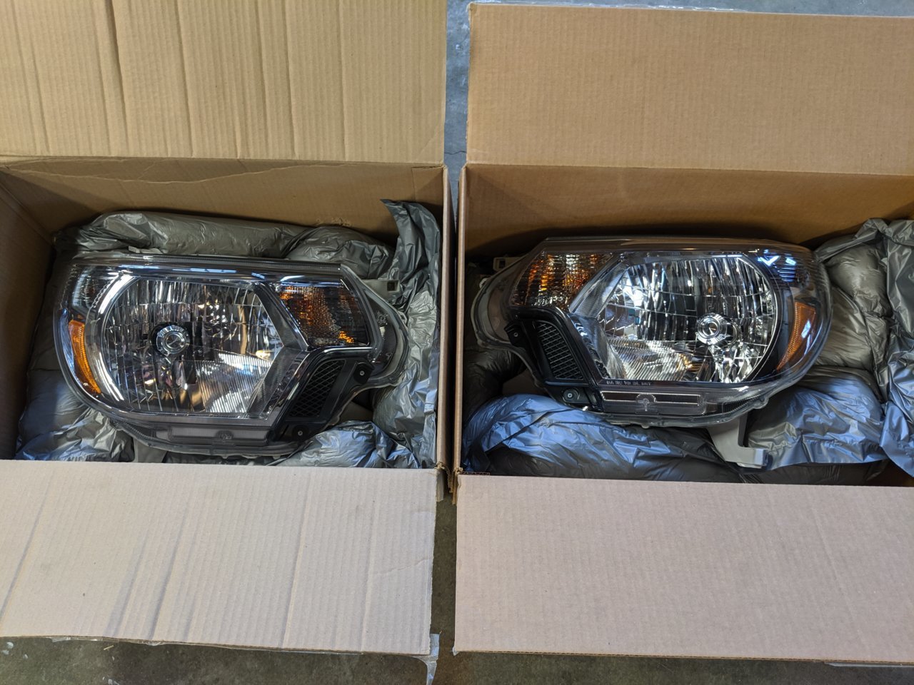

    I did mine today out of boredom. I had the stock headlights laying around after I put in brand new OEM TRD Pro headlights. Now I don't know which I prefer... :facepalm:

  7. Sep 8, 2018 at 4:49 AM
    #747
    Sky_Hawk25
    Sky_Hawk25 Well-Known Member
    Nov 30, 2015
    #171049
    206
    2014 MGM Tacoma
    Do you still have both headlights? TRD and BHLM?
  8. Sep 8, 2018 at 6:22 AM
    #748
    BaywatchDV
    BaywatchDV Well-Known Member
    Jun 7, 2018
    #255759
    266
    2015 Tacoma TRD Sport
    I have the BHLM installed and sticking with them. I have the TRD Pros all boxed up ready for any takers.

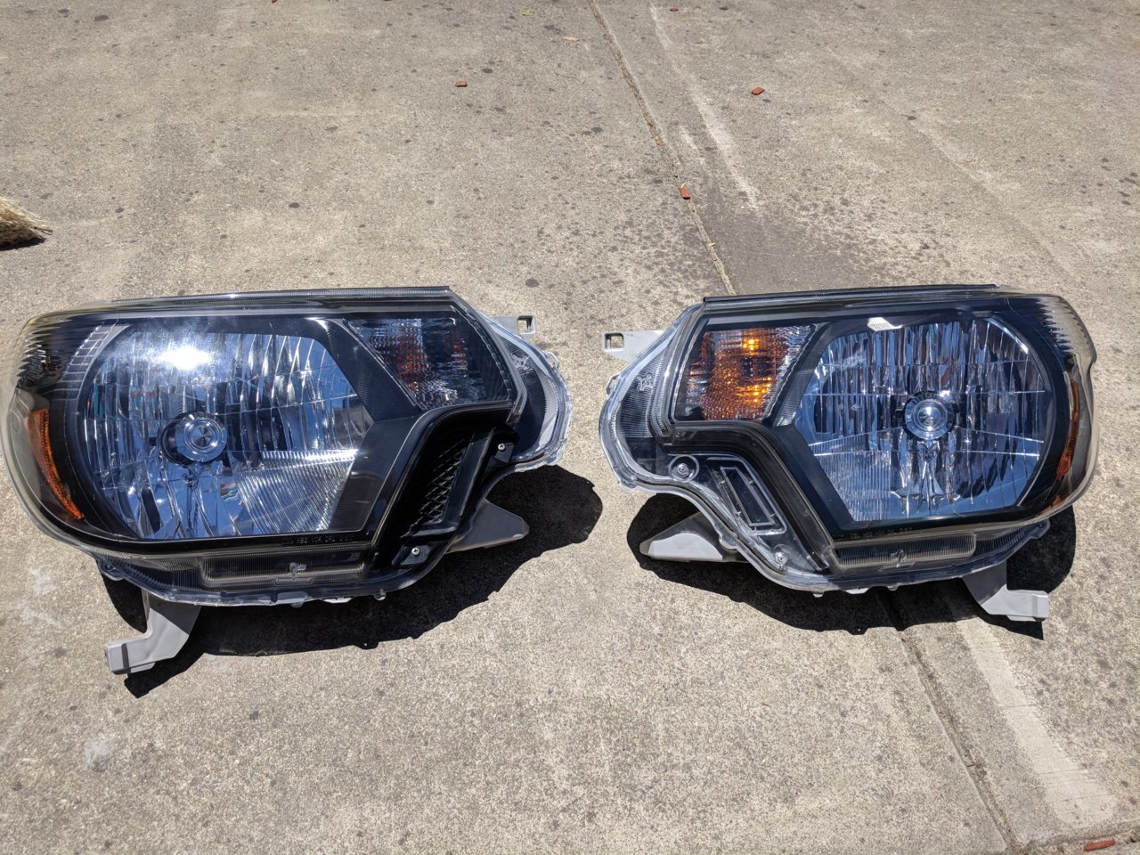

  10. Oct 31, 2019 at 12:07 AM
    #750
    squint0241
    squint0241 OVRLND
    Jan 4, 2014
    #119916
    6,868
    Rick
    Tropics
    '14 DCSB/Off-Road 4X4
    Bone Stock
  11. Oct 31, 2019 at 11:49 AM
    #751
    onesixonetwo
    onesixonetwo Well-Known Member
    May 1, 2019
    #291919
    494
    Which one is which? They look equally great and I can’t tell the difference.
  12. Oct 31, 2019 at 11:58 AM
    #752
    BaywatchDV
    Jun 7, 2018
    #255759
    266
    Those are both my BHLM lights. I ended up keeping them until I got retrofits recently. I sold my pro headlights. Here is a pic of them.IMG_20190926_145207.jpg
