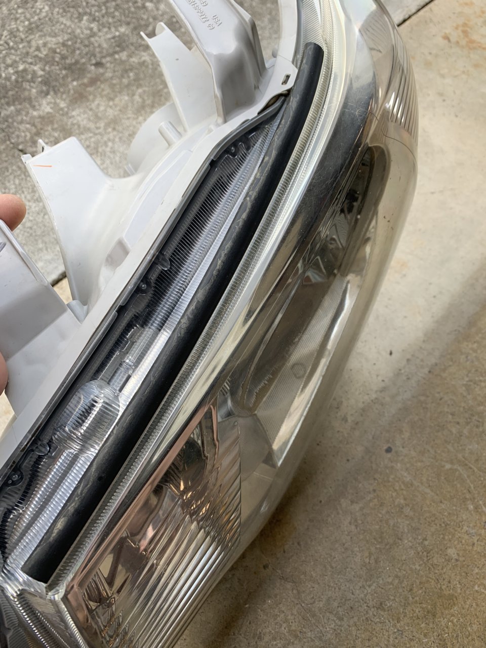

    Do you remove the black rubber piece on top before baking them?

    I don’t think I did but I baked mine super low and super slow.

    I can’t remember right off, I pulled mine apart a few years ago to build a retrofit. I followed this thread but lowered the temp and increased the dwell time a few minutes and didn’t have any issues pulling the light apart.

    I took mine off teh first time. The second and third times, no. Didn't see any harm by leaving them on, but that all depends on the temp you're using.

    I have the same piece on my GX470 headlights, I just left it on. Bake times that have yet to fail me are 275° for 5 min and I try opening it up and put it back in for another 5 until it opens. This helps keep the housing from getting too soft and deforming. I also use trim pliers almost exclusively and don't usually need any other tools.

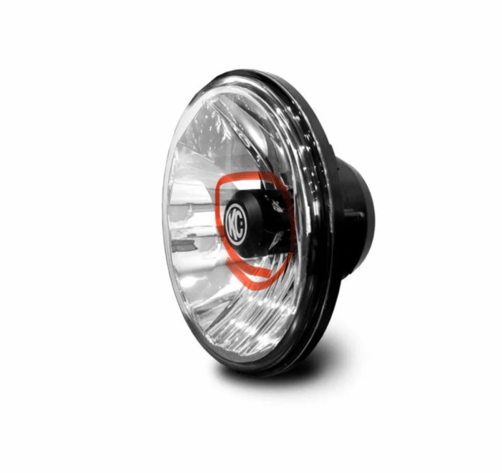

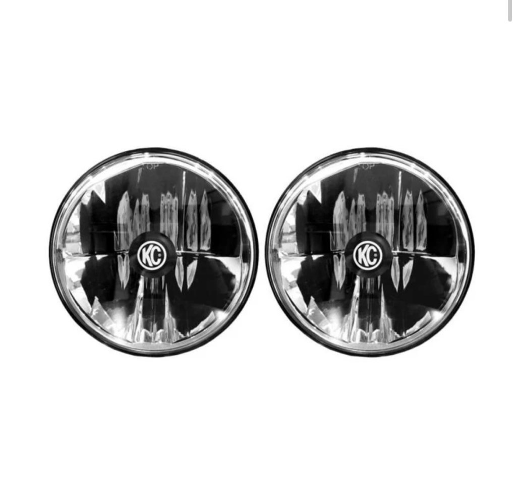

    Doing my 3rd BLHM. Did something that I haven’t seen in this thread so hopefully won’t regret it
    KC has some lights with the center nub thing painted black like this
    Seems like it gives it this cool black mirroring effect
    So I copied it for the Tacoma because I personally like how it looks.
    if I’m stupid for doing this let me know, but these lights were free and I can always just get a new set or do a full retrofit if it ends up being a bad thing. Will post end result.

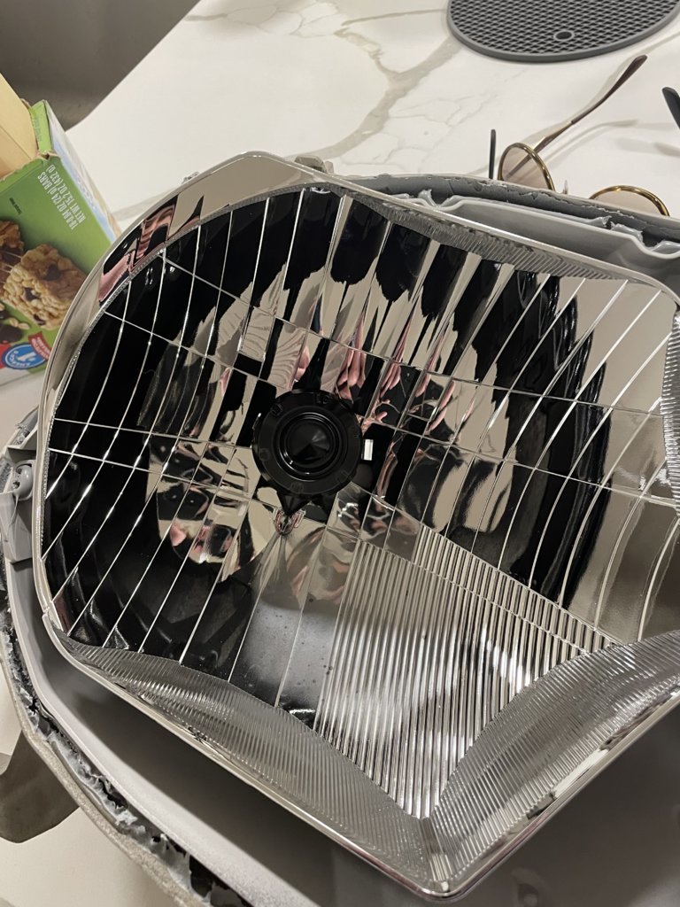

  8. Jan 28, 2025 at 2:20 PM
    #768
    Oreo Cat
    Oreo Cat Worst Member
    Sep 19, 2016
    #197755
    5,342
    Coeur d’Alene, Idaho
    headlights all done, my idea to have the black reflection isn’t really noticeable
