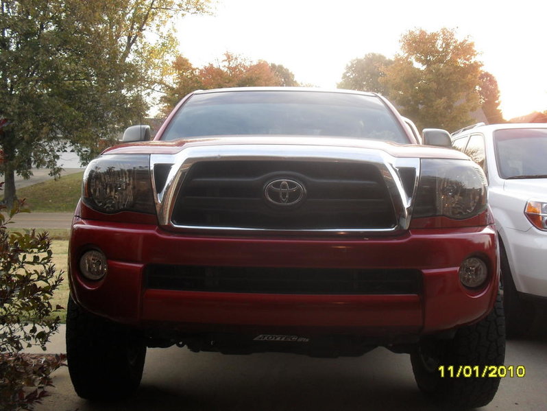

    2018 T4RTRDOR
    Thanks Viet for the writeup.
    Heres mine

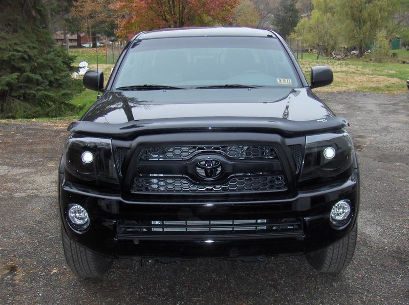

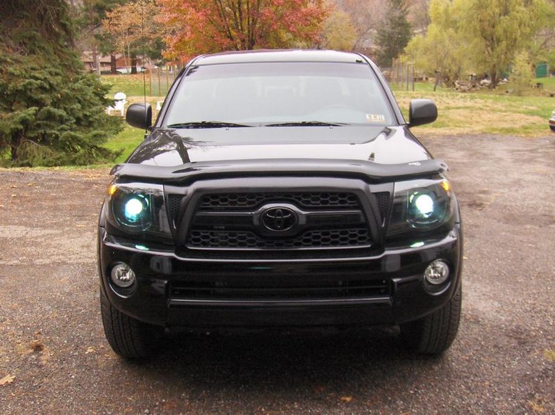

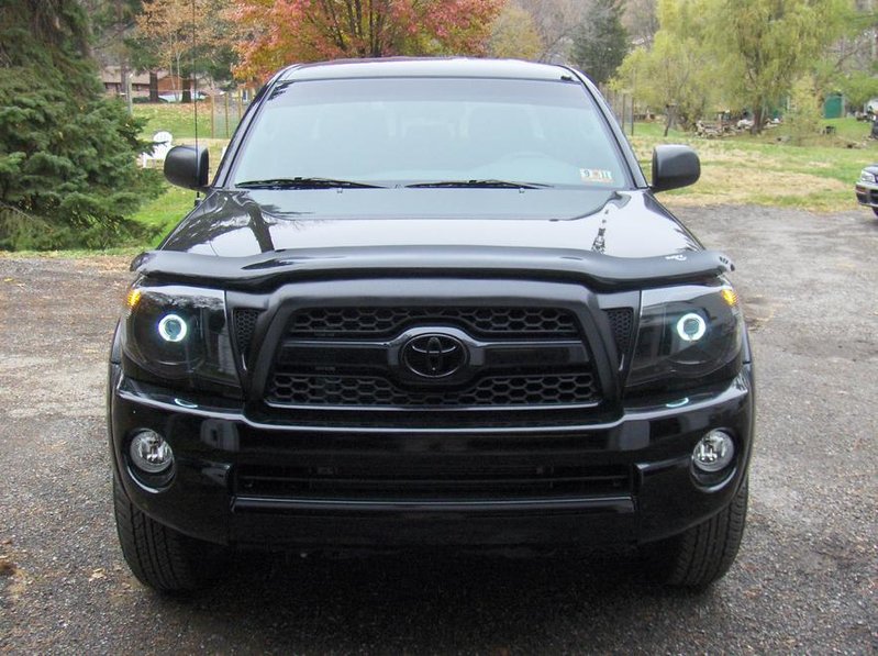

    Here they is.....
    a few lil boo-boo's but I think it turned out pretty good.
    Kinda ripped off Viet's look, but Im in small-town WV, and no one will ever know:rolleyes:
    Anyway, couldnt have done it without this badass thread....
    thanks!

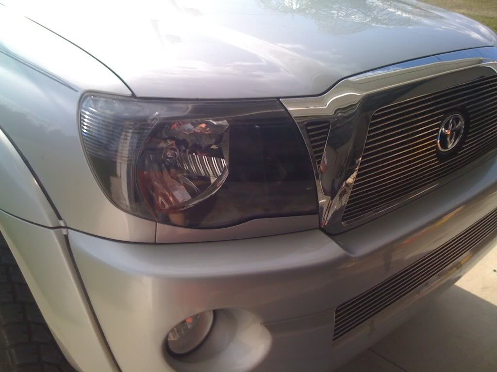

    Marc
    North Port, FL
    06 4x4 doublecab
    all done, looks good. the only thing i did different was after i took the grey half out of the oven for reassembly, i put the lense back on, then put it back in the oven for another 10 minutes, then pulled it out and gator clamped it. iPhone pic.
