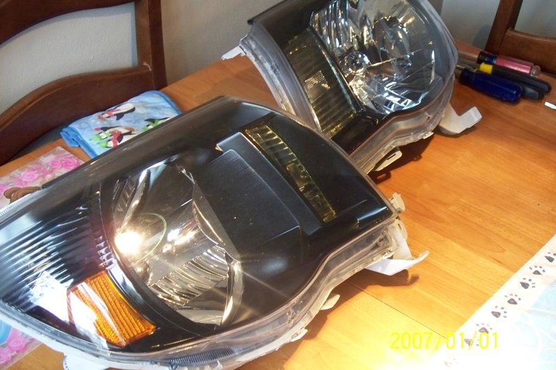

    Great write up and very easy to follow. Thank you Viet.
    Only thing that I would say or my advice is that instead of trying to fight the OE sealant and removing it, that stuff is honestly your best friend. It's gives you the best chance for a tight reseal.

    I agree. When I did mine (both times), I pushed the OEM sealant back into the grooves while it was still warm. Two sets done with multiple years of use and no problems so far.
