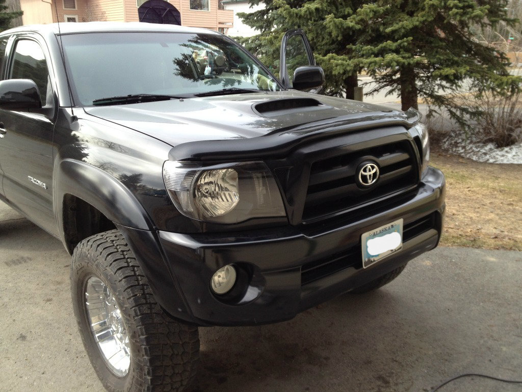

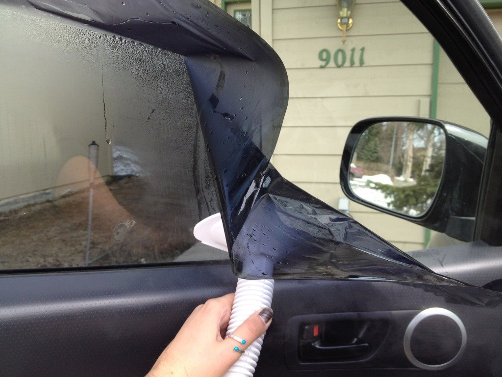

    Two days after I got my plates switched over to AK, I got pulled over by the cops for having illegal tint. Apparently what is legal in AZ is not in AK.... So off came the tint. Using a clothes steamer made it really easy.
    While I was at it, I also replaced my headlights. The brackets on the passenger headlight was broken so I got some E bay headlights and sealed them up with silicone.
    Tint Removal
    New headlights done!

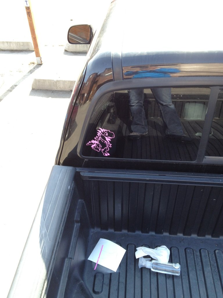

    Also put on a goofy T Rex Sticker...

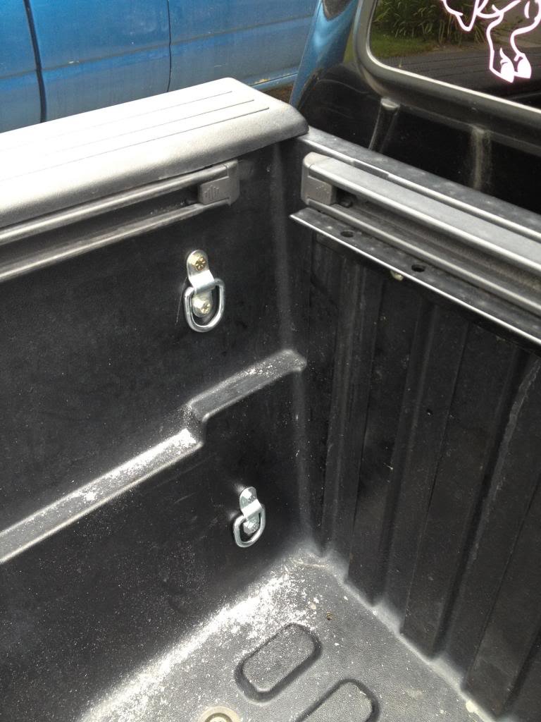

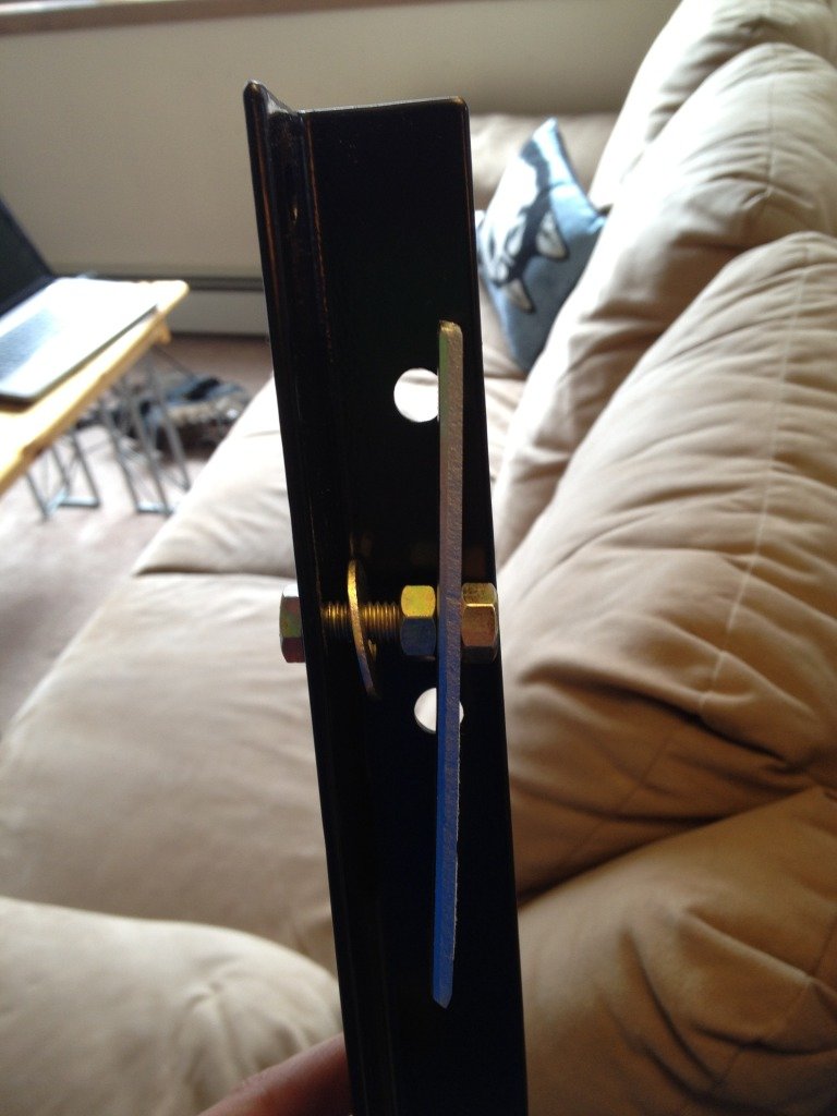

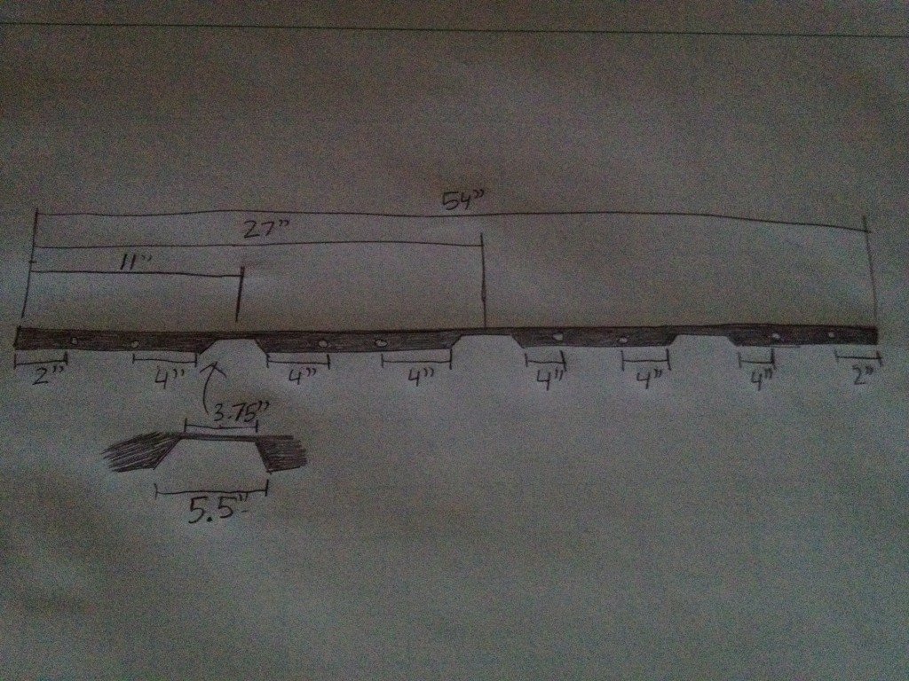

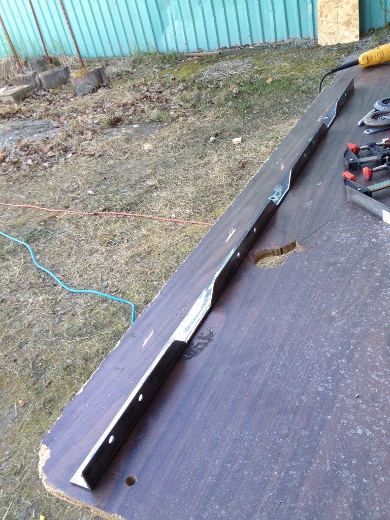

    Next problem I wanted to deal with was the lack of tie downs... So I installed a few D rings and made a dirt bike rack!
    D Rings. I put some large washers behind them to reinforce them. More or less sturdy.
    Plans for the bike rack. Nice n simple and no welding needed. Since I have no welder access at the moment :(
    Done with the drilling and grinding.
    Lining it up to attach to the bed
    Force dispersion method.....
    Powder coated and installed!! :D

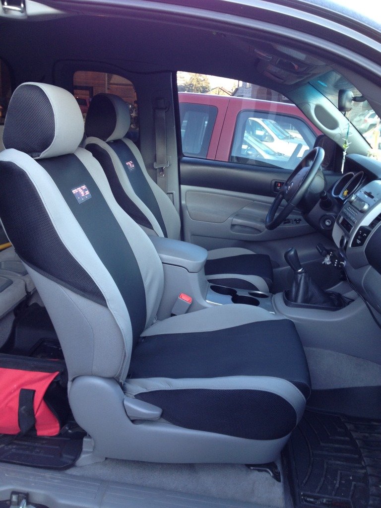

    what brand of seat covers are those?
  8. Nov 13, 2012 at 9:55 PM
    chipnoreo
    chipnoreo [OP] Ready for snow!
    Oct 4, 2012
    #88331
    2,515
    Anna
    Alaska
    Ram Eco Diesel
    Getting 30 mpg on the highway
    they are the factory toyota ones. I got those off E Bay for 150ish.
    The black gets really hot in the sun and really cold in the winter though....

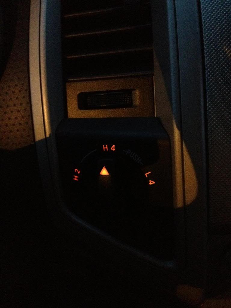

    So this last weekend I got bored and started messing with the truck again.
    Finally got my lighted 4wd switch in :DIMG_5739_d9ea675f740a75c80c8aa6e1418ee7184ae585bf.jpg

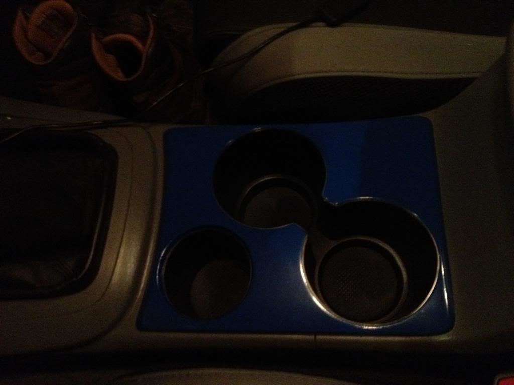

    Painted the console... more blue to come :D. No garage and sub-freezing temps so I painted it in my bathroom with my fan on.... roommate LOVED that....

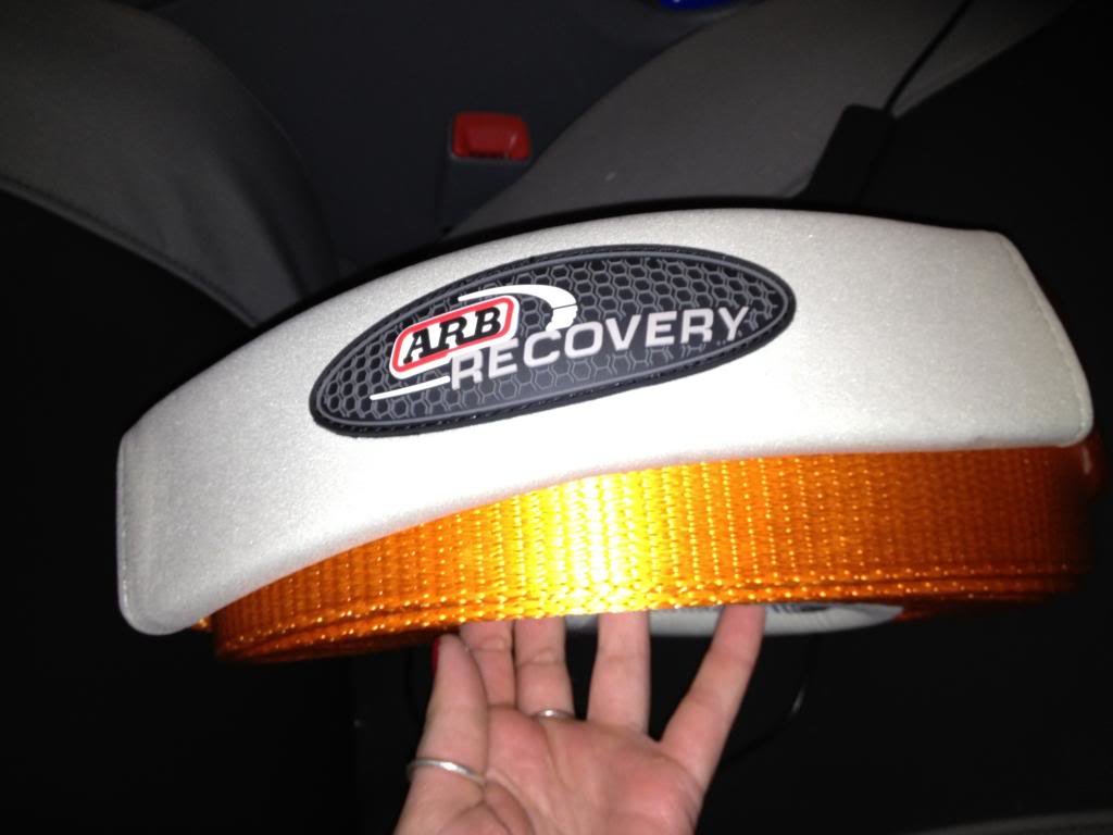

    Got some recovery gear... cause ya know, people like to drive into ditches in the winter in AK. Going to get a lock to put on it to deter people from taking it....
    Gotta have a quality recovery strap to go with the fancy hitch receiver.
    Anyone have a clever way of storing a 30 foot recovery strap in an access cab? I have it shoved awkwardly under the seat right now....
