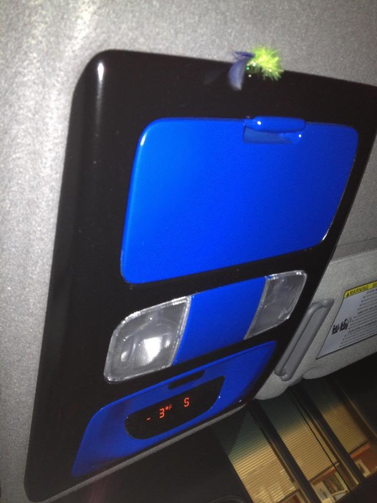

    Painted my overhead console. Got impaitent and messed up the paint while trying to untape a few times. Krylon fusion is awesome but you still have to be patent.....
    I almost wish i had waited to put it back in... I didn't need to know how cold it is.
    the truck itself is lookin pretty frosty! Time to warm up some so we can get some damn snow!

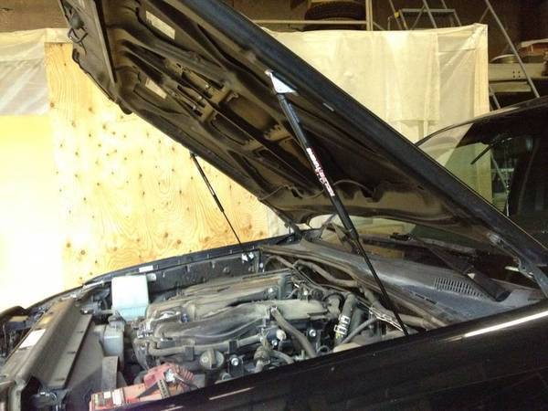

    spent some time with the truck this weekend. Got my Redline hood struts put on. And since it was washed and in a garage, got my new sticker put on :D
    Also pulled off my engine cover and dash rings for some painting :D Should get those done and put back on the truck in a week or so
    Very pleased with the quality of the hood struts. I had been doubting exactly how useful they would be. My conclusion is that they will be very useful. No more struggling to get my hood prop in! Lifted truck+not being very tall=some issues. The install was pretty easy, though I found the instructions unnecessarily confusing. Too many details and the pictures were a little too specific for my taste. Then again, the problem might have been the large amounts of alcohol and lack of sleep that I had the night before...

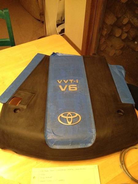

    Waiting on some Christmas money to do anything toooo expensive to the truck... So more painting in the meantime!
    Ohhh yeahhhh.. +25hp
    That's 2 hours of taping right there.

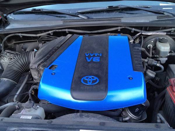

    Annddd more blue :D
    I think I will paint all my chrome this color.... :D
    anyway, for anyone curios about my process for painting... it has worked REALLY well, the surfaces look super clean and professional, and it has held up AWESOME. I will swear by Krylon Fusion for all painting purposes.
    Tape off whatever I don't want to paint.
    Scuff up the surface to be painted really well. I usually use a number 400 sand paper.
    Paint a light layer; don't worry about full coverage.
    Wait 15 mins, spray on another coat.
    wait 15 mins, lightly sand to smooth out imperfections/any dust particles that got in the paint.
    gently wash and let dry. Once dry, I use my (washed) hands to brush off any dust. If you have a lint free paper towel or something that would work too.
    I then do two more coats and then repeat until I am happy with how it looks.
    I end up with anywhere from 6 to 12 coats....
    Then WAIT at least 24 hours to take tape off. i have messed up the paint by being impatient before on this. It is dry to light touch pretty fast but can still be messed up if you don't wait.
    I then let the paint "cure" (as per the instructions on the can) for 7 days. I am not sure how necessary this is but it has worked for me so far! I also don't want to mess up the curing process by putting the new paint in my truck with sub freezing temps. If the climate were more moderate I might not wait...
