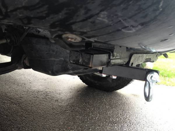

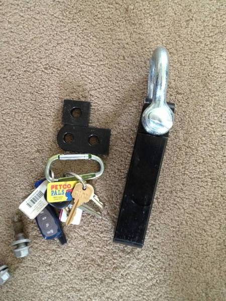

    bought a bolt on shackle mount to replace the crappy one that comes on the TRD sports.
    brand is rampage, made for jeeps, but bolts right on to the stock holes. Got it for $20 off Amazon. (on sale). Had to buy longer bolts to make it fit since the ones that came with it were too coarse a thread (and probably standard and not metric)
    Since it bolts into the existing holes, it kind of comes out at an angle. Sticks out a little bit. However, much much more solid recovery point than what came on it. And you can get a secure shackled connection. :) It will do until I get a plate bumper.... someday!
    Pics!
    to show the size

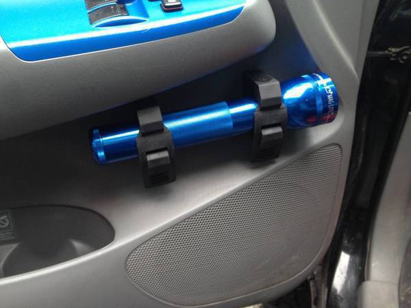

    mounted some stuff up this weekend... now i just need to get power to the CB... and lightbar (see previous posts).
    Cobra 29. couldn't really find a clever spot for it and didn't want to pull the faceplate off. I like how it I have it though. Should work out pretty well for me!
    Maglite mounted with quick fists

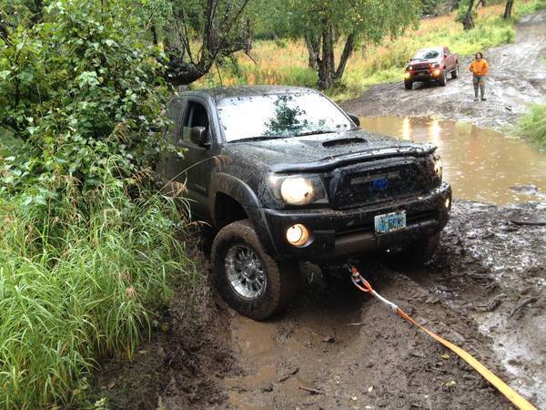

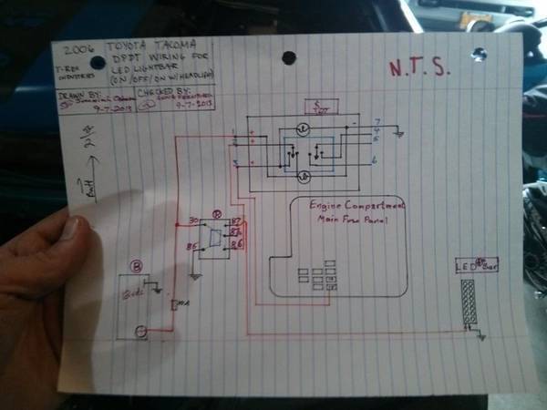

    Finally got my lightbar hooked up. Sat down with a fellow member and had a wonderfully nerdy engineer time while drawing out the diagram for a DPDT switch for On/Off/On with headlights options. Thread on wiring
    Wired it up a lot like this
    Except the 1/2/3 moved to the 4/5/6 respectively. The way we had it made the back light on the switch stay on even with the ignition off. Not back light right now but i don't mind. Will probably mess with the wires later to light the switch sometime. Not a priority at the time.
    Little dirty already...

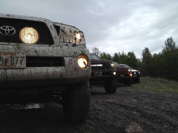

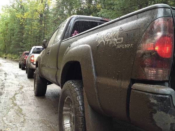

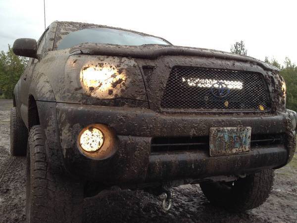

    Then took it wheelin today. Got muddy!!
    got hung up on a tree :( Wish my sliders were on... but damage was minimal and next time they will be outta the garage and on the truck
    glad I just put that front shackle mount on!\
    New suspension was great :D Just need some new tires and I will have a proper setup! The grapplers with 20k+ on them were just not cutting it in the super sloopy mud....

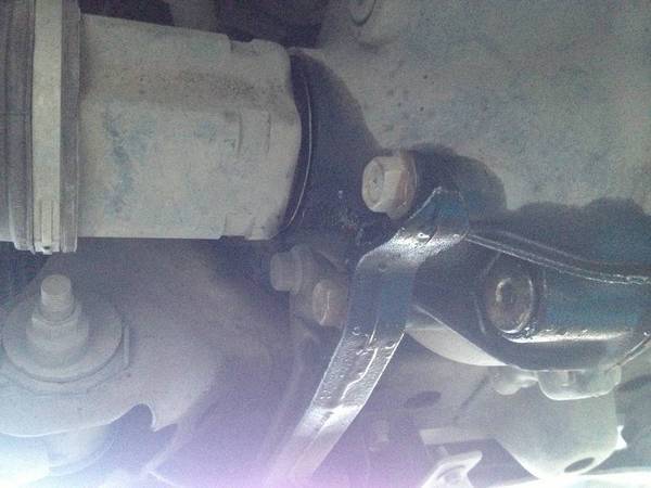

    Noticed some oil under my truck... crawled under and found this :(
    Looks like its the front diff oil seal.... guess I will replacing it this weekend.
    Pretty sure it went out from the wheeling trip a few weeks ago.... gotta pay to play!

    Seal was replaced last weekend. Other than the 35 mm bolt being torqued on as fuckkkkkkkk (broke a wrench and too much for the air compressor run impact) it wasnt too bad to change out. Looks like the leak is gone :)

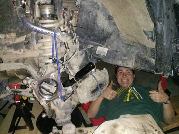

    Finally got some stuff done on the truck!
    Old pic from fixing the diff seal. I look so stoked...

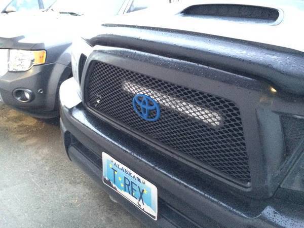

    Decided to paint behind the grille black. Felt like there was too much going on with the lightbar mount to really pull off the blue.

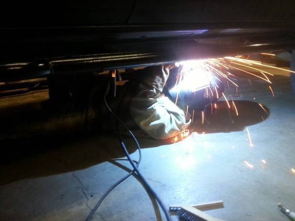

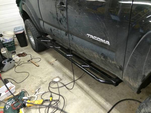

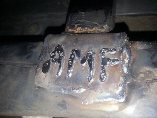

    Annddd finally welded on my sliders! Ended up just doing it myself cause ya know, its only the frame I might ruin. Those aren't important, right? Anyway, after getting the welder dialed in, it turned out great!
    doesn't look half bad
    I swear that's me!
    Shoulda done this before it was on the truck and upside down.... would have looked better. Oh well! guess the truck is permanantly marked as mine now

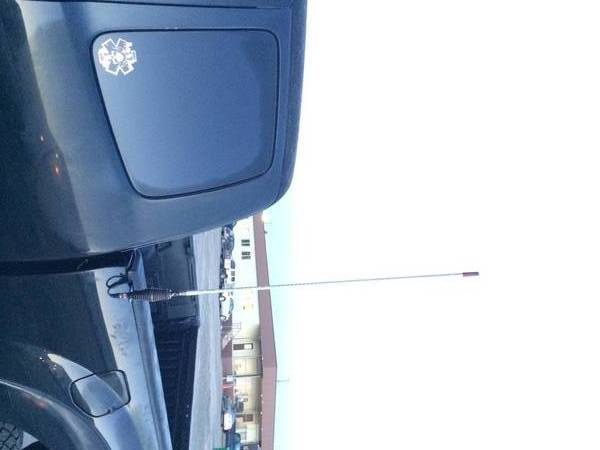

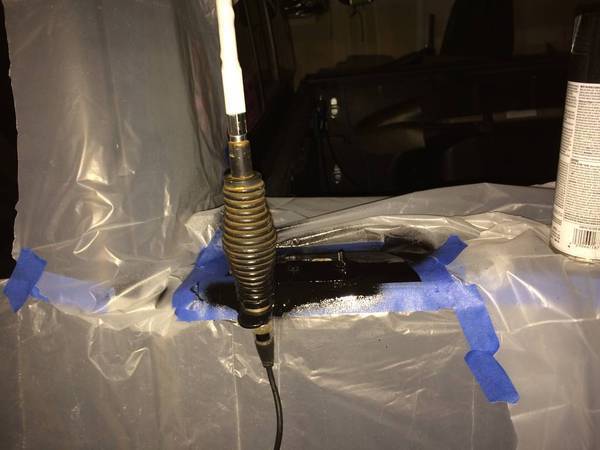

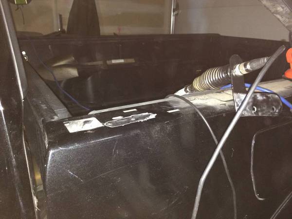

    Got my antenna mounted and my wiring for my CB done last night :D Just need to tune it. Just ordered a 4' antenna. So this one will be replaced with a black one soon.
    I mounted it like this so that I could still install a tonneau in the future and the mount would not be in the way regardless of what style i choose.
    grounding
    painting
    Done!

    Cool like seeing updates. What did you use to remove the cv? I need to change out my passenger side one.... My outer boot has been torn for like 6 months
  18. Oct 28, 2013 at 1:00 PM
    #138
    chipnoreo
    chipnoreo [OP] Ready for snow!
    Oct 4, 2012
    #88331
    2,515
    Anna
    Alaska
    Ram Eco Diesel
    Getting 30 mpg on the highway
    haha it wasnt all that hard. It is suggested that you use a slide hammer with a specific attachment. However, we didn't have one of those so we used a regular hammer and i think a screwdriver (maybe a blunt chisel? I don't remember what exactly we used...) to tap it out. Took a while but it finally popped out.
    There is a ring on the inside of the CV shaft that depending on which way you have it either lines up in the groves or is out a bit, locking it in place. You will have to rotate the CV to get this to release and make sure it is oriented the right way when you put it in.... we didn't and it took forever to get back in. This will make more sense once you pull it out :p
    It is a pretty straightforward process. Shouldn't take more than a few hours unless you break tools and take a 3 hour break getting more :p
