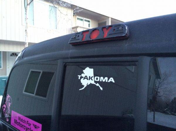

    Got some custom decals for the AK tacomas :D

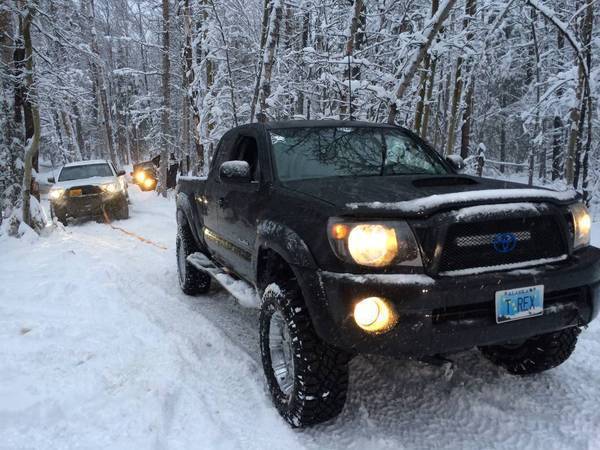

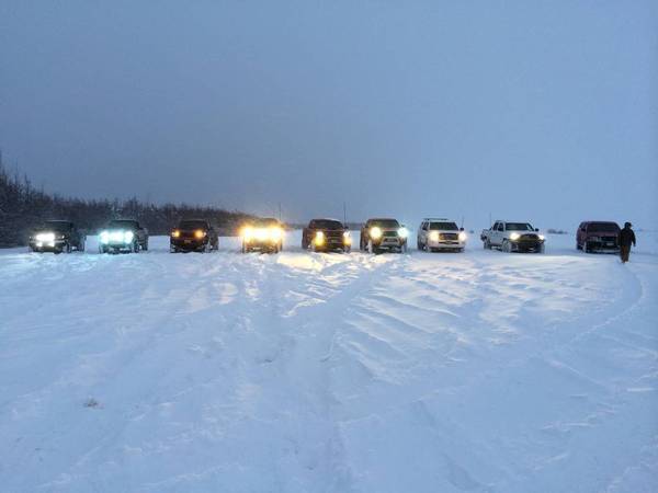

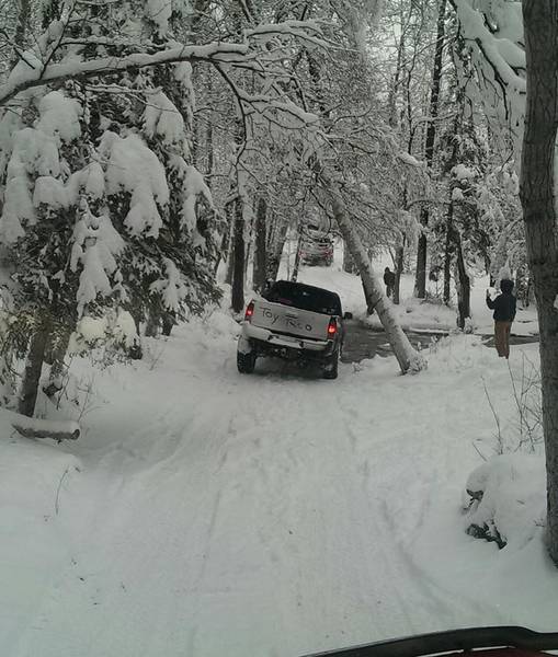

    Couple of shots from our snow wheelin trip last weekend :D

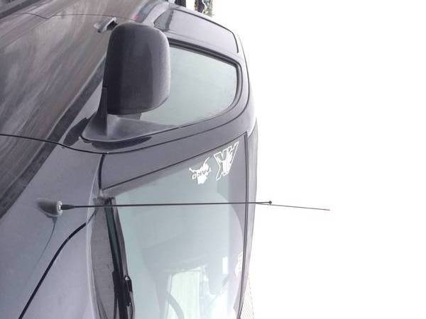

    Bent my stock antenna on some trees while wheeling :( I was worried that it might snap since the metal had been weakened to I got an aftermarket. I was looking for one that was stock length but didn't see any. I like the "clearance gauge" feature since i am lifted. :p I have to get out to fold down my 4' CB antenna anyway though so I guess I can just check when I am doing that.
    anyway, I got a 15" antenna. (from here) Reception seems a little less on some stations when out of town. (it's alaska so I don't expect much though) Overall, pretty good reception. Not so sure about the claim of "spring stainless" but I guess I will find out at some point when I mob through some trees :)

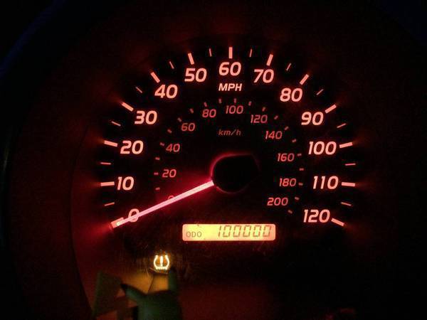

    Finally got my warranty replacement duratracs on :D Much better. Still a slight vibe around 50 mph that i dont remember though... :( gonna take a look at the driveshaft/u joints/etc this weekend when i do my oil and radiator flush.
    Oh, and I hit 100k :D

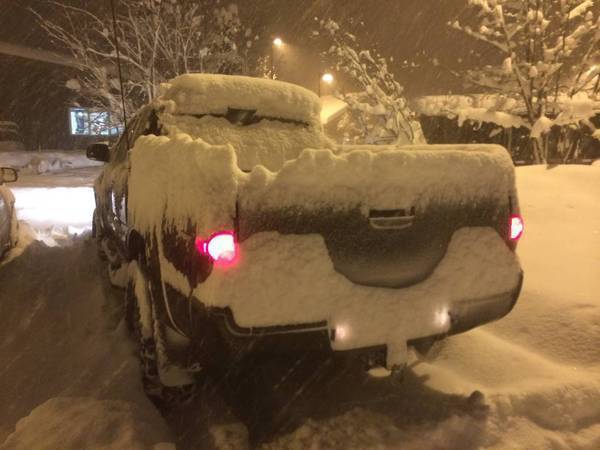

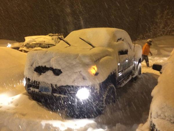

    Snowwww :D
    Went for a drive. Hadn't plowed yet :D

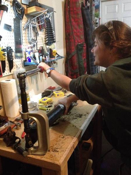

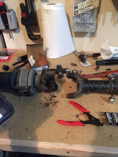

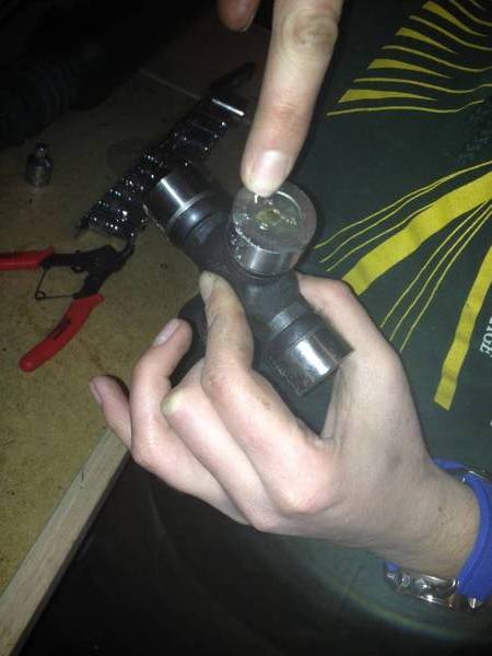

    Took two days since I fucked up a new U joint at about 11 pm the first day and the parts store was not open anymore... but got three new U joints on the rear drive shaft. The middle one had a fair bit of play in it. When we removed it, the bearings were definitely in bad shape. The front and rear were still in good shape but for $20 each, I figured I would just replace them while the drive shaft was out and not mess with them again for a lonnnnggggg time.
    Never done U joints before so it was a good learning experience.
    Dragging the drive shaft out from under the truck. Took about an hour of banging on it to get the front and rear to separate
    All the shit that fell out of the middle one when we took it apart.
    Using the press. This made it way easier than using a hammer.
    Pretty new u joint
