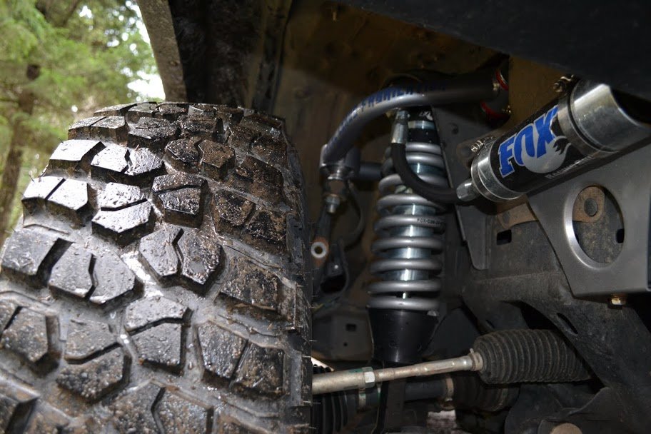

    - Fox 2.5" coilovers on the front. Smooth ride, will take extended abuse periods without fade. Provides additional adjustable clearance in the front. Rebuildable if the valves fail.
    - Total Chaos Upper Control arms - Required for the sized tires I'm running and angles the suspension will sit at. Fatter tires will rub (285/75/R16) on stock arms.

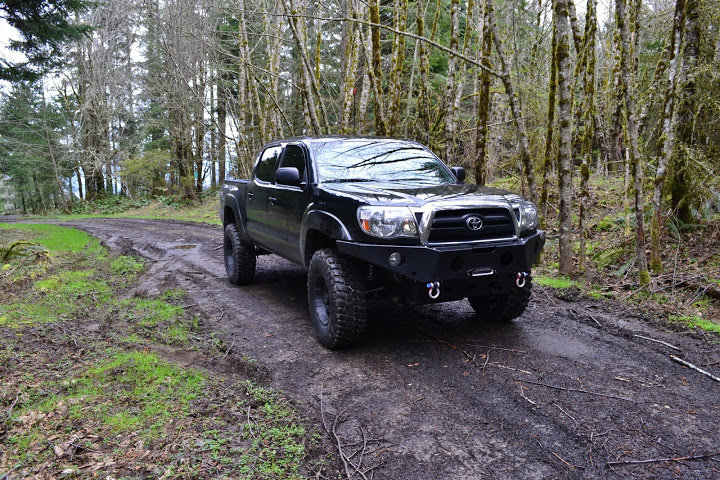

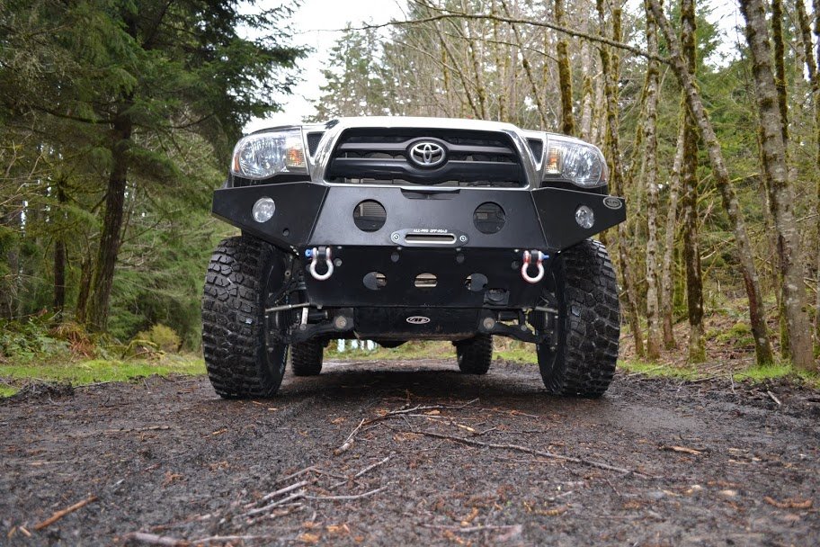

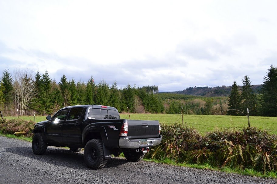

    Here's a few recent pics of my truck just for ref.
    Here you get a better idea of why UCA's are needed...
