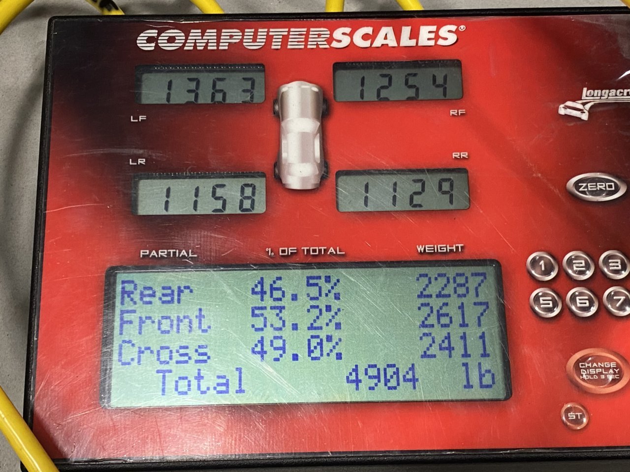

    Hitch weight will be calculated dry by the manufacturer with no battery or propane tank installed. I just went through this with a trailer we were looking at and had the dealership measure tongue weight for me.

    4904lb fully loaded in the trailer?

    That was just the truck with a full tank of gas. I just picked up my trailer last weekend and haven't brought it in to work yet.

    oh you mean your truck fully loaded is 4904lbs. not the tailer weight :)

    That was with 60 lbs of stuff in the bed of the truck. Not loaded, no passengers just a full tank and 60lbs worth of stuff I forgot to take out before I put it on the scales.
    To calculate payload you take GVWR - actual weight = payload. So in my case 5600lbs - 4904lbs = 696 lbs payload. If you add all of the passengers including dog we have 390 lbs. So payload once loaded with passengers and a dog is 306 lbs. Once we hook up the dry trailer we are already technically over GVWR but still under GCVW.
