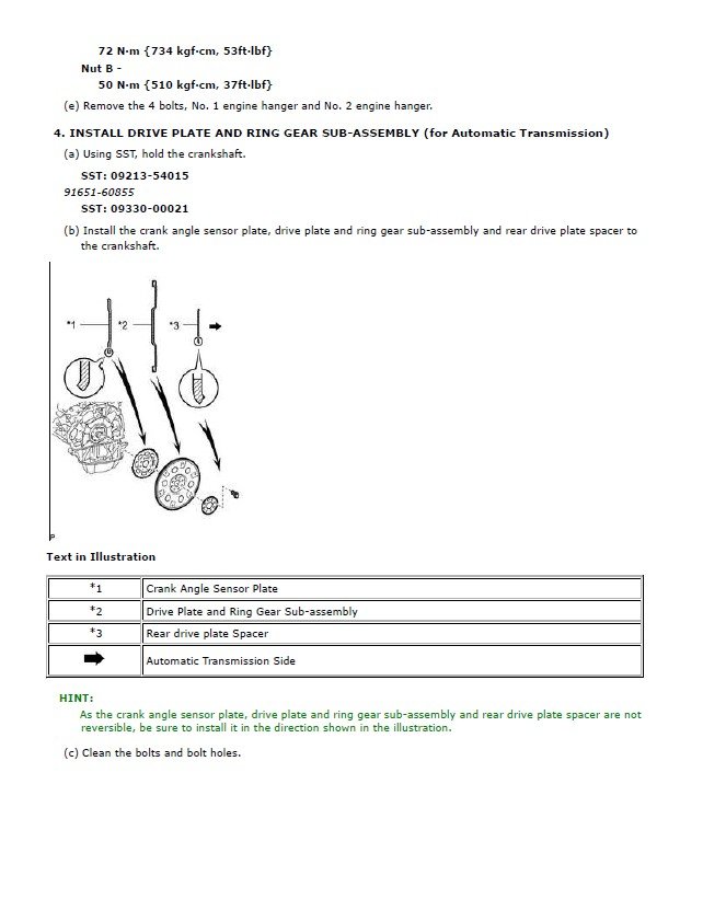

    You got me thinking about the "official" Toyota explanation as to why these CKP "failures" occurred in the first place. The documentation they sent to the regulating body detailed a lengthy investigation, in which excessive anti-corrosion coating on the crank angle sensor plate was suspected. The problem is, Toyota could not reproduce this failure, even after looking into suspected "bad" batches of crank plates. They also found evidence of scratch marks on the CKP pulled from customer vehicles.. in any case, their solution was to produce a revised sensor. Subterfuge? Maybe. I think I know why they went this way instead of pulling and replacing or modifying crank plates.... the darn thing lives on the outside of the block, held in place on the end of the crank by the bolts that also hold the drive plate (A/T) or flywheel (M/T). No oil bath for this sucker!
