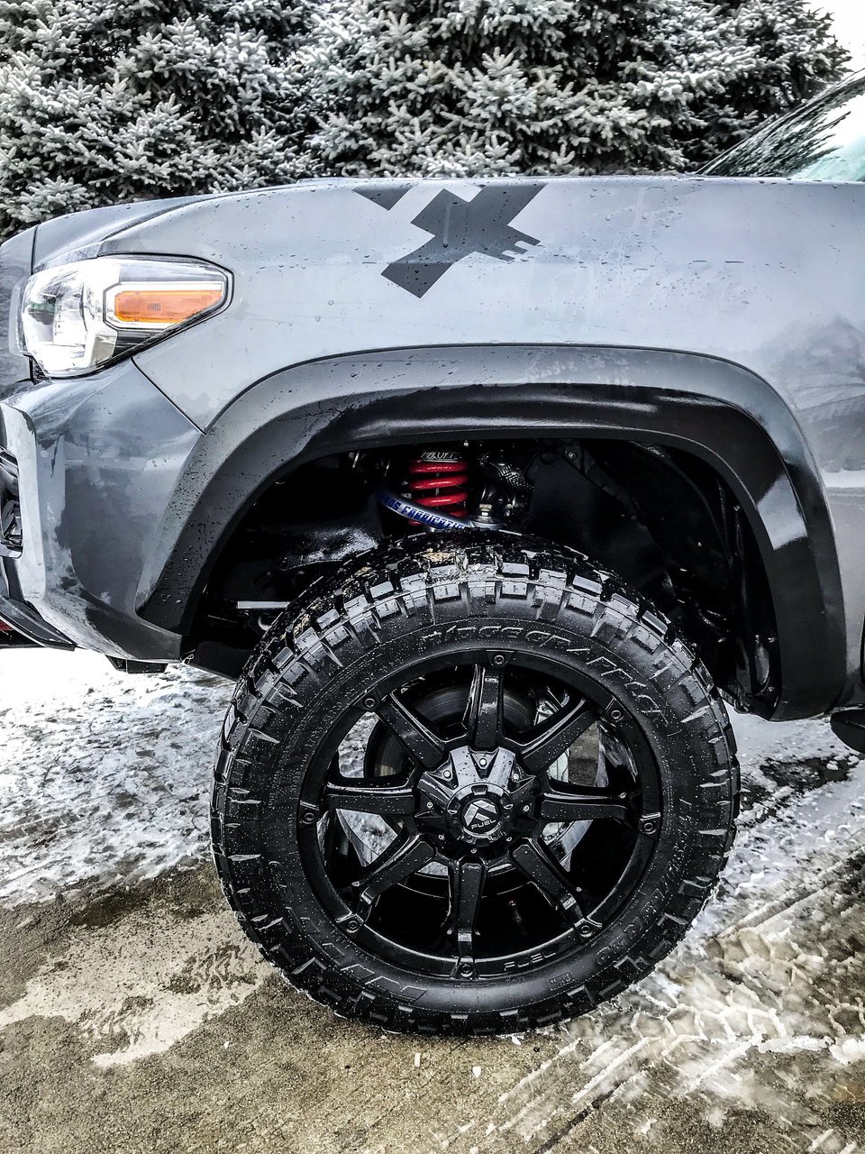

    Oh and the total chaos ones were the best thing I ever did. I now have about and inch and a half maybe smidge more room between my wheel and my uca and I have now added a three inch toytec lift. Dakar add a leaf and diff drop. Best ride I have felt in my truck. I am in love with this set up! 0F3A35E0-6705-491E-8C62-CB6AD92D7E72.jpg

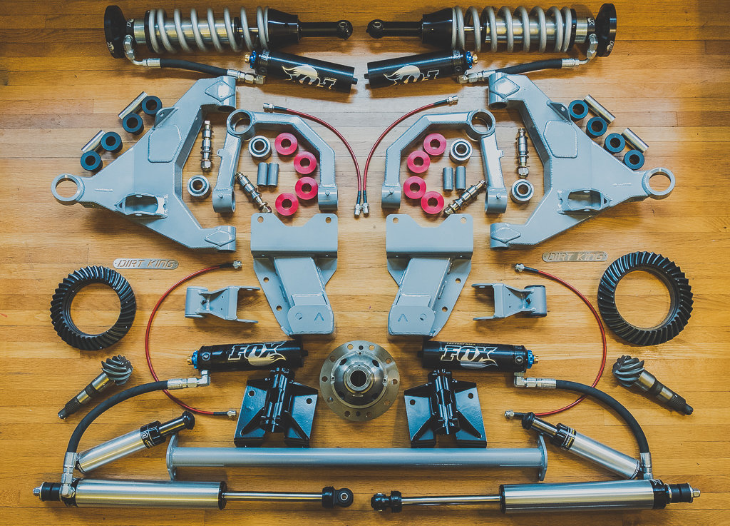

    My ride is super nice as well. Did this:
