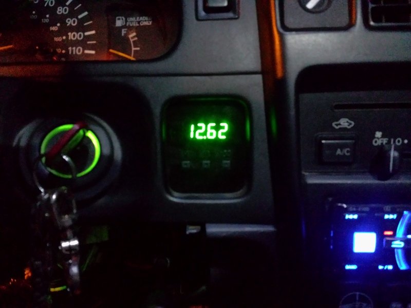

    Thanks for the write up, finally got it done today. Took all of 1/2hr and looks killer.

    Looks good! But whoa, I've never seen a taco with an illuminated ignition key thing. Is that a factory option or custom?

    No. I believe it is standard on Tacomas

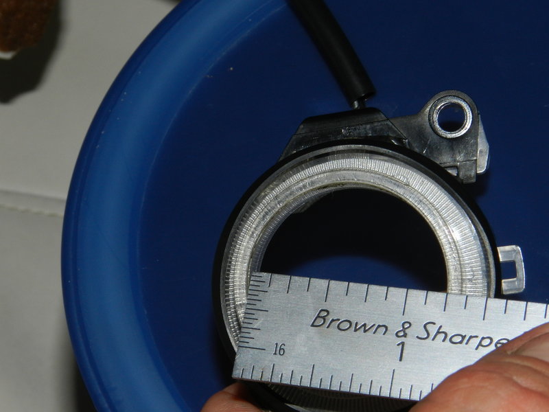

    Does anyone who completed this mod have any rubber bumpers they wouldnt mind mailing me? I lost one when thoroughly cleaning my new (to me) clock..

    Correct, the Camry definitely seems to be the most common vehicle to pull them from. I've pulled them from Camry, Corolla, 4Runner, Solara,(all from mid to late 90's and early 2000 models) etc models and they all have worked with a small bit of dremel work to the ring body. Just make sure you have a 1-1/4" OD key cylinder and pull or purchase ring setup of same size 1-1/4" ID
