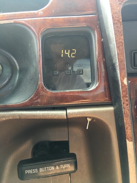

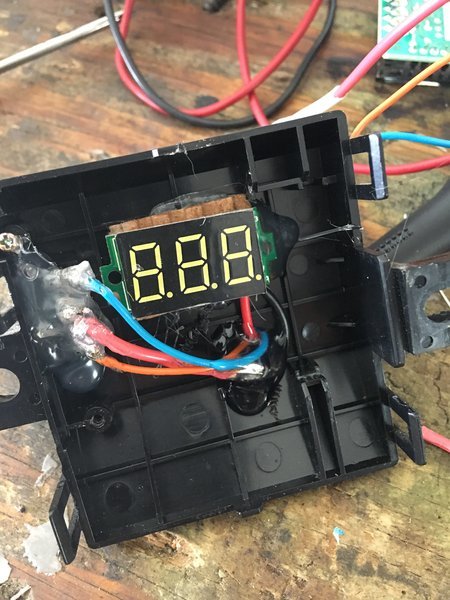

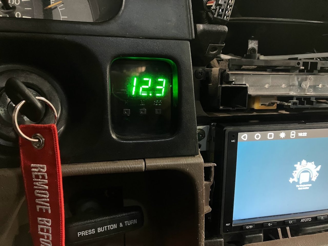

    Just did the same thing today, but the difference for mine was that I chose a white LED voltmeter, and I added a switch to add an always on and accessories on mode. The "always on" mode lets me see the voltage if the keys are in or not and the "accessories on" mode lets me see the voltage only when the key is turned to accessories or the car is on. The switch also has an off mode in case I don't want the voltmeter on at all. Here are some pics.

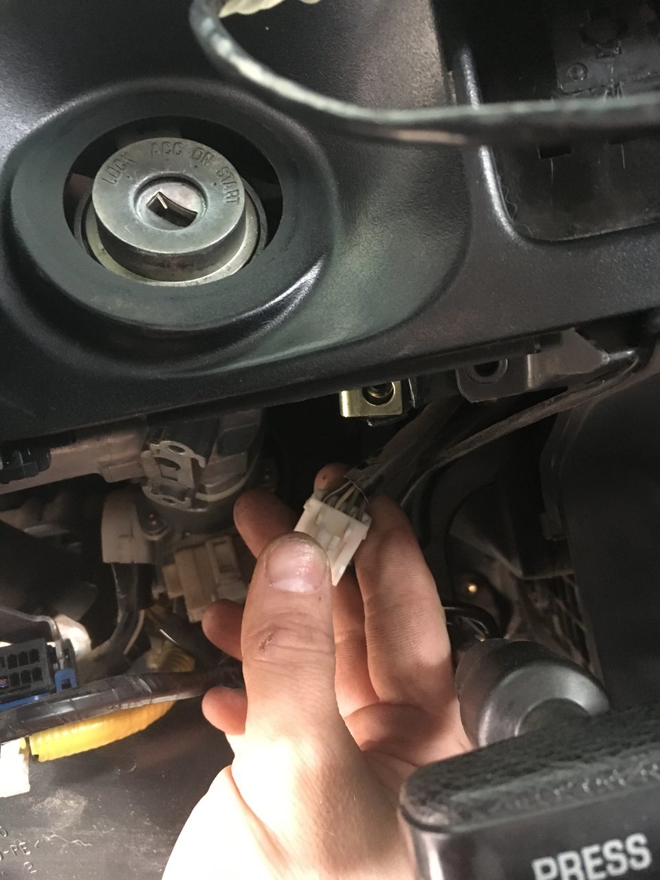

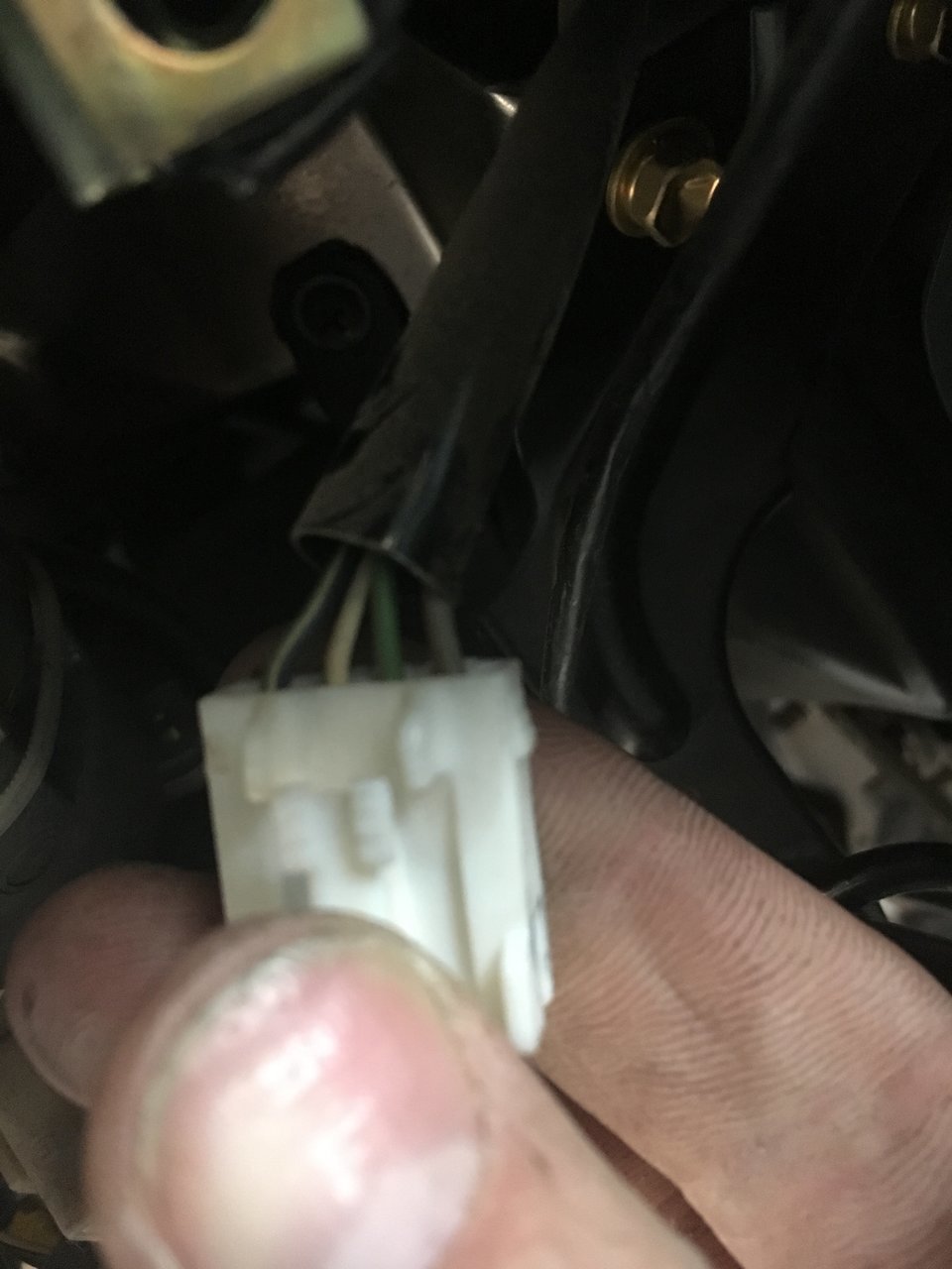

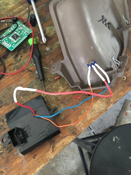

    Yeah! Mine doesn't actually have a clock in the casing. Just unused cutouts for buttons. I checked behind today while installing my stereo and saw that it had the harness that plus right into the empty clock housing.
    Hopefully these are the right photos from before. I thought I took one of it dangling out of the clock cutout today. Hmm...

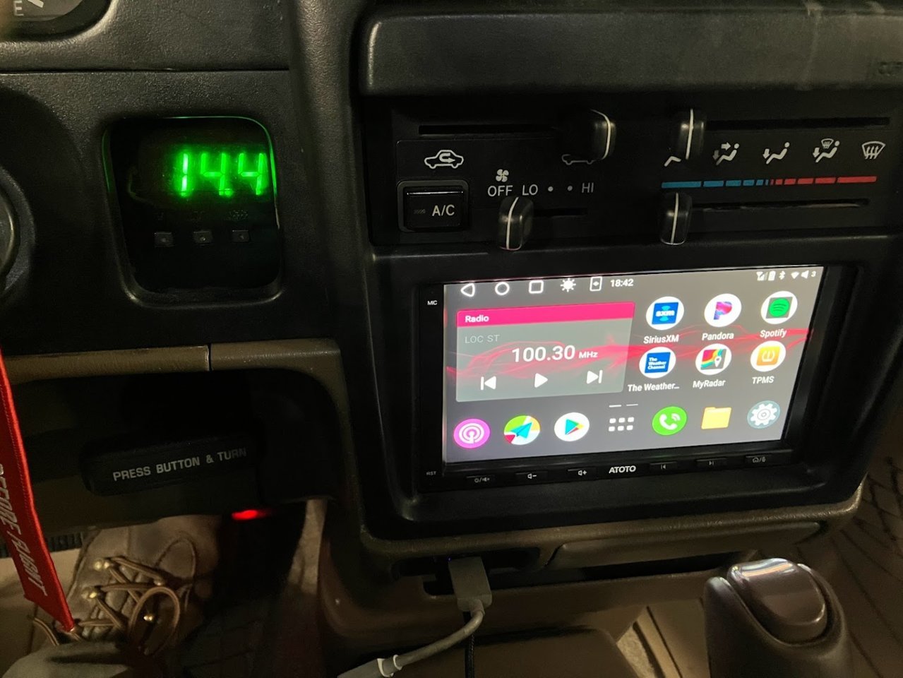

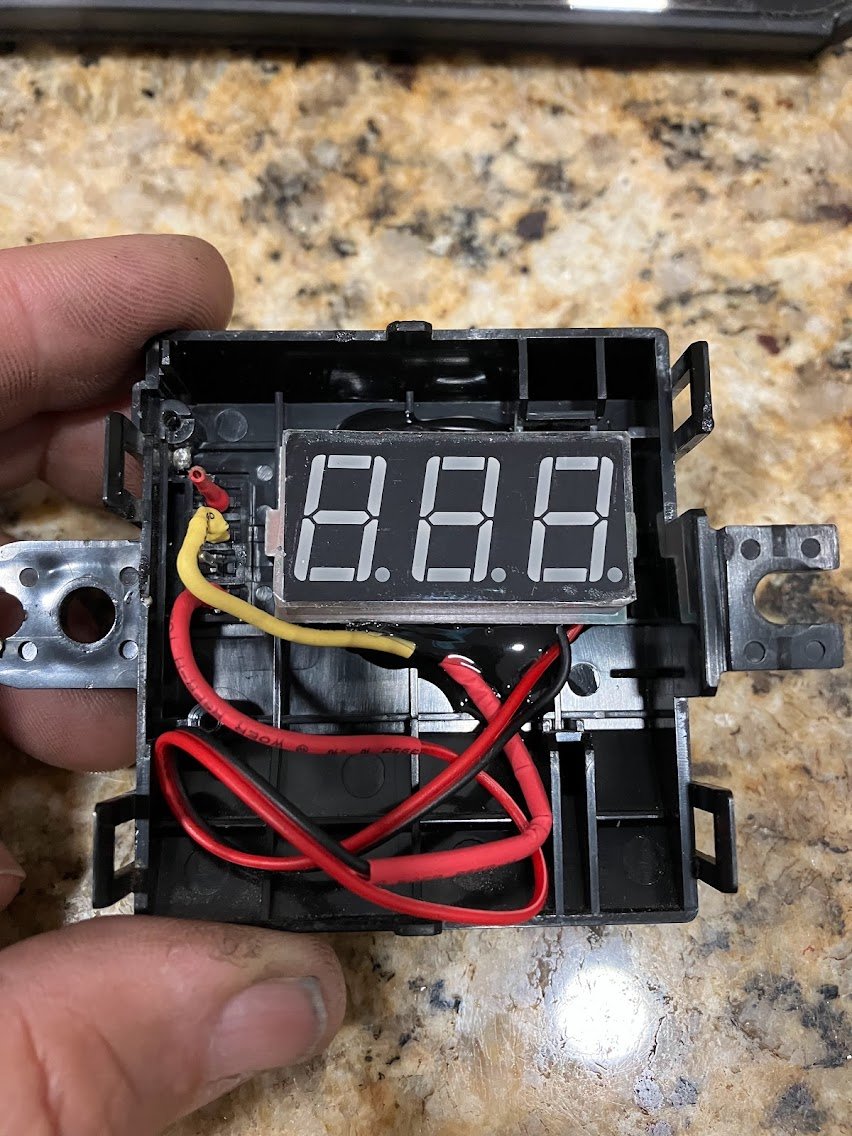

    You Sir, are Awesome! I stumbled on this thread looking for a way to monitor my battery voltage and said "Why Not?" I couldn't find the exact one you used, but did find this one which works just fine (https://www.ebay.com/itm/203938887981). When I first bought my '03 it was my first vehicle with a clock and thought it was cool. But after a few years of tinkering, disconnecting the battery, resetting, etc I stopped paying any attention to it. This utilizes that spot PERFECTLY! Thank you SO MUCH!!

    every 'bare' vm display i see online only has 2 wires not 3 like OP's

    This is the one I used, and has 2 decimals

    excellent
    is the only difference of wire colors is OP's is green and yours^^is yellow?
    (so black and red are the same as OP's)

    That is correct

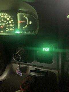

    Really awesome/easy/functional mod
    thanks !!!!!!
