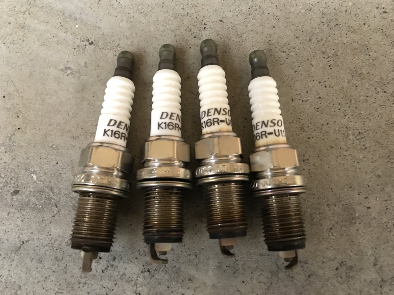

    Decided to do another how to write up since I started my 5 days weekend a bit early this year. I'd recommend changing out your plugs every 20k miles or 2 years (whichever comes first.) I went with the Denso instead of NGK this time. They should be $2.22 at your favorite local Toyota dealerships.

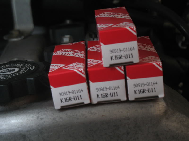

    (4) Denso (K16R-U11) - Toyota Part # 90919-01164
    Gap (0.040-0.041)
    Spark plugs torque 15 ft.-lbs

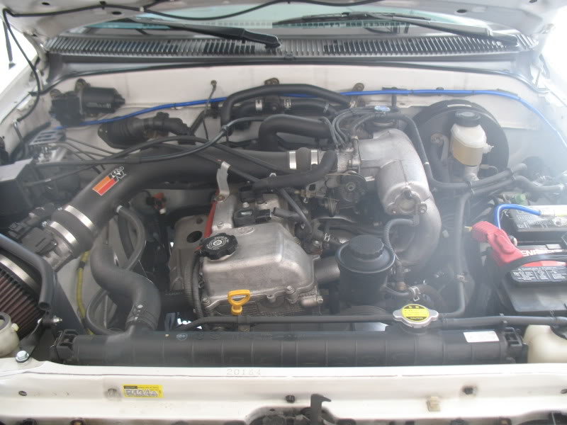

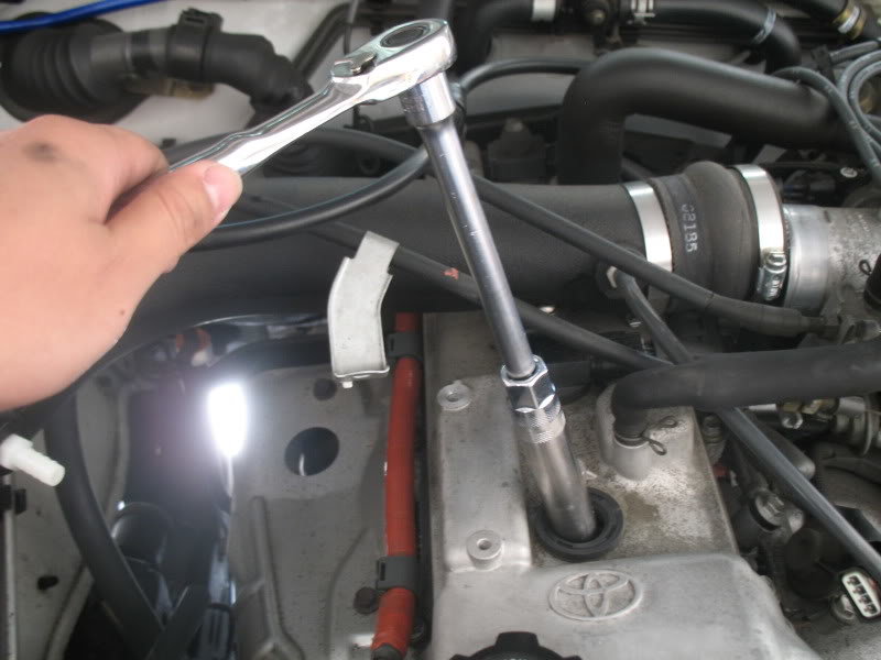

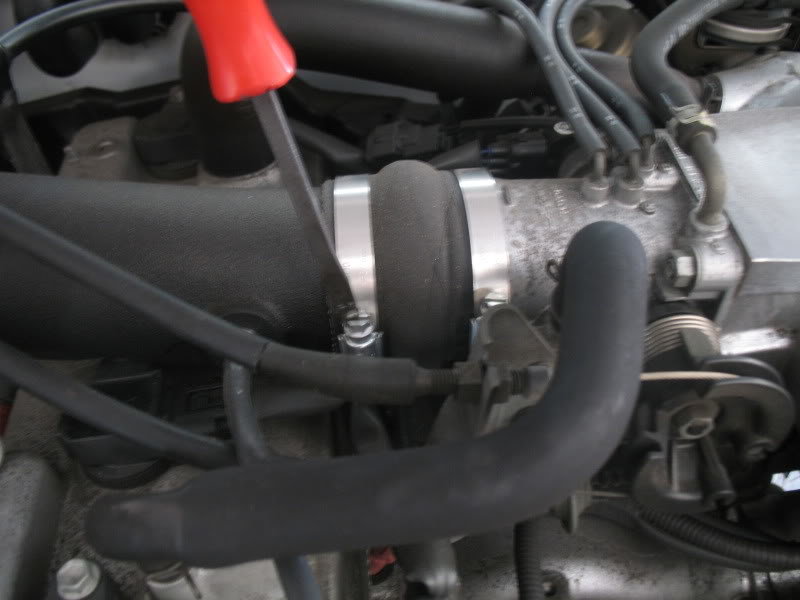

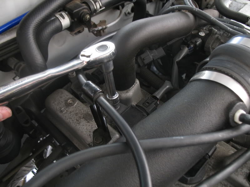

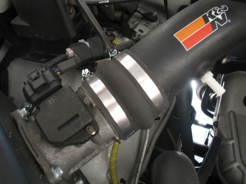

    1. If you have the stock intake, you might have to remove the intake tube to have more room. Those that have the K&N FIPK intake, you could just loosen the 4 clamps (2 on the throttle body and 2 on the sensor adapter) no need to remove the intake tube.

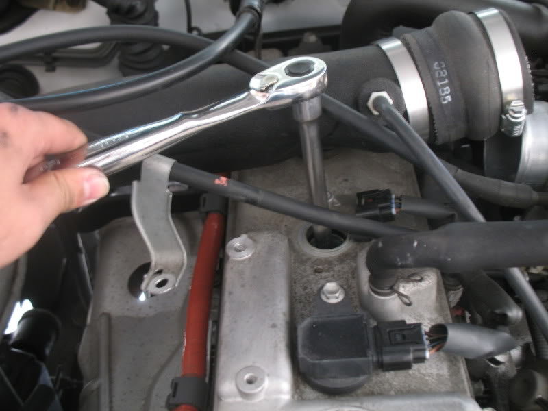

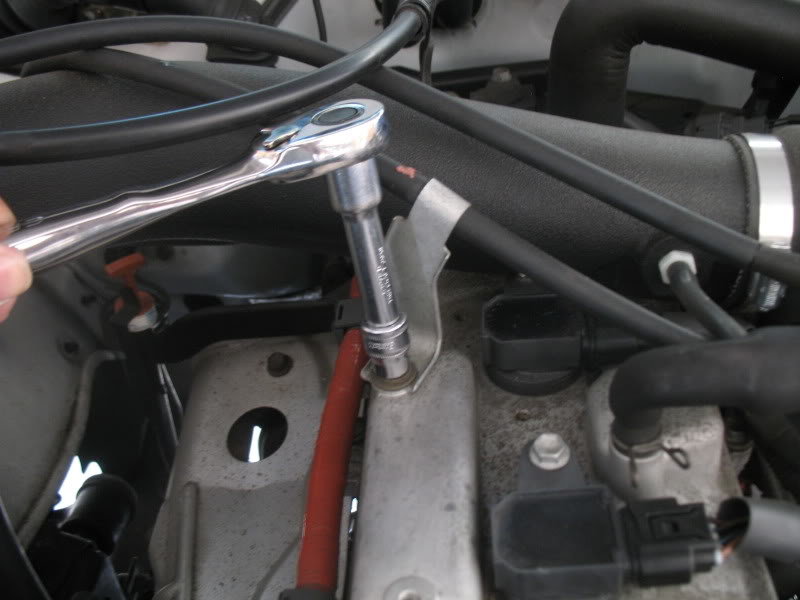

    2. Remove the 10mm bolt for the throttle cable bracket.

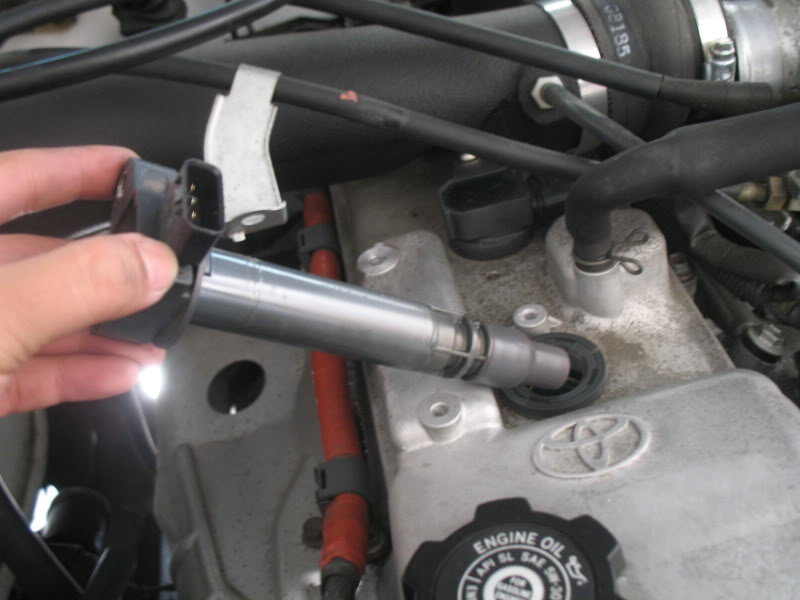

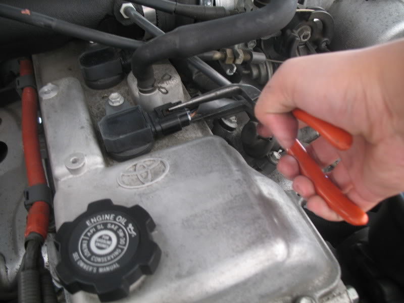

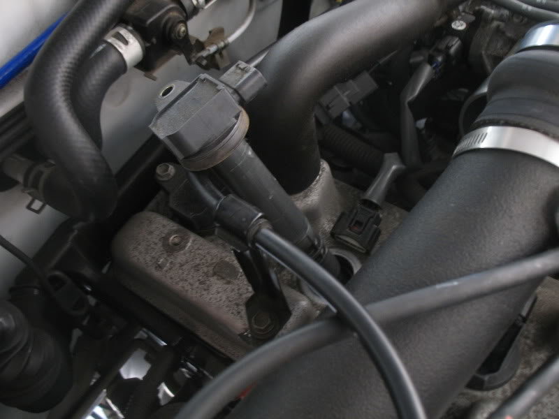

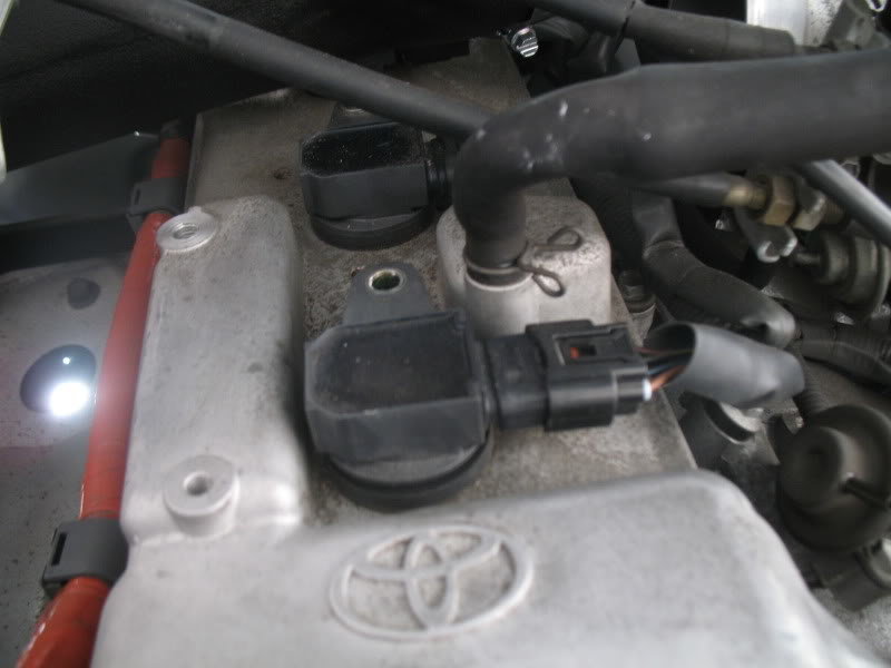

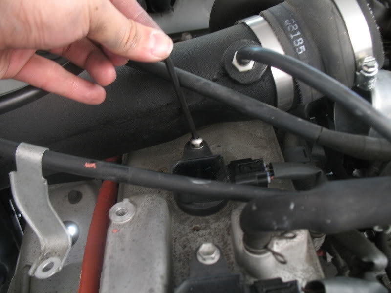

    3. Use plier to remove the clip from the coil pack.

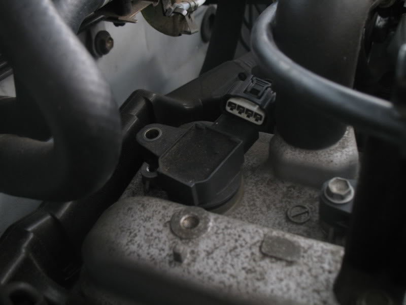

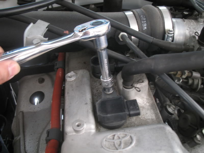

    4. Remove 10mm bolt holding down the coil pack.

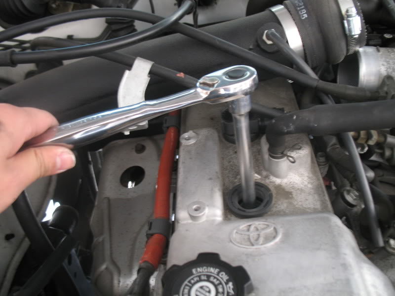

    5. Use 3/8" 5/8 spark plug socket and 6" extension to remove your old spark plug.

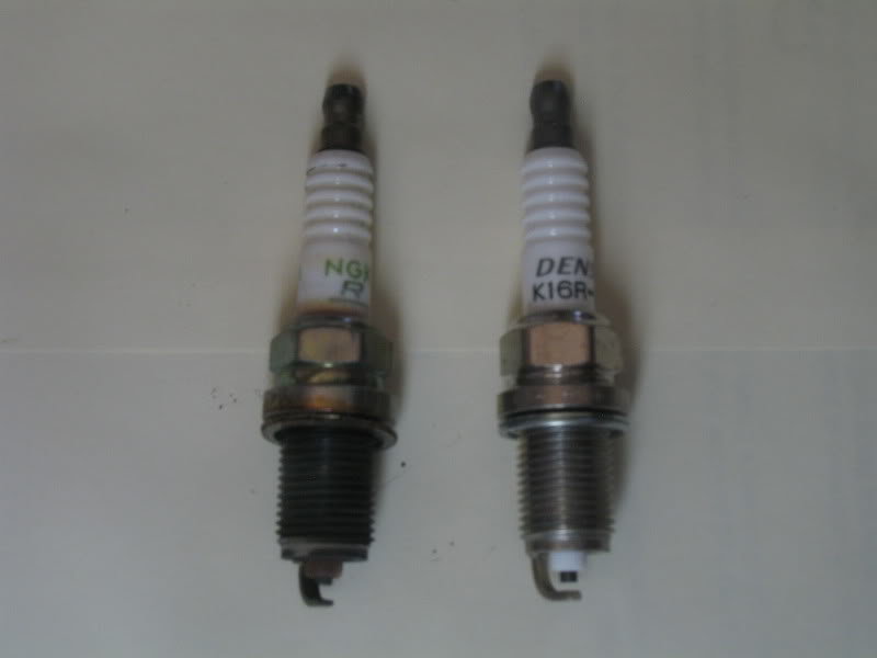

    Some comparison...check if your old plug is normal (dry without any oil, and not too dark.)
    Old = NGK, new = Denso.
    6. The new plugs are pre-gapped (according to the parts dept person) but I check to again to be safe. They're suppose to be 0.043 max. I have them set at 0.040-0.041. Sorry, I couldn't get a clear pic.
    7. Put some anti-seize on and reinstall. Torque it to 15 ft.-lbs.
    8. Reconnect the clip to the coil pack and make sure you hear a "click" sound.
    9. Reinstall the 10mm bolt on the coil pack.

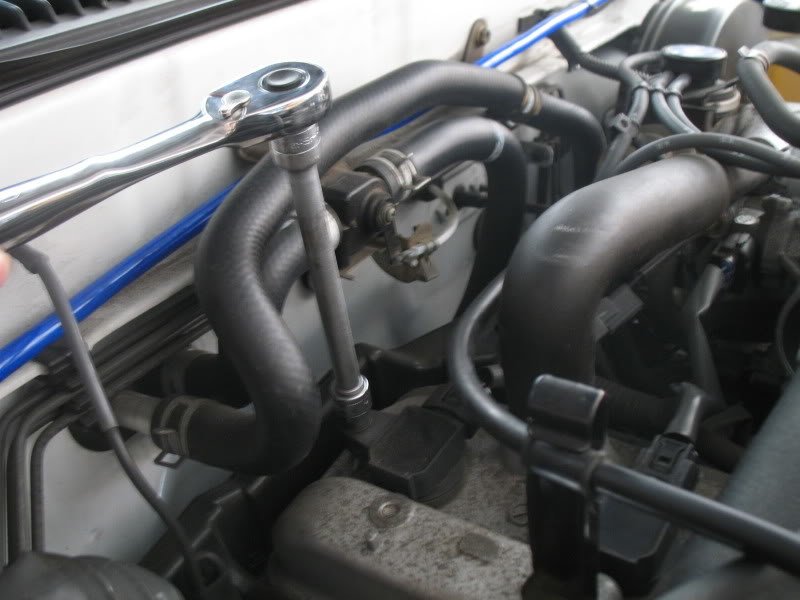

    10. Next cylinder #3.
    Same procedures (remove clip, remove 10mm bolt, remove old plug, check the gap on the new plug, put some anti-seize, reinstall and torque to 15 ft.-lbs)
    *Note: with the K&N FIPK, they supplied an allen bolt to have it sit flush and not rub on the intake tube.

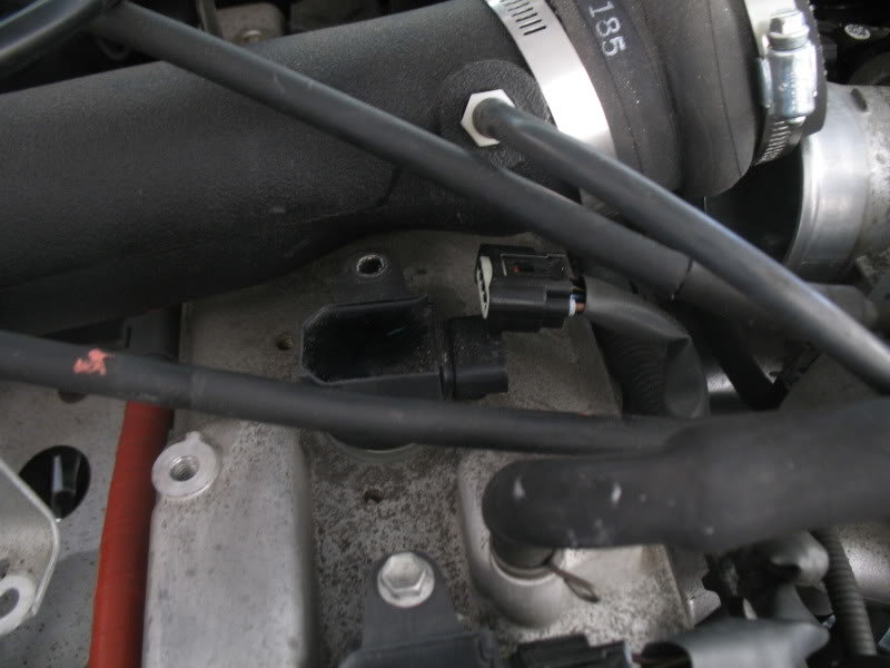

    11. Next cylinder #2.
    *Note: move the intake tube out of the way to reach the #2 coil pack (this is why you need to loosen the 4 clamps on the intake tube in the beginning.)
    12. Last cylinder #1.
    13. Recheck everything to see that they're tighten down properly and you're done. Easy 30 mins and $9 maintenance job. Happy early turkey day fellow TW enthusiasts! :bananadance:

    hello friend thanks a very good post I'm from Venezuela and here he brings that engine toyota meru really wanted to know which exact model is that K & N air intake I'd appreciate the info please!!! greetings from Venezuela
  4. Sep 28, 2011 at 10:55 AM
    The Parts Whore
    The Parts Whore [OP] Slinging parts since '03
    Oct 2, 2008
    #9649
    209
    K&N 57-9016-1
