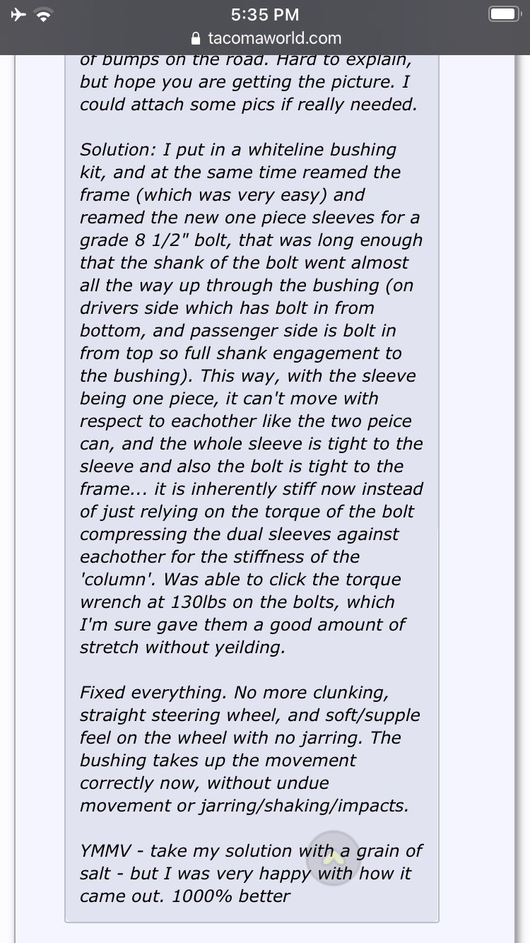

    I need help. I just replaced my steering rack with a new OEM unit. At the alignment shop they show me that the rack is shifting side-to-side by about 1/4"-1/2" when the steering wheel is turned (but the mounting bolts are torqued tight!). They were able to get the alignment completed, but the steering wheel shifts when driving (sometimes it's straight while driving straight; sometimes it's turned 30* while driving straight). What's going on?! My original rack didn't do this. Does the new rack not have steel bushing inserts? I didn't even bother to compare the bushings between the old and new racks before installing, but looking at the old rack I now notice that it has steel inserts. It's almost like the new rack's bushings are nothing but rubber and no steel washers or inserts. Did Toyota change the design of these bushings over time? Will new aftermarket poly bushing solve this? I'm really dreading pulling the rack again - it was an absolute bear of a job lying on my garage floor.

    It’ll go faster the second time. Unfortunately that’s what you’ll probably need to do. I would use white line bushings and ream the sleeves and frame to accept a grade 8 1/2” bolt with proper shank. The OEM hardware is sort of necked down at the shank for whatever reason. Still, that much side to side movement sounds excessive. Maybe you forgot to put the sleeves in? Something is up for sure. I believe OEM comes with rubber bonded sleeves, maybe you got a bad part. Idk. Disassemble and check.

    Thank you for responding! There wasn’t anything else included w/ the rack, so I assumed nothing needed to be added. Also, there are no separate sleeves shown in the parts diagram. I’ve since tried to tap out the old rack’s sleeves (if it in fact has sleeves), but quickly realized they’re bonded.
    I ordered the Whiteline bushings and will try to tackle this next weekend. I truly hope that solves the issue.

    Let us know what you find upon disassembly. Also, here is a slightly more detailed explanation. It is very good you got the white line bushings and not that energy crap but some modification is still in order to get it really good IMHO. C4E923A5-3156-45C3-89BE-96DF90B59675.jpg
