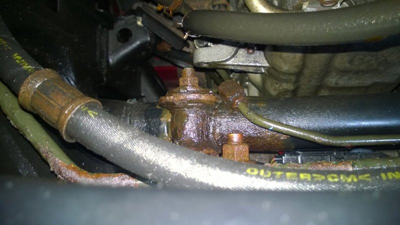

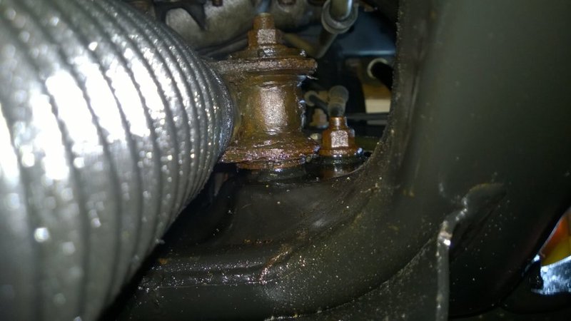

    So, my steering rack is spraying fluid all over the place. Looking at it, I believe the infamous PITA bolts are already upside down. My frame was replaced, and I suspect the technician slid the bolts in from below to make it easier for him/her. Can anyone confirm this?
