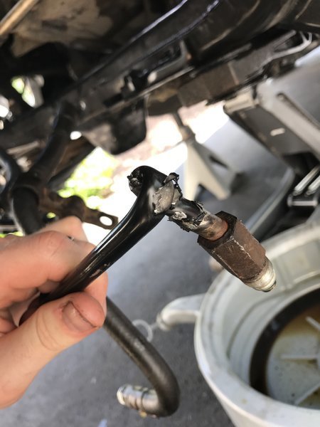

    I went with A1 and would do it again. As far as lines, when I was removing mine, I mangled the shit out of my high pressure line. Toyota sells both feed and return lines as one unit for around $230. I was able to buy just the high pressure line from Napa for around $80.

    Was wondering the same thing about the bolt being cut below the AC pump... and don't do what I did..spend hours trying to get rusty lines loose where they hook up..cut them and order new ones from RockAuto for $83 ! Now I jus hope I can get the old unit out and the new one back in without doing all that extra stuff... here goes!

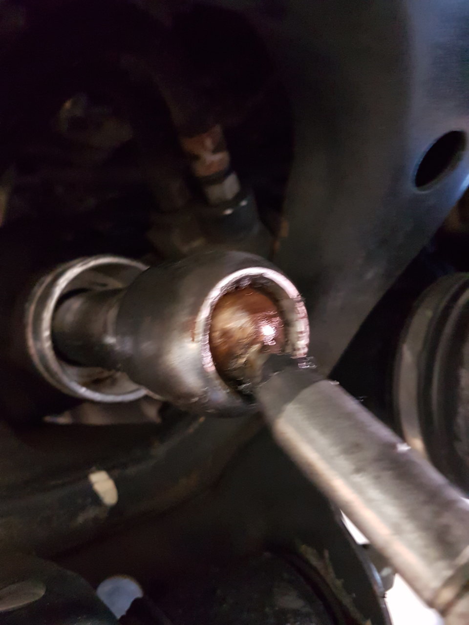

    UPDATE ** 5 years later. Still going strong. No fluid leaks. It hasnt given me any problems. However I did replace the outer tie rods twice since then. Also , I was having a clunk sound when turning one direction. Only briefly. Pulled the boots off to inspect the inner tie rods. There was definitely a difference between one side and the other. Some slight play in one of the inner tie rods when loaded axially. Noticed about 6 months ago. Hasn't worsened yet, but only a matter of time before I have to replace the inner tie rods. Whether you should replace the inner tie rods from the beginning is up to you. The inner tie rods may not be OEM. However you can buy inner tie rods of high quality.

    Looks like you have a torn CV boot
