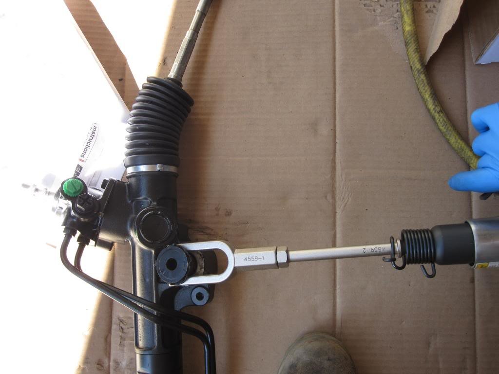

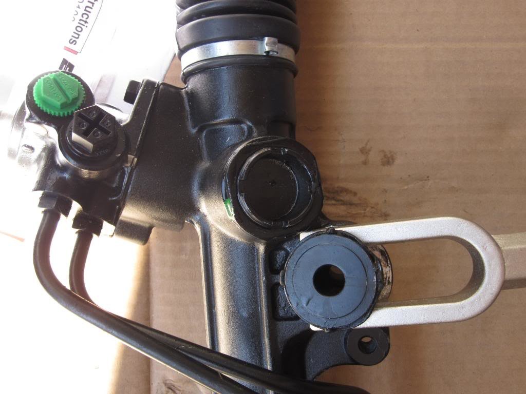

    @Dr. Sleep @EatSleepTacos
    Question, does the metal collar come out of the reman rack too? The rubber came out like a bitch...the metal stayed in. It appears in your photo above that the pickle fork is under the metal too...
    I have the exact same R&P part number and ordered the exact bushings (which was a 8 piece set, 4 poly bushings and 4 metal collars). Assuming this is them https://www.energysuspensionparts.com/8.10106
