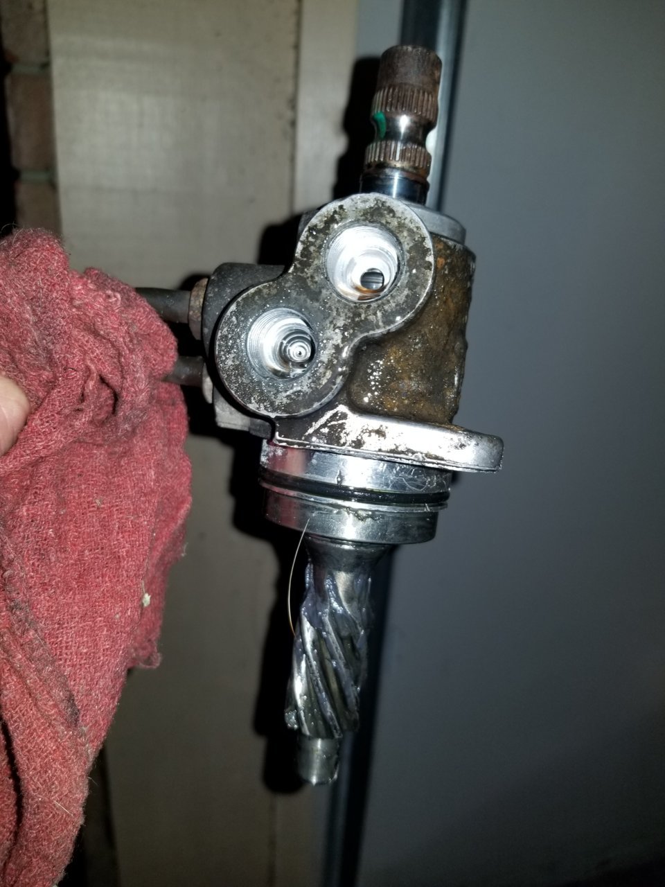

  16. Mar 17, 2019 at 8:15 PM
    #136
    Normonky
    Normonky Member
    May 13, 2015
    #155213
    16
    Scott
    Beast from the East
    2006 Tacoma, V6 4x4, 3’ lift Post frame recall swap 16 inch FN five star wheels
    Behold, the head of the beast. Unfortunately this was the only way I could come up with to salvage the return line
