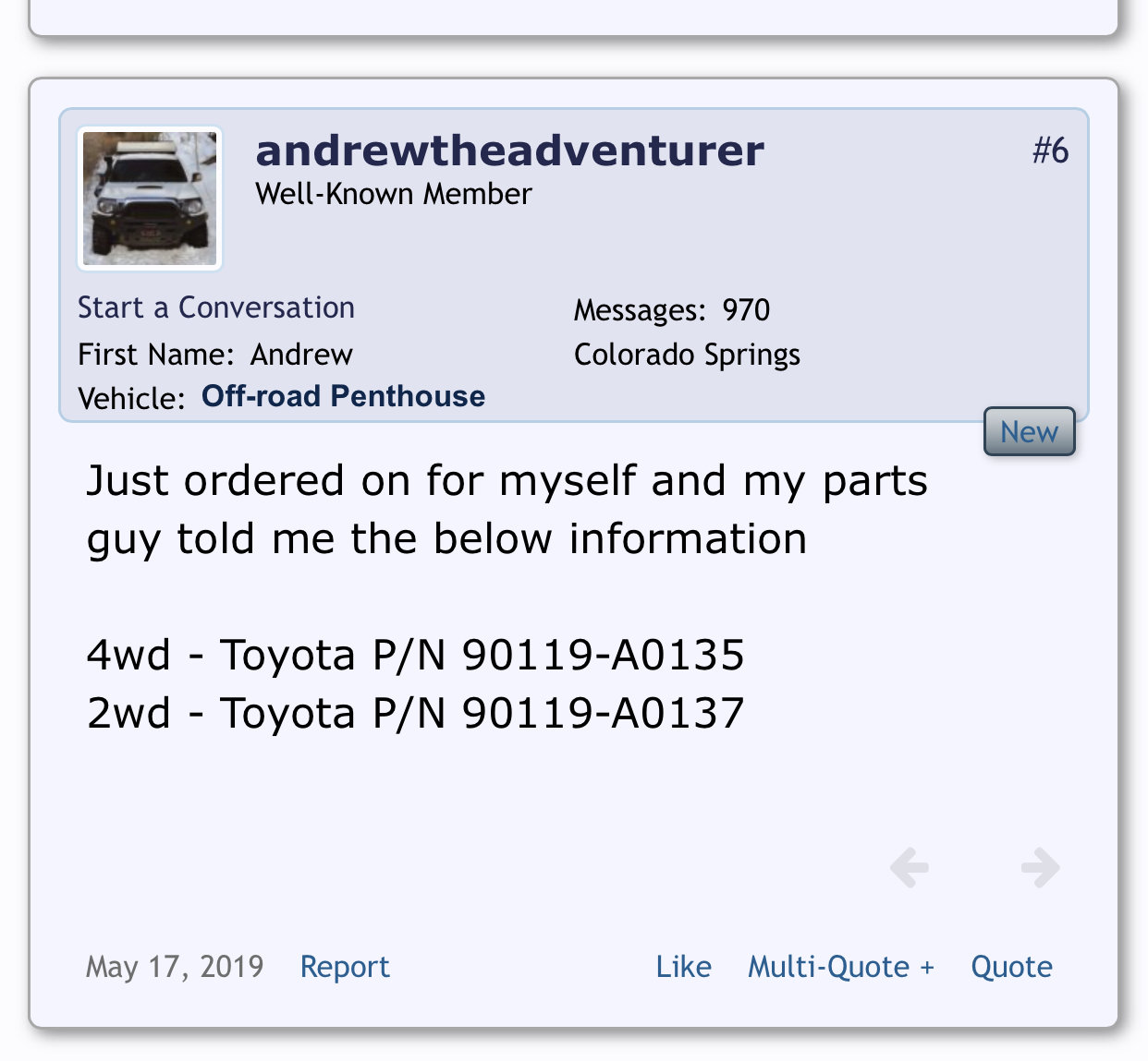

    Awesome. Fingers crossed I have the same experience. Although, I’m still having trouble confirming which bolts I need... I know there are two different lengths and the dealership website tells me neither one fits my truck. WTF?

    I used the 4wd bolt. Exact match

    Perfect. I just ordered two of those, two of the nuts, two of the outer tie rod adjustment nuts and the three mounting bolts for the power steering lines. I already have the new rack, energy suspension bushings and new lines. Now I just need some pickle forks and I’ll be good to go.

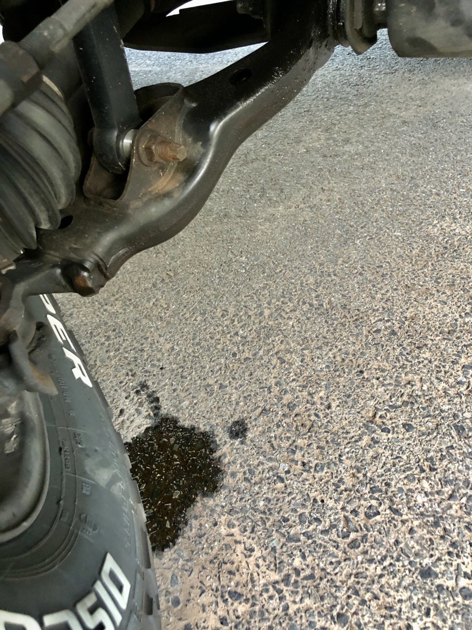

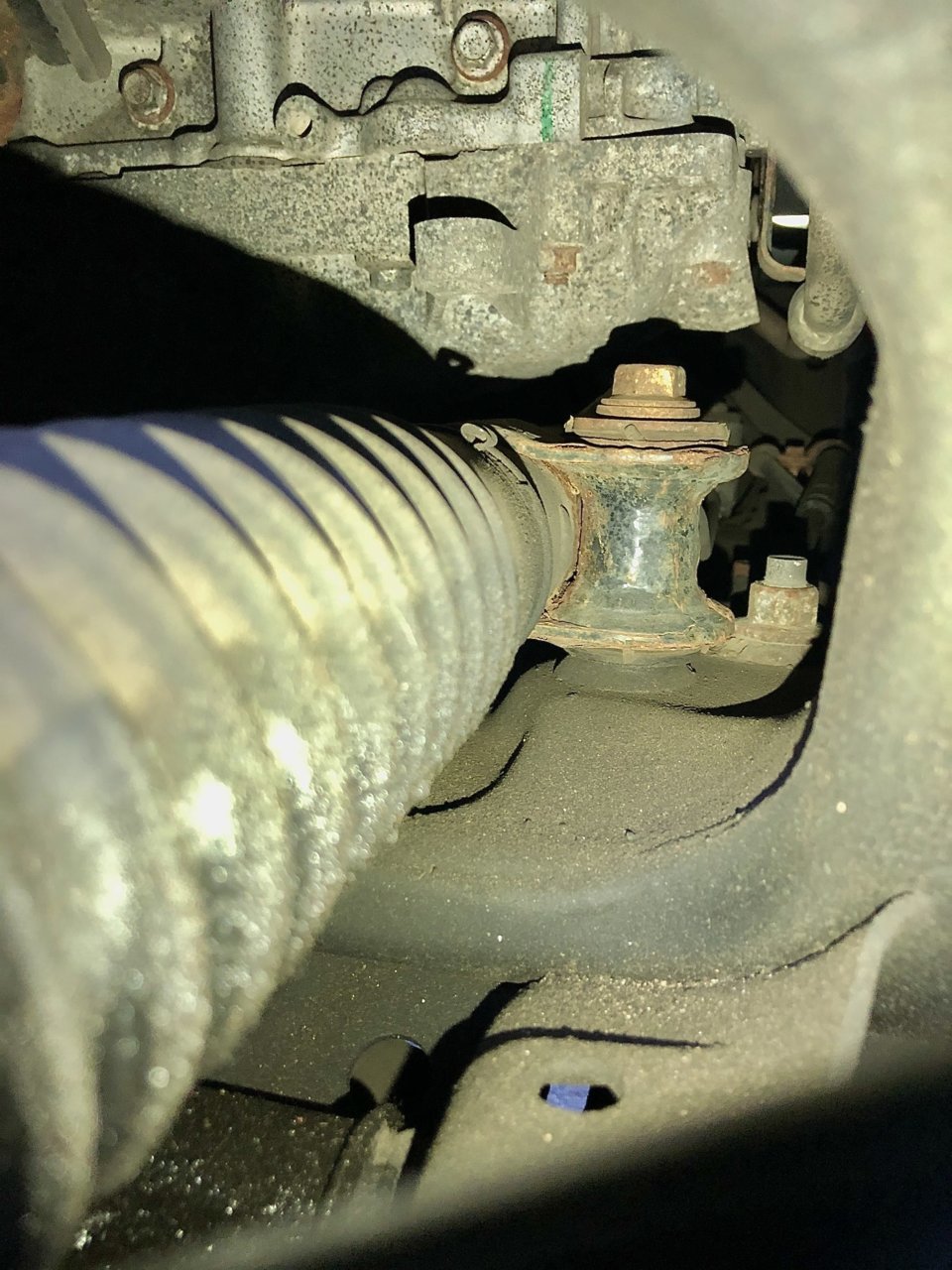

    I guess my truck wanted to give me another quarantine project. After going outside last night to throw some anechoic pads in the front doors (won from secondskinaudio), I noticed this....
    My initial thought was...that's not from my truck. But then common sense took over and realized how fresh it looked, despite the strange location of the spill. Upon further inspection, noticed the fluid dripping onto the LCA and down from there....
    Pic of passenger side and bushing for fun.
    I know a lot have gone w/ the cardone, but I may just get new OEM. It's about 600 for the assembly w/ new outer tie rod ends and bolts.

    Anyone figure out why the rack leaks but the resi doesn't drop? I have the leak in mine that I posted up there but my reservoir fluid is still in the same place. Hasn't dropped. o_O

    You quoted a very old post of mine. My PS pump had failed (hence no hydro assist until I replaced that) and while the rack end seals may have sprung a minuscule leak the moisture/grime buildup on the bottom of my inner tie rod boots was actually residual lube from servicing my uniball UCA’s.
