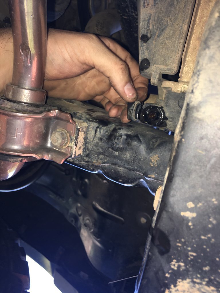

    Step three - radiator: the initial drain will start on the radiator. On the driver-most side of the radiator there will be a funky hole with a wing style screw directly behind it. Turn counterclockwise, let it drain. Photo attached to the thread.

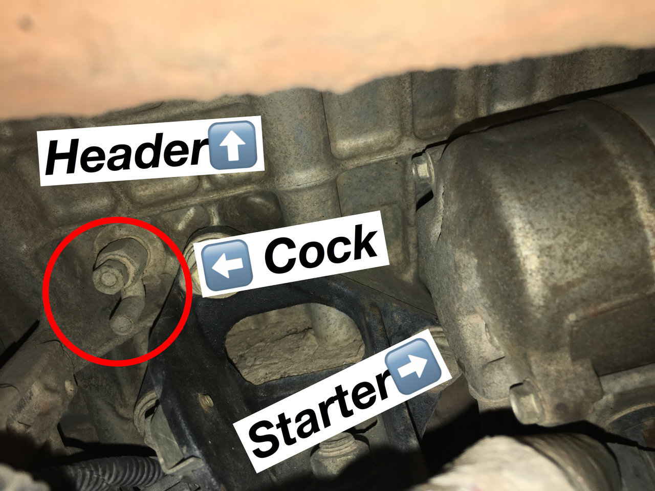

    Step four - Passenger side: after that has drained, move onto the passenger side. remove the splash guard. Right in front of your face there will be a drain cock with a nut on top. Take your tube and slip that cock inside your tube. The 1/4" tube is pretty tight. You might want to lube up before slipping the cock in, I went in raw myself. It just took some extra work.... okay enough of that. Take your 10mm and loosen the nut counter clockwise DO NOT REMOVE THEM ALL THE WAY. STOP LOOSENING THE NUT ONCE COOLANT BEGINS FLOWING. Allow flow to stop, tighten the nut back up. Photo below labeled step four.

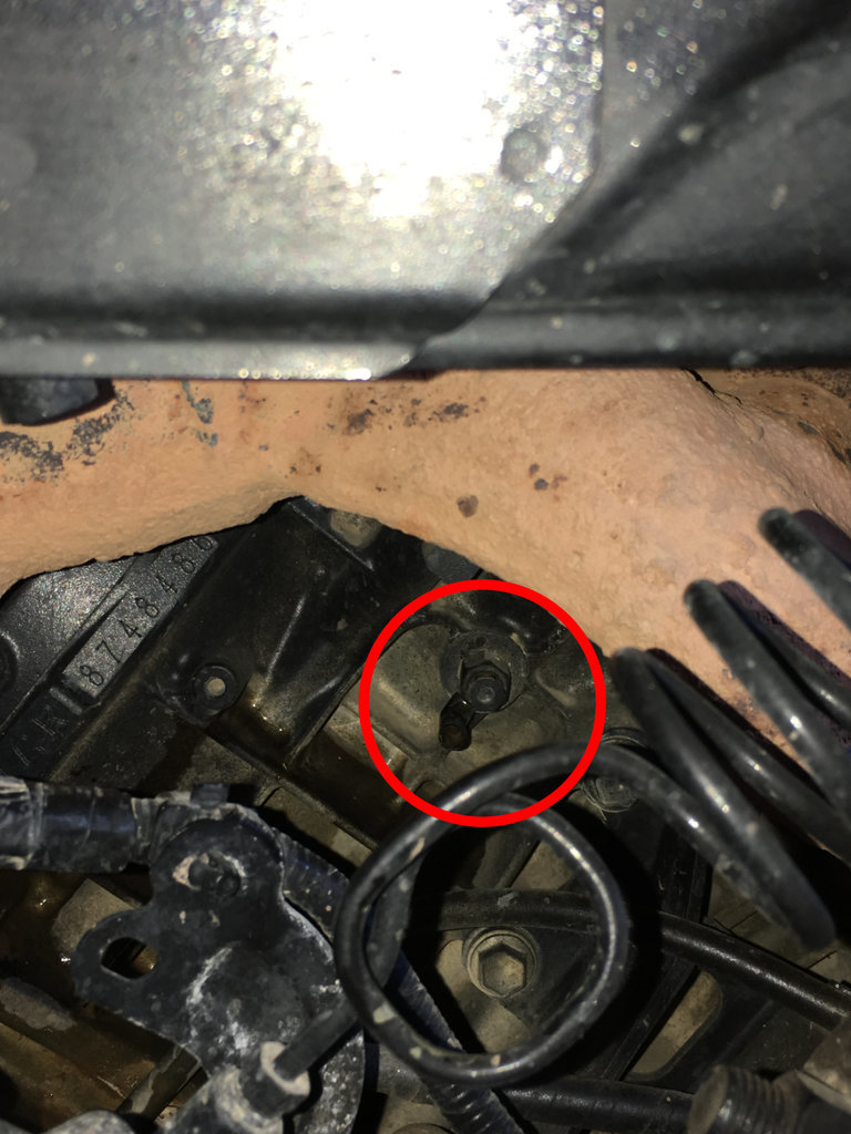

    Step five - driver side: this is proof satan exists. THERE IS A THIRD DRAIN. It's in a similar location as the other one. Repeat step four, loosen(not remove), allow drainage, tighten. I will say this would be slightly easier had I removed the wheel. Remove splash guard. First, visually locate the cock and nut. Work your hands in to the right of the shock tower. Feel around until you find the cock, then slip your tube over it. Now.. if you have your body contortionist, put he/she/it to work. If not, take your 10mm wrench and try to place it on the nut. I used my line of extensions like a lever and used that to push on the 10mm wrench to break it free. I later found that a ratchet with a 10mm deep well works great if you can get it positioned on there. Also, one can perform a reach-around method and go up through the path of the exhaust and reach the drain to try it from a different angle. This part sucks. Be patient. Have fun. Drain. Tighten. Done. Photo below.

    Photo for step four

    Photo for step five
