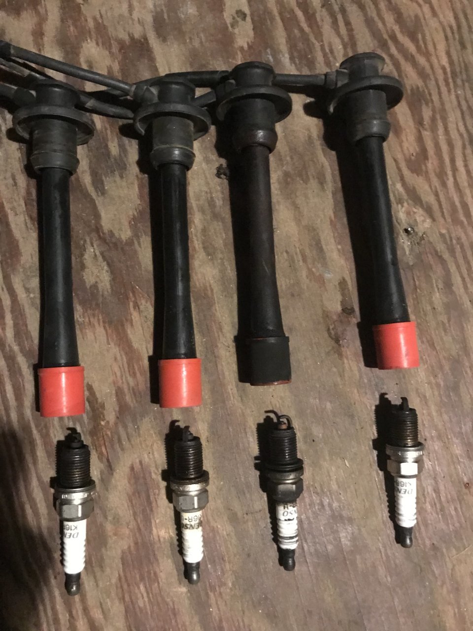

    Just changed my plugs and wires on my 2.7L due to a misfire on cylinder 3 (P303) and found that the cylinder 3 spark plug was super loose like not even hand tight and found a bunch of oil old oil and debris in the spark plug well. I’m hoping I’m pretty safe to assume that the oil has just blown by the spark plug and that it’s not something like a piston ring instead. Anything else I should check for damage due to the loose spark plug? Threads in the head seemed fine threading in the new one. Any advice is appreciated.
    side note this is a super easy job if you have the DLS it’s not really any different than if you have a distributor and if you look carefully the Denso coil packs are labeled as to which plugs go where.
    Cheers!
