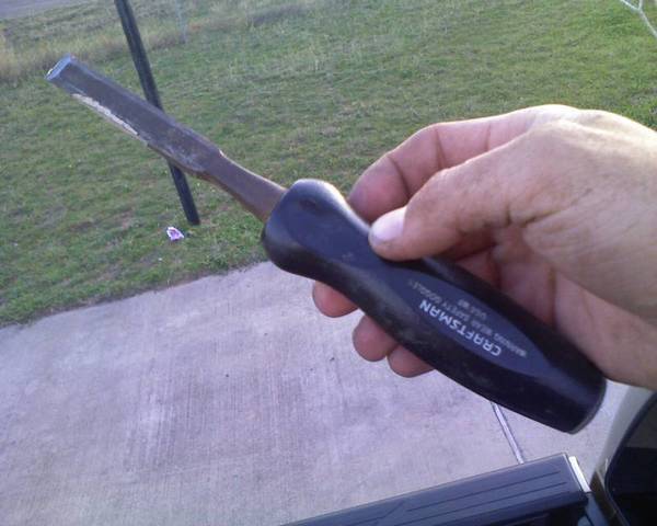

    A towel or cushion of some sort

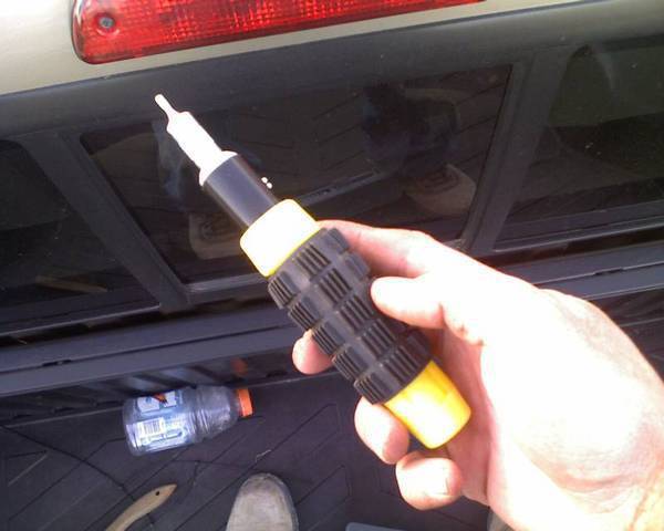

    A number 3 Torx Bit
    A Chizel
    So this is a little more difficult then your tail lights... because its sticky...
    Only 2 Torx screws hold the light in.
    Now use your Torx bit and screw driver to remove them torx screws.

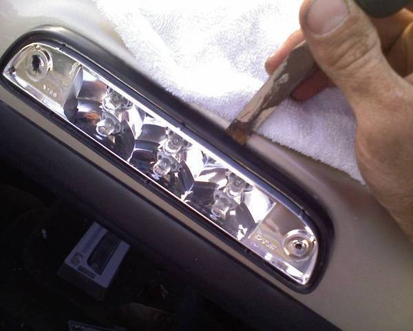

    You now need the towel(cushion) and chizel.
    You have to get the chizel behind the light and wedge it out all the way around. Its stuck on their pretty good so work it all the way around. Make sure you keep the towel in between the chizel and the truck!

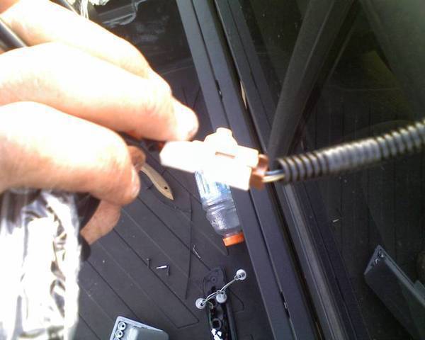

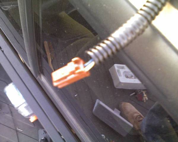

    Now its out unclip the harness.
    Now that the old brake light is out. Remove all the sticky stuff that was holding it on. I just peeled most of it off with my fingers, the foam is the main part you want off so that it doesnt get in the way of the new foam on your new light.

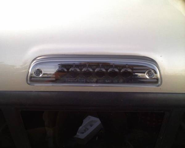

    Now connect your new light.
    Remove all wrapping and that is on your light. And remove the backing that was keeping your new foam from sticking to stuff prematurely.
    Line the holes up with the old screw holes. And put the old screws back in.
    Make sure the screws are tight. You won't have to worry about over tightening them due to what they sit in. If you over tighen it just slips back. So if it does happen just re tighten to just before that point.

    cool. you got any night pics?
