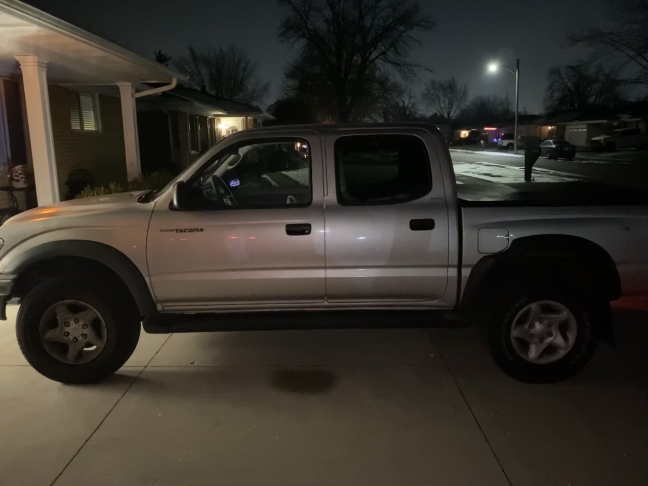

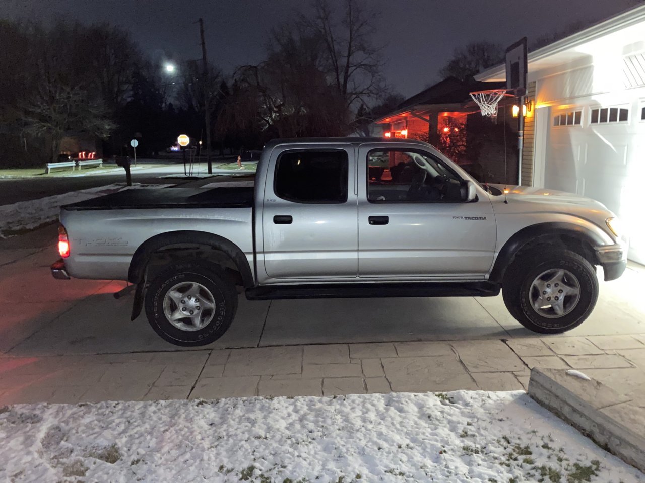

    E338FB77-A894-4937-A9DC-0AA5379B4D0F.jpg 0E475439-D385-4986-8973-2DB897A143D2.jpg

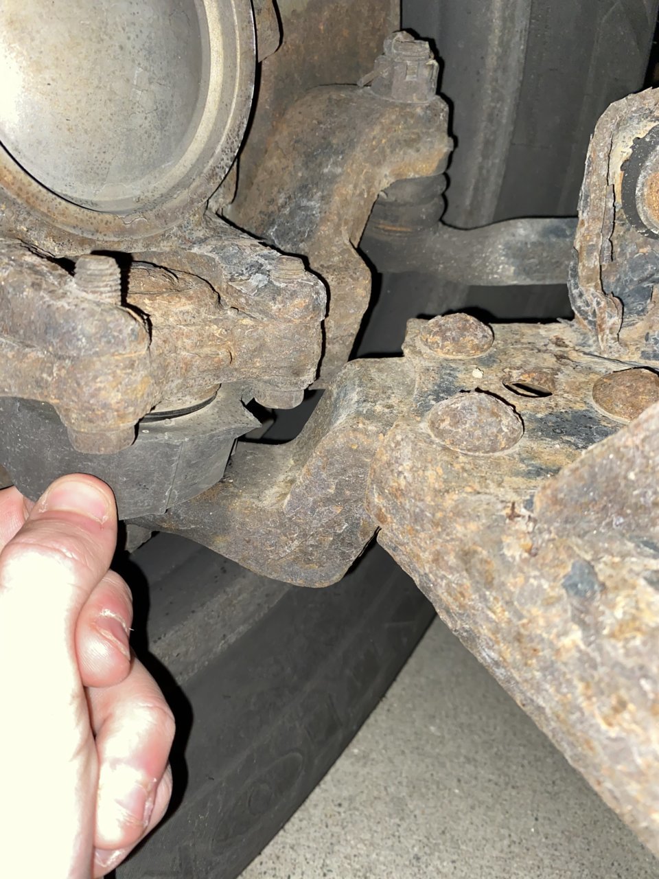

    Thank you! I just crawled under there to do a quick peek because I have no way of raising the vehicle from where I’m at, and I need to take it somewhere for work tomorrow.. I found what looks like a rubber cover that broke from one of the screws holding it in. Should I be worried? I don’t know if this is from today or from far before today. It more or less drives like normal, no new play or new noises that I can confirm after driving a couple hours.
    this is the side that hit the curb, I’d say I hit the curb at maybe a 30-45 degree angle from the road looking forward.

    That's just the dust shield boot around the lower ball joint, it's common for them to break off over the years. Not the end of the world, just helps keep debris from puncturing the LBJ boot
