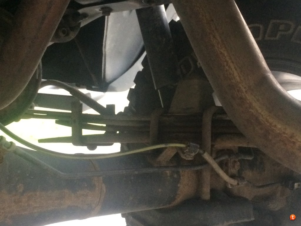

    Yeah, I have an AAL in and it only makes it more obvious how shot the stock leafs are. Not a huge deal as the AAL real cheap but soon I'll be replacing the entire leaf pack with chevy 63s. Dakars get a lot of praise too, if the chevy springs weren't so cheap that's where I'd go.
    I'm not trying to sway you from the AAL, it will give you lift... Just don't look at your leafs after a dew thousand miles with it in. ;)

    Most people usually swap the front springs as well but the billies will lift it up to 2.5". Let me snap you a pic of my leafs just so you can see what in talking about. I'm not saying don't do it, just letting you know it isn't ideal.

    It's a little hard to see the extent of it I. The pics but the stock springs are kind of S shaped. The AAL is clearly the only leaf with any shape left in it.

    The AAL is second from the bottom. Bottom is the overload.
