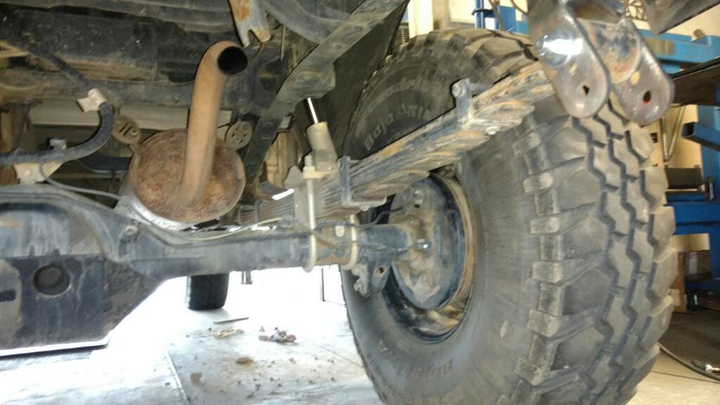

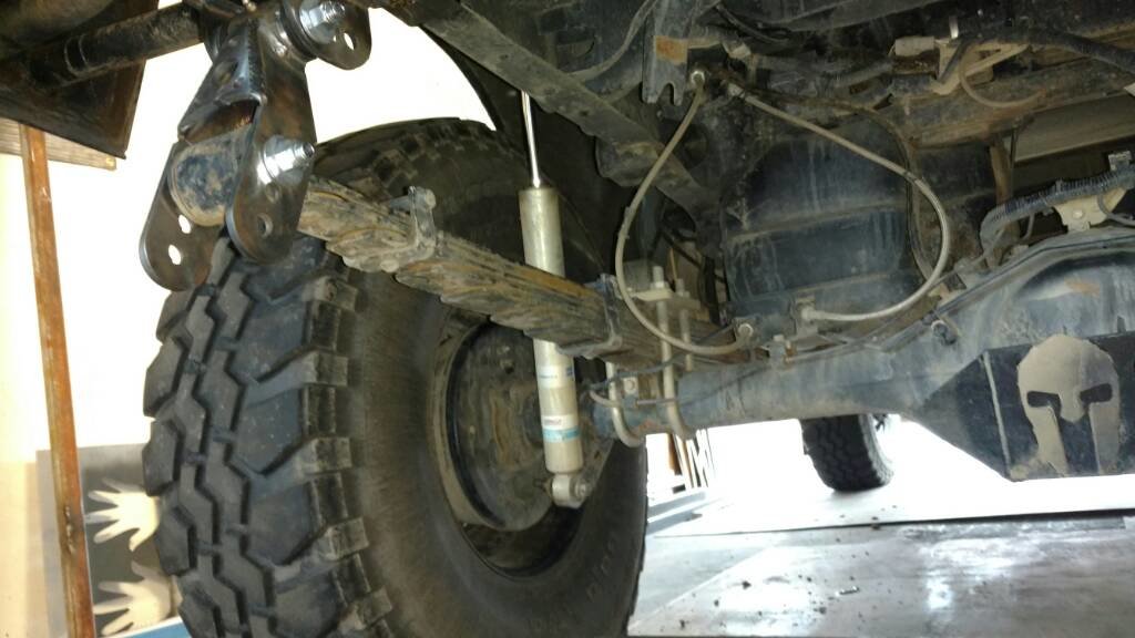

    How are these leaves at handling weight? I'm currently running Allpro Expos but I carry so much weight in tools, RTT, 37" spare ect that they are pretty much flat. I just did a shackle flip today and my ride height is finally correct but these springs have no up travel before going negative. I have a set of 14" travel King Remotes waiting go on and I'd like to fix this problem while I'm at it. Would a 63" ;igt spring help? I'll upload pics from my phone in a second
    40d88de9973ac71b44f904f021e4d144_69b56f0780c392bd7c4add0f51ccd977523febc4.jpg12ced7092bb64c4935879ec789da461a_4a37e5e7cd1d5873c08e145b29fa40ab52eeaf27.jpg384fbc933ca3374cde9a06088586e5da_0b815c410a0cc28e1a983a0ff3ba00d48d3dcf81.jpg4453170120f384ccc28a32608bf2721c_0ff482b4f26e45517ea9e74c38039a11ddc40419.jpgd2f738c545ecde7ed1ed2026d5100a69_77a157d387286ee9be14763f75989de528ad7137.jpge8428eebc37601921f76b2f533266c63_bd15b93d54e067e6b2028b8d8c8150788856ca87.jpg
    New bumps are obviously part of the plan too, since these do nothing. I've learned a lot since I bought this stuff. Not sure what to get though

    Depends if you want to keep the overload or not

    Explain of you dont mind. I've even thought about using a 3/ ton leaf pack.
    I'll be boxing the frame soon BTW, it doesnt like the weight either
    GARSHA91[QUOTED] likes this.

    Well the overload is for heavy loads. If you don't keep that stuff in there all the time you should be alright. It helps to prevent axle wrap but als limits the flex. 3/4 ton should do it if you don't plan on carrying it all the time.

    I was also going to suggest boxing

    This stuff lives in my truck. When I go off-road there is probably another 200lbd of gear back there Is there a year range I should be looking for?
