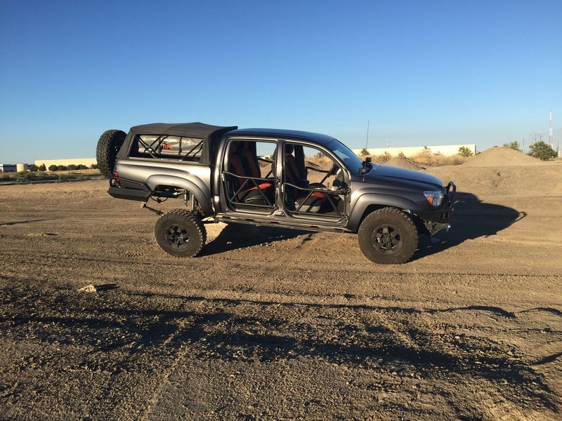

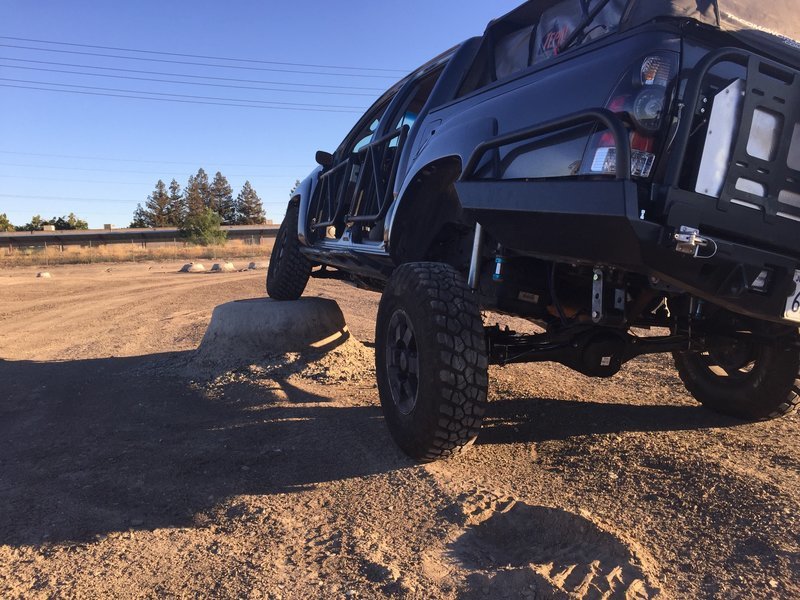

    Finally got this done. It's only been a yr since I bought everything. Really impressed with the ride. The flex is ridiculous. I couldn't find a spot to fully flex it out. Shock still had more to go.
    Thanks for this write up. It did help with the install. I can't wait to get out and see how it does on the trail.

    I love the tube doors

    Thanks. I like them a lot.

    Build yourself?

    No, I wish. 4x innovations made these. They made some awesome bends that make the doors look so good.

    Nice what size shocks?

    Thanks. 2.0 12"
